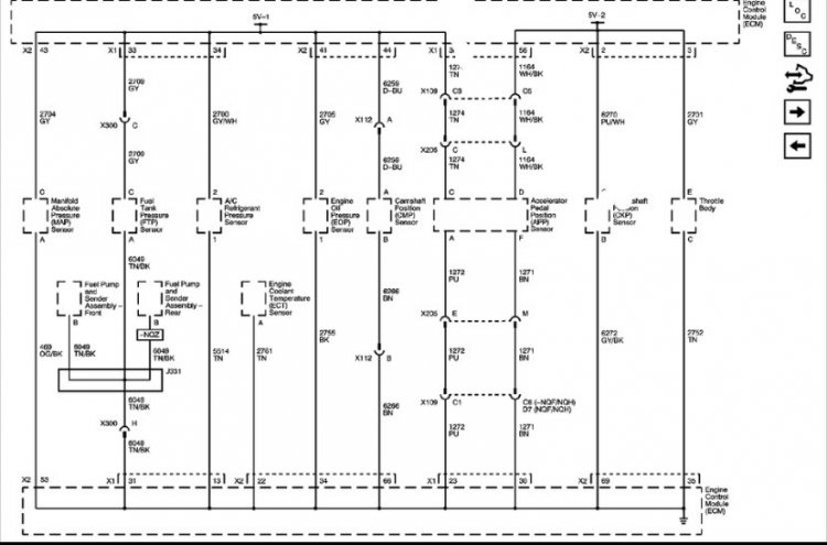

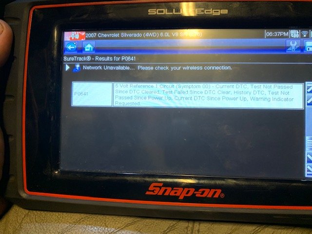

  3. When I did the AFM & DOD hardware ware delete, I sent my ECM to Texas Speed for tuning. When I installed the computer, and after starting the truck it ran fine, but the dash was showing engine reduce power, traction and stability control off, service power system, and service a/c system. After looking everything over, I did realize that I forgot the main ground coming from the battery that mounts to the cylinder head, (WTF moment). After several attempts I could not get the truck to start. It would turn over but would not start. A good friend of mine is a CAT mechanic and he brought over his scanner and it pulled codes: p0102 (MAF), p0107 (MAP- New sensor), p03040 (CMP - New sensor), p0452 (FTP), p0522 (EOP - New Sensor, no filter), p0532 (a/c), & p0641 ( 5 Volt Ref 1 Circuit). He cleared the codes and then the truck would start. Idles beautifully. But the dash was still showing the same messages, and the codes reappeared. I sent the computer back to Texas Speed. He looked it over and said the bench test and tune was good. He said he disabled the VATS and put the computer in a similar truck and the ECU wouldn't do anything. The ignition would turn on, but the starter wouldn't even turn over. He mentioned that it could still be the VATS that is not letting truck turn over. He had another guy look at it and bench test it, he even said he thinks my ECU is good. I asked him to check the volt reference, not sure if he is or is going to. He is now planning on ordering me a refurb ecu, flashing and tuning it and then sending back to me. My truck has been put back together and ready for about 2-3 weeks now. I have traced my harnesses, and checked my plugs. I have not had any indications of broken, smashed wires or broken plugs. No blown fuses. Is it possible that I may have bricked or damage my ECM by not having the main ground connected? There is also a ground wire that connects from the battery to the firewall, and the ecm is ground thru the cab. right? Trying to get some ideas of what my problem is before I haul this in to my local Chevy Dealership.

  5. Yes. It is the 5volt reference. That’s why I’m having to send my ECU back to Texas Speed to check and see what’s up. May be a bad computer. After hooking up a good scanner, we was able to see the issue.

  7. Oil sensor is new, and pig tail is in good shape. Based off the computer (see my 3 screen shots of the Snap On Scanner above) the issue is with the ECU. All of the sensors on the 5 volt reference/ circuit is not getting the 5 volts. Therefore the ECU has the truck in limp mode. I did have a ground not on the passenger side block (main ground from battery) first time I tried starting the truck. Texas Speed hinted that I may could have messed up the computer. I honestly don't see how, but would not be surprised, its electronics... The sensors and codes was popping up when I first turned the key on. I am hoping its just a tuning error and I wont have to replace the ECU. I shipped back my ECU yesterday to Texas Speed. I will be leaving town till the 26th. Should have it by back when I return and will update post an update on what I find. I hope this will help someone else in the future that may encounter this hurdle. As far as the AFM/ DOD delete. This is the very first time that I have worked on or rebuilt a this much of an engine. I was extremely nervous. I have about 20-24 hrs in the delete. But, now that I have done it. I will say that if you have the tools, a shop or barn, patience and the time, anybody with just basic mechanical experience and knowledge can do this hardware delete. In all, I will have approx. $1600 in this delete, which includes the hardware, tune, new oil, map, & camshaft sensor, and a couple tools that I did not have. My mechanic wanted $967 to replace one AFM lifter, after he replace all the lifters back in June for $2500. Which brings me to my next topic. DO NOT USE A MECHANIC THAT WILL NOT WARRANTY HIS LABOR AND PARTS FOR ATLEAST A YEAR, AND GET IT IN WRITING!!! This mechanic told me back in June that the work was good for 12 months. When I had a lifter fail, he was only offering to cover $50 for the lifter and $100 on his labor, after saying his warranty was for 90 days. Then tried to say I left his shop with 0 oil psi. Which was a lie. My psi was always 7-10psi warm idling, and around 20-25 driving. There is no way I could have gone 5 months with no oil psi, much less 5 miles down the road. If I had no oil pressure at that time, a good mechanic would have advised a new oil pump, which I would have done. So lesson learned. I will not use a mechanic if he doesn't back his work in writing. Anything other is hearsay. One last advice, if the AFM or DOD fails, DO THE AFM DELETE!!! Rid the motor of it!! Don't waste your money on the OEM parts and labor to replace the lifters! Delete it all!!! 2018 has been expensive! Jan $1200 for a rear main seal (bad oil leak) Jun $2500 for oem afm repair (because I am an idiot) Dec $1600 for AFM delete (did the work myself) $5300!!
  8. Thank you all for responding. A real good friend of mine is a mechanic for CAT and I was able to get him to bring his Snap On reader over. We now have the truck running and stay will running. Only issue is the computer is not sending out the 5 volts to the sensors (reference). The truck will idle smoothly, everything sounds great. But the dash is showing no oil pressure, traction stability disabled, a/c disabled, and engine reduce power. I went to check my MAP sensor yesterday and it was brittle and cracked, went ahead and replaced that. Oil pressure sensor is brand new (2nd one). Cam shaft sensor is brand new. Took some pictures of the codes. I am sending the ECU & TCU back to Texas Speed. I did have a ground that I missed the first time I tried starting the truck. Texas Speed hinted that its possible that I may have messed up the computer?? My buddy said that's a first to hear that. Any suggestions???
