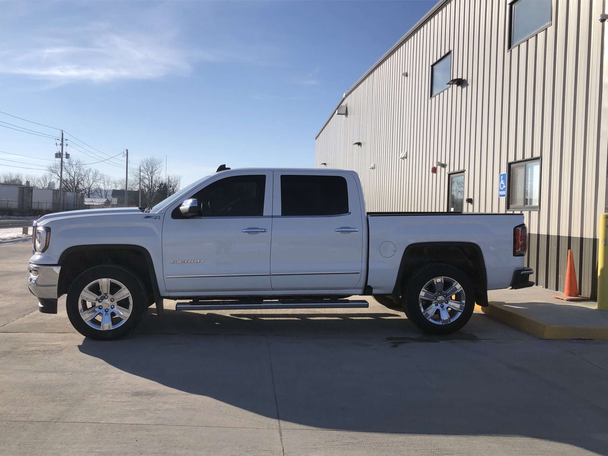

  8. That’s crazy rake. We installed a 2” front lift on a work truck that was 3” rake from the factory. For some reason that truck was a pain in the ass to install front blocks. Took maybe 1.5 hours. My truck took 25 minutes to do the front blocks.

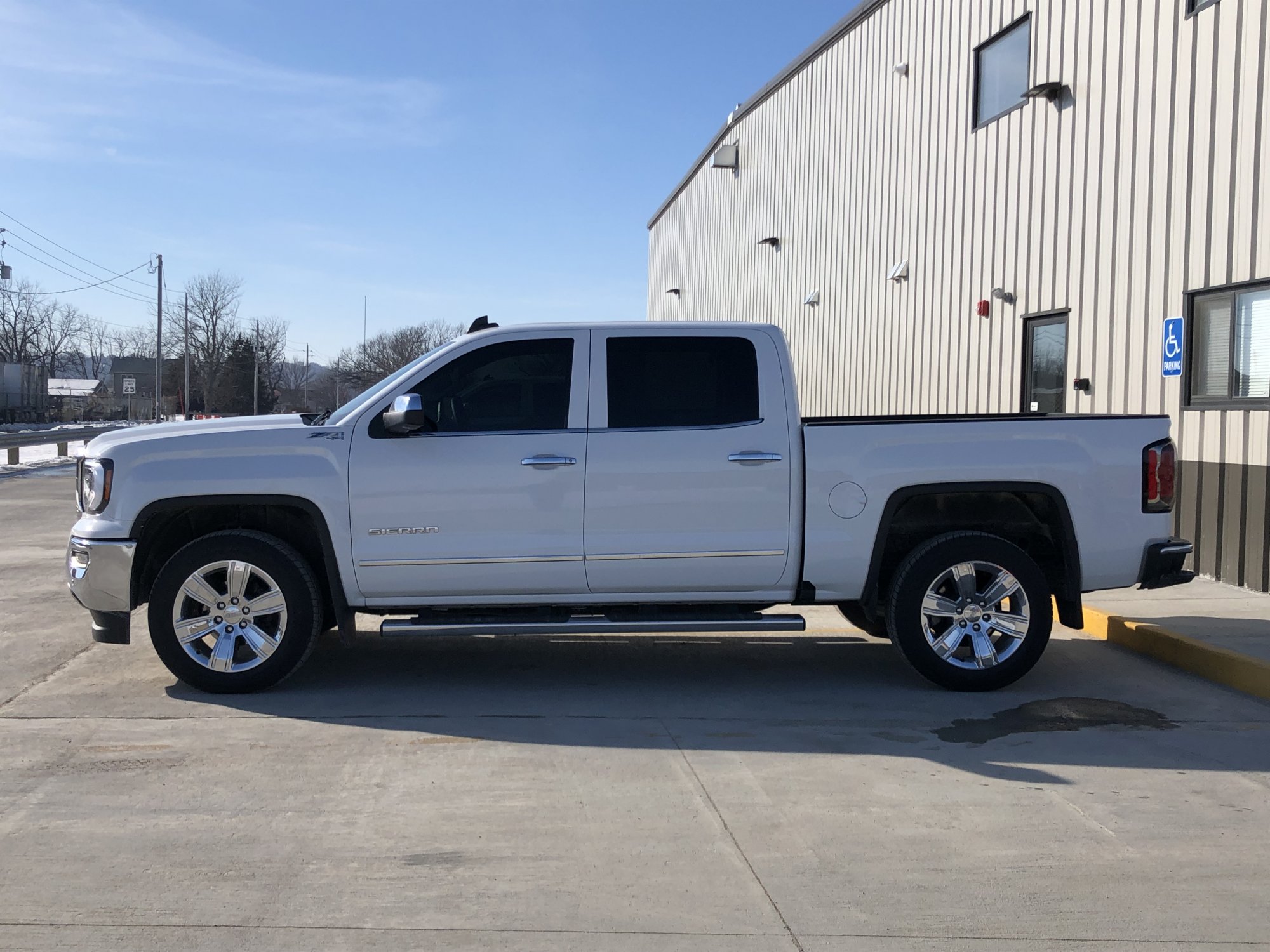

  9. Before after 1.5” motofab block in the front. Thinking about Nitto Grappler 33/11.5/20 for tires.
  10. Before After Installed 1.5” front lift today. Leaves truck with 3/4”-1” rake. Damn GM lean.
