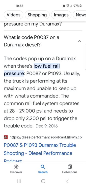

  3. Not sure what your asking? Your question is veige. It was a common error code for loss of pressure in Fuel rail line. Attached is the skinny on it.
