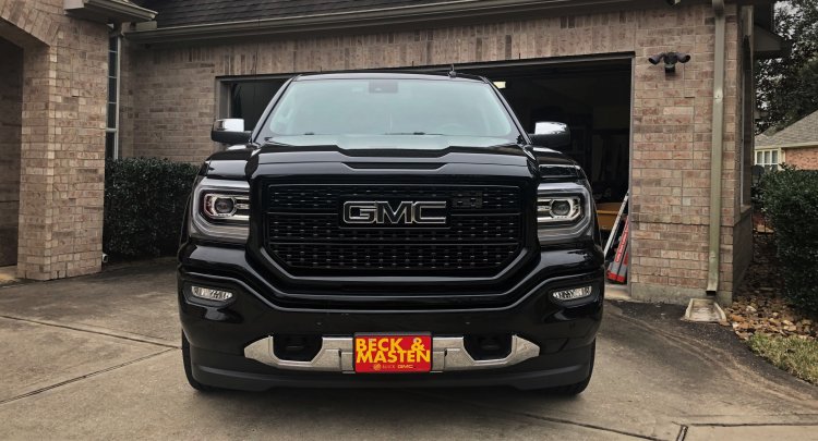

  1. So, I am new to GMC trucks (having had Fords since I can remember - boy am I so glad I made the change!) Loving my 2018 Sierra Denali but looking to lift/level the front and I purchased the Rough Country 2.5/1 leveling kit (3512). This is for the stamped steel arms which I have, however it doesn't have the hardware for modifying the Magneride bracket that connects the transducer to the UCA. Rough Country doesn't seem to have the Denali stamped steel arm/magneride solution in stock, nor does it seem to have had it for quite a while. Couple of questions... 1. If I purchase the 2" front leveling kit for 14-18 Denali (3511) does it include the necessary hardware that I am missing? (I think it does, and yeah I know... a lot of money for a few bolts, but its the spacers I am more concerned about and interested in). 2. Does anyone know if I can get these parts separately and if so from where? 3. Assuming that other than the Magneride components, all else between the stamped steel arm 1500 and the stamped steel arm Denali in regard to this lift should be the same, yes? Appreciate any help on this topic.
