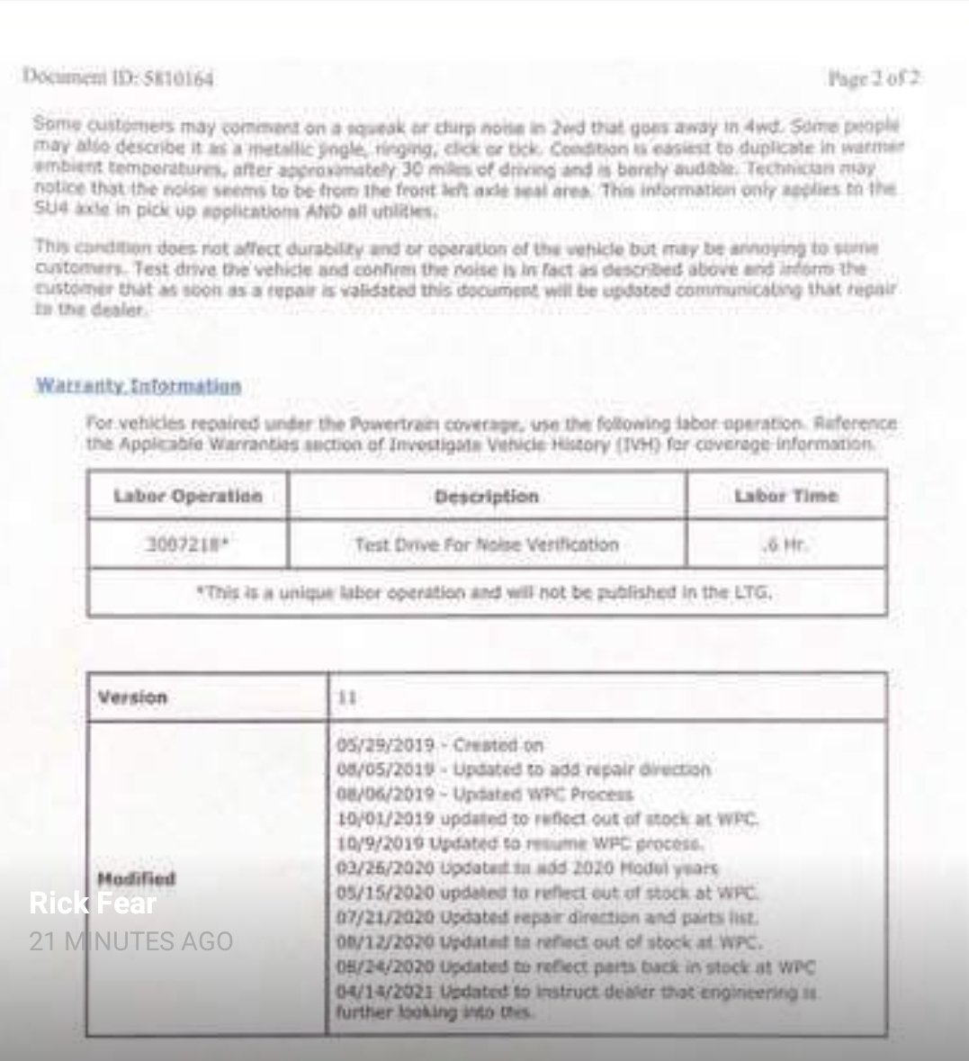

  3. Supposedly PIP5653K is out and engineering is looking into this again. Sorry for the quality but someone shared this with me on Facebook.

  5. Well the thing is that there is no permanent fix for a majority of the people. I love the truck in every other way, no other issues have come up besides my parking sensors acting a little wonky sometimes. I just don't have faith that a permanent fix is out there based on what I have read so far, both here and on Facebook. I would much rather not trade the truck since I already fixed it up the way I like. Nothing too major but I have done muffler, exhaust tips powder coated, black and red emblems, vinyl wrapped some of the interior, Amp power step running board, etc etc and it is gonna be a pain to start all over again. Guess I will see what happens when I take it in on Monday and go from there.
  6. Well surprise surprise (sarcasm), the dealer replaced the drivers side front wheel bearing and seals and what not on Friday and of course that did not fix the noise. I have another appointment set up for Monday. I was able to get better audio, I think partly because the noise seems to be getting louder! I'm going to make sure I specifically mention this PIP bulletin or whatever to point these boneheads in the right direction. https://www.carcomplaints.com/GMC/Sierra_1500/2019/tsbs/tsb-pip5653j.shtml. My first Chevy and First truck was a 2019 Silverado 5.3L 8-speed LT truck, I traded it to transmission issues because the dealer said it was normal and I didn't feel like hassling with them anymore (also the fact I got what I paid for it after driving it a year). The only good thing is that supposedly the truck is worth 52K and I paid 48K and I owe 42K, so already thinking it may be less hassle to just trade this darn thing away. What do you think?
