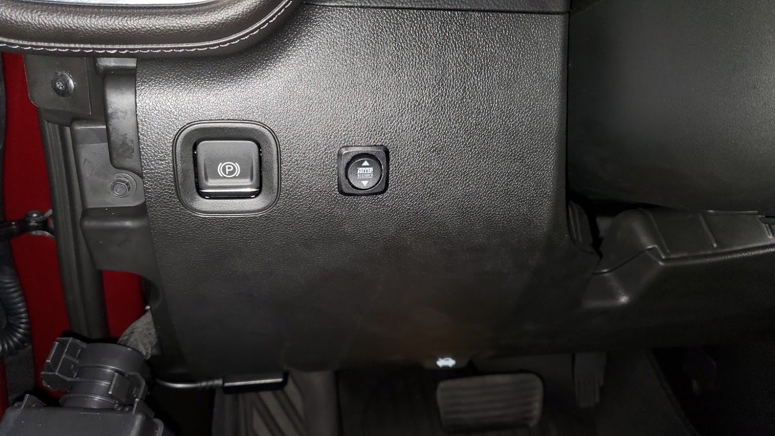

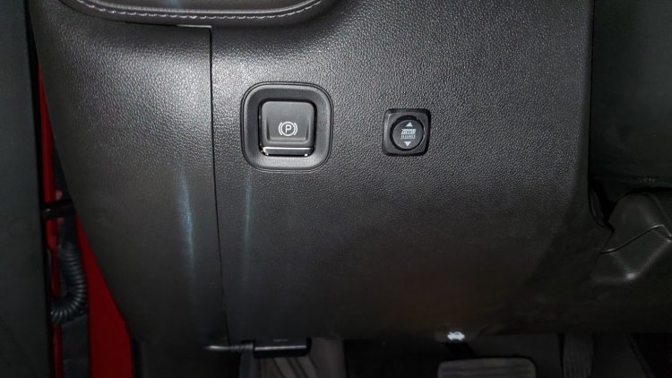

Follow up to my other reply. I think you may have been asking about the knee bolster panel, under the steering wheel. That would make a little more sense since it is a PITA to remove. I did not remove that panel. I installed the switch with the panel attached. Enough clearance to easily run the wire and put the locking nut behind the switch. Have a look before drilling because if you go too far towards the parking switch a piece of plastic or something would obstruct the locking nut a bit. -

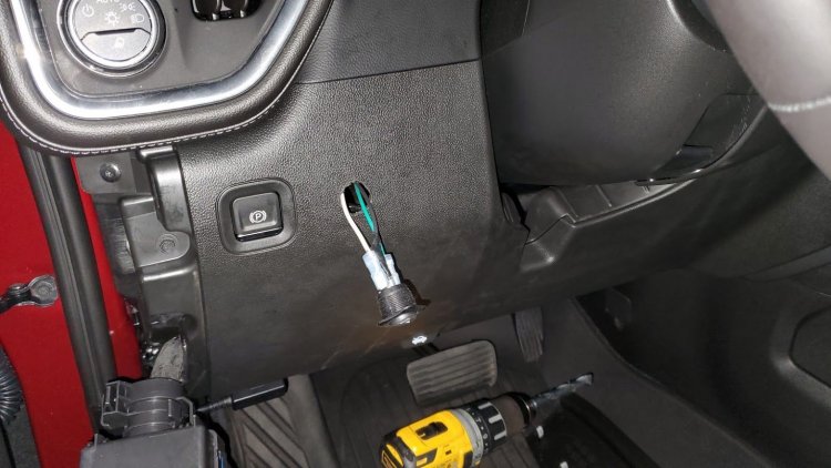

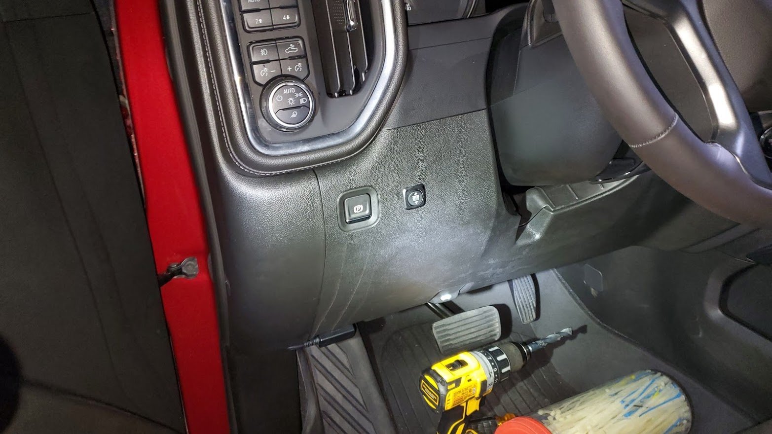

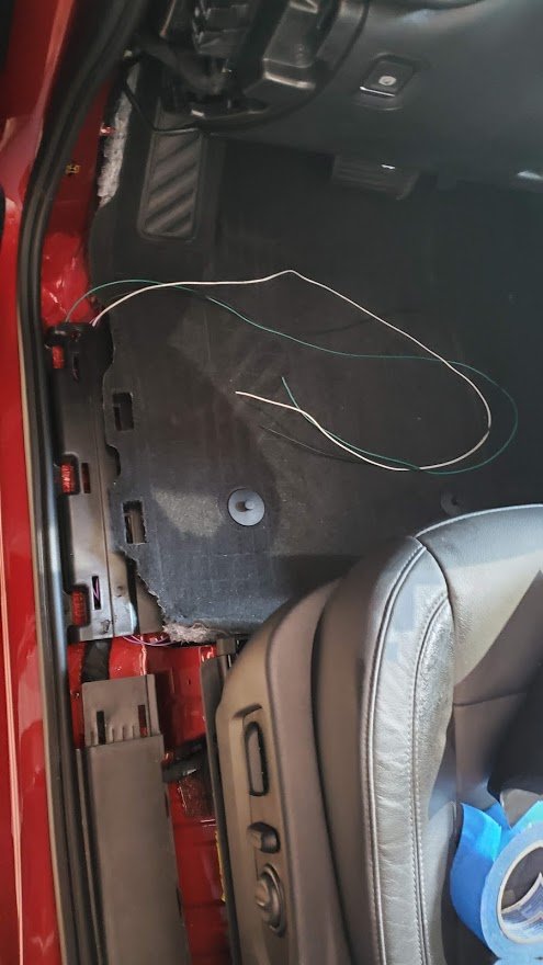

The part number is AMP-79106-01A, I ordered from truckandgear.com because that is where I bought my steps. Ran about $30 + $10 shipping (ordered separately from steps). Probably can find it a few bucks cheaper. Comes with the switch, wiring, and instructions. I routed my wires through the rubber grommet under the drivers side carpet. Had to remove the kick panel to pull back the carpet and run through the channel under the door will cover. The kick panel and door sill cover is actually just one piece that easily pops out. Picture for reference. -
What Have You Done With Your T1 Today ?????
Philipgonzales3 replied to Sierra Dan's topic in Modifications, Wheels & Tires
installed the Amp Research manual override switch for the Power Steps. I think it came out pretty good. Called for a 3/4" drill bit and biggest I have is 1/2" so I made it work lol. -

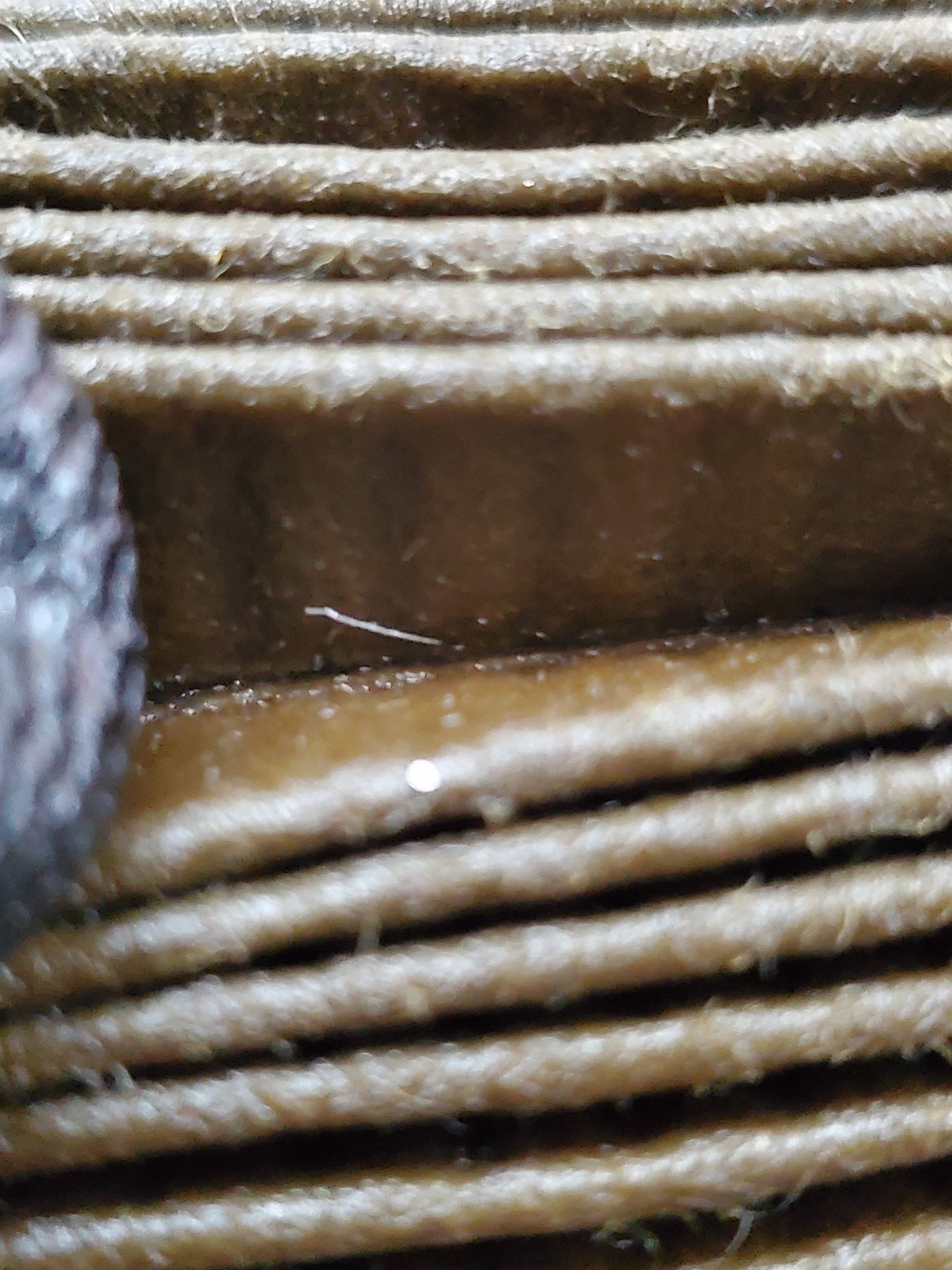

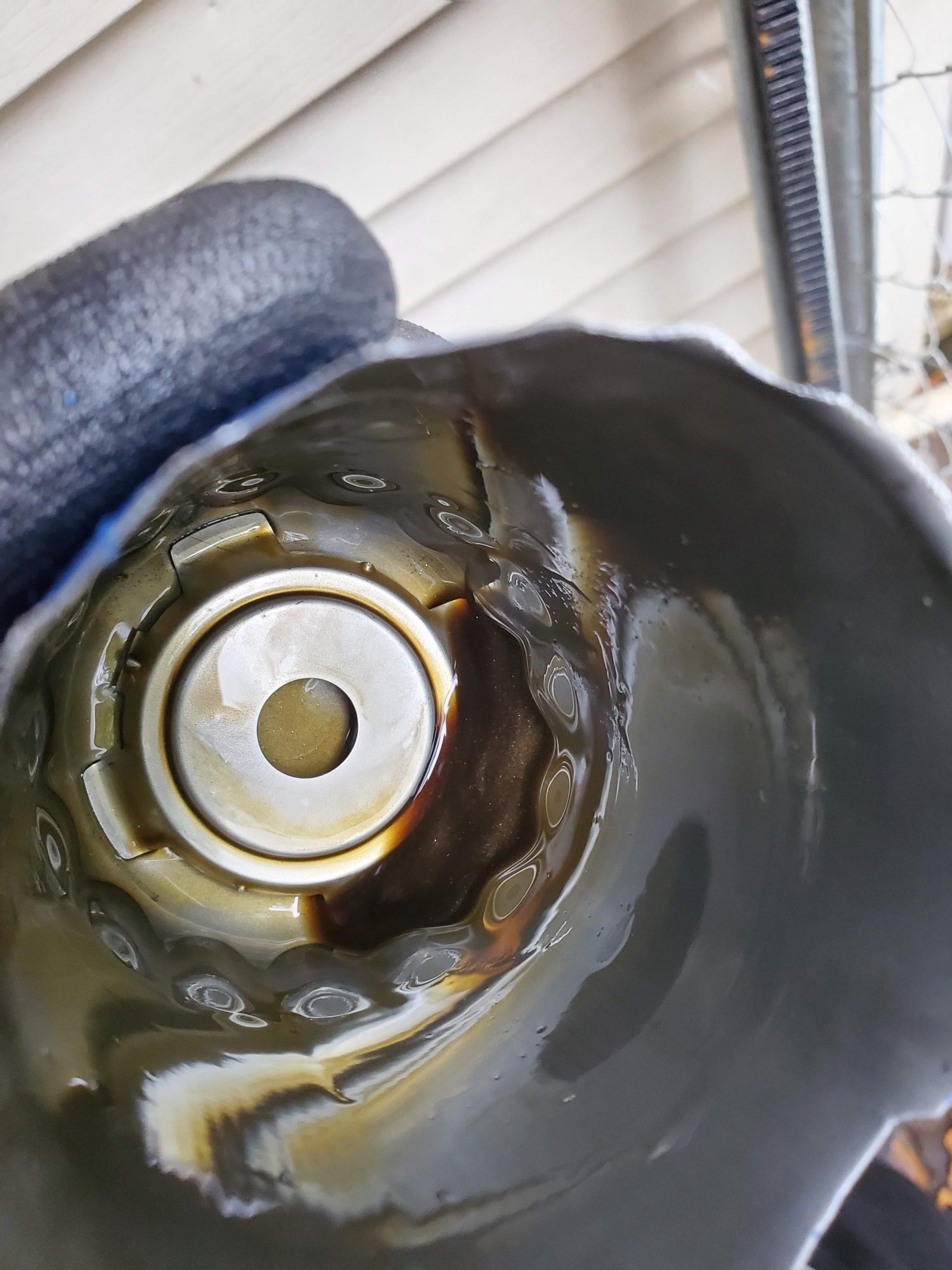

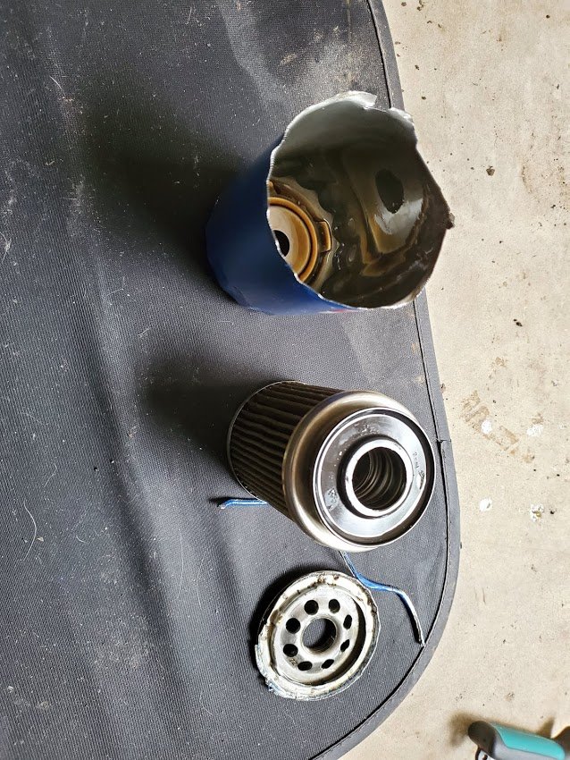

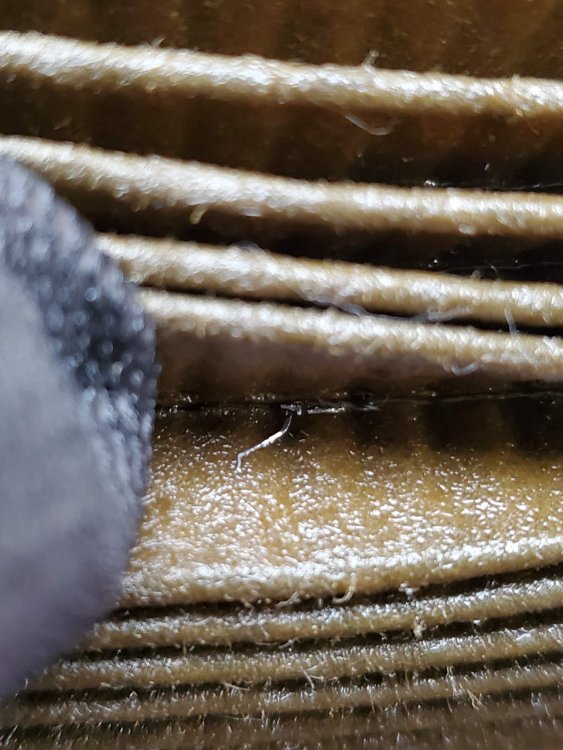

Cut open my old oil filter that was removed from my new 2020 RST at 1300 miles. Couple slithers of metal and lots of little specs here and there. -
