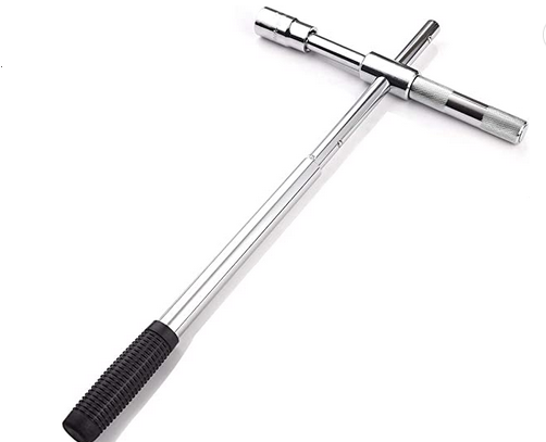

  14. I checked the tire pressure as they said on paper work, they put in 30 pounds, should be 35. It was really 35, just poor paper work. Also, said torque foot pounds 140 which I think is right, but think they are more? Can't loosen with my 4 way lug wrench, but have another in truck with long handle so I can get more pressure. I work out at gym, can lift 145 pounds without much difficulty. Should have stayed with my old tire guy. Yea, my special tire wrench that I put 2 handles together to make a 243inch handle breaks them loose. Got it off Amazon
