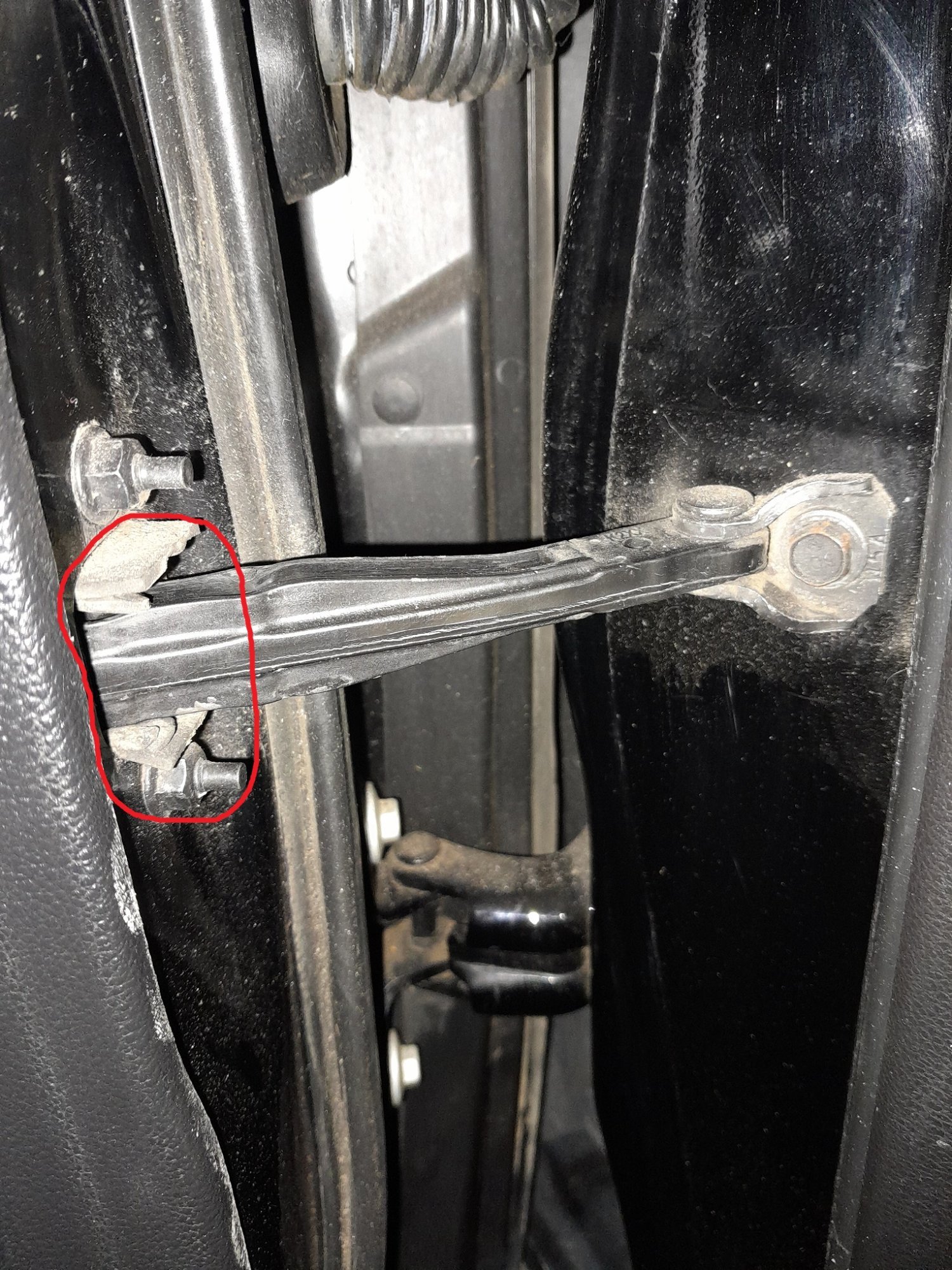

Well I got new door check in and installed and picked up 5 pieces of trash rolling around in door that was driving me nuts. Really the stuff rolling around is the only reason I put new door check on. All back together and took off and still stuff rolling around in door!! Take things apart again and there were 3 little ball bearings in there found with magnet. Now all is quite, nothing rolling around. -

Thanks for the information, door check, that is a good name. Mostly likely it did it's job even though it broke. Gave me a moment to catch it myself. It was kind of hard to close, and that was most likely when door check part got pushed in. Nothing looks bent on door and open and closes fine. I use to have a tool like this, but long time since I used it, hard to tell where it went. EDIT Found it, now if I remember got to get that c clamp turned just right so the tool pushes just the right spot to spread it apart. Then to put back on just slide c clamp on handle and push on. Hopefully tool right size? -
Well I did a dumb ass thing. It was really windy today and as I got out of truck a real hard blast of wind came up and blew the door open and something broke. Not sure what you call it, but circled it in red. It is flopping around where it goes into the door unlike the other side. What broke off, fell inside of the door panel. Door works fine, opening and closing. What bugs me most is what ever broke off is in the door panel and rolls around when you brake or accelerate. Drives you nuts after awhile. Any instructions how to get the panel off this work truck? Seen some for panels without a manual window handle, think I need a special tool to get a clip off that handle? About got it off except for that handle, so put all back together and just listen to whatever it is roll around. Also when I took the piece in blue off there was not a 7MM bold as one video I found and that piece did not look the same inside or outside as the video I found. I tried to do pictures to show what I got. Maybe I should just take to a shop, would this be a mechanic or body shop? I getting too old to mess with this! That & in picture is suppose to be a 7, also can't type it seems.

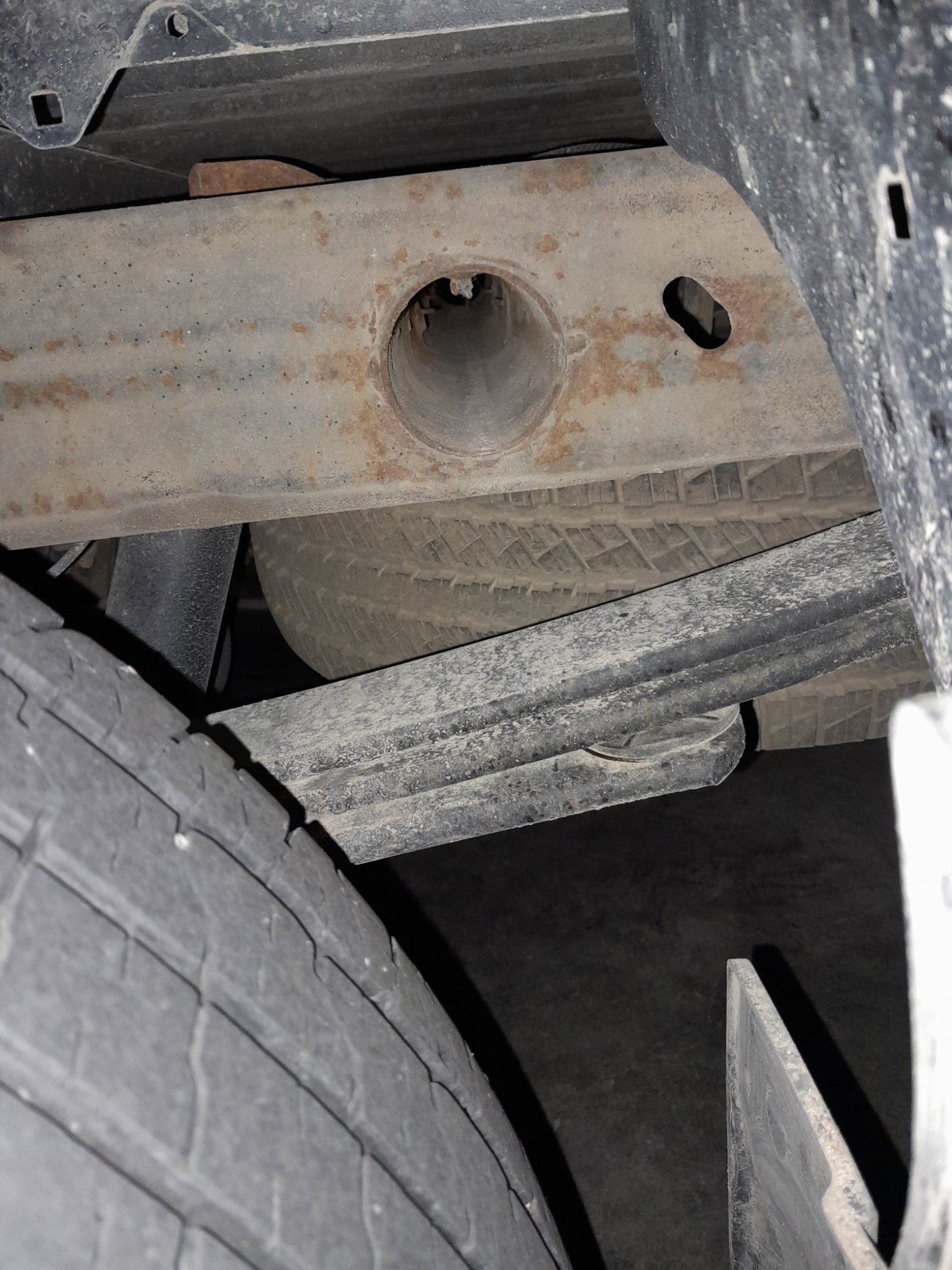

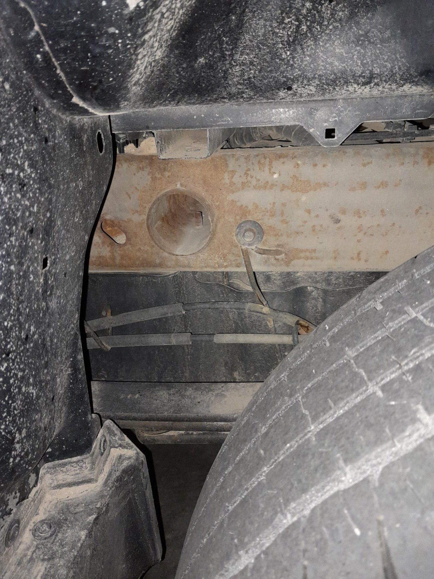

Well it's looking good now, I found some rubber plugs at hardware store, that fit, but then came out pretty easy. So I got some 100 percent silicon for indoor/outdoor and put on lip that will stick to sheet metal. There was still one original plug, I posted a couple pictures below, it has a small grove you can't see very well that held in place by sheet metal its a small cut in grove around plug. Picture don't show well.
