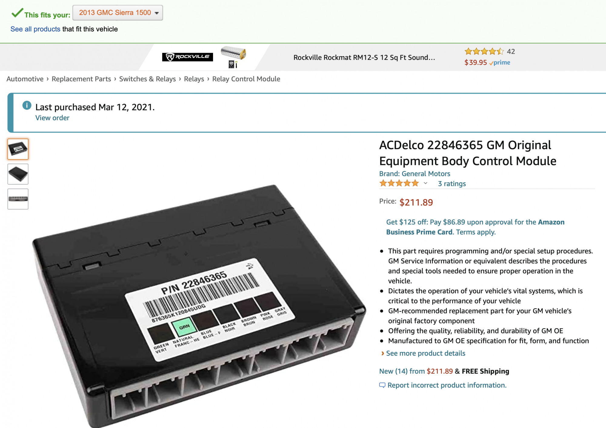

  17. I mentioned all my other electrical problems to a friend tat is pretty sharp on GM trucks. These are other issues I am having right now: 1. Cannot set clock on radio. Other radio buttons don't work such as some favorites buttons. 2. Driver's door does not turn on courtesy light, radio plays for 20 minutes after exiting. 3. Cannot get one of my parking assist sensors to work, brand new. Service parking assist displays on dash and I have to scroll out of it every time I drive the truck. 4. Driver's window does not work part time. 5. Oil pressure gauge stopped working. 6. Truck misses and runs poorly after warmed up, then parked for 10 minutes, and re-started. Any way, he said it sounds like a bad body control module.. Could this be causing that issue? I will try swapping the two rear 02 Sensors. I have a brand new OEM Body Control Module to install, but have not put it in yet.

  20. Can someone tell me where the BCM model is located on my truck? And, does this look like the right module?
