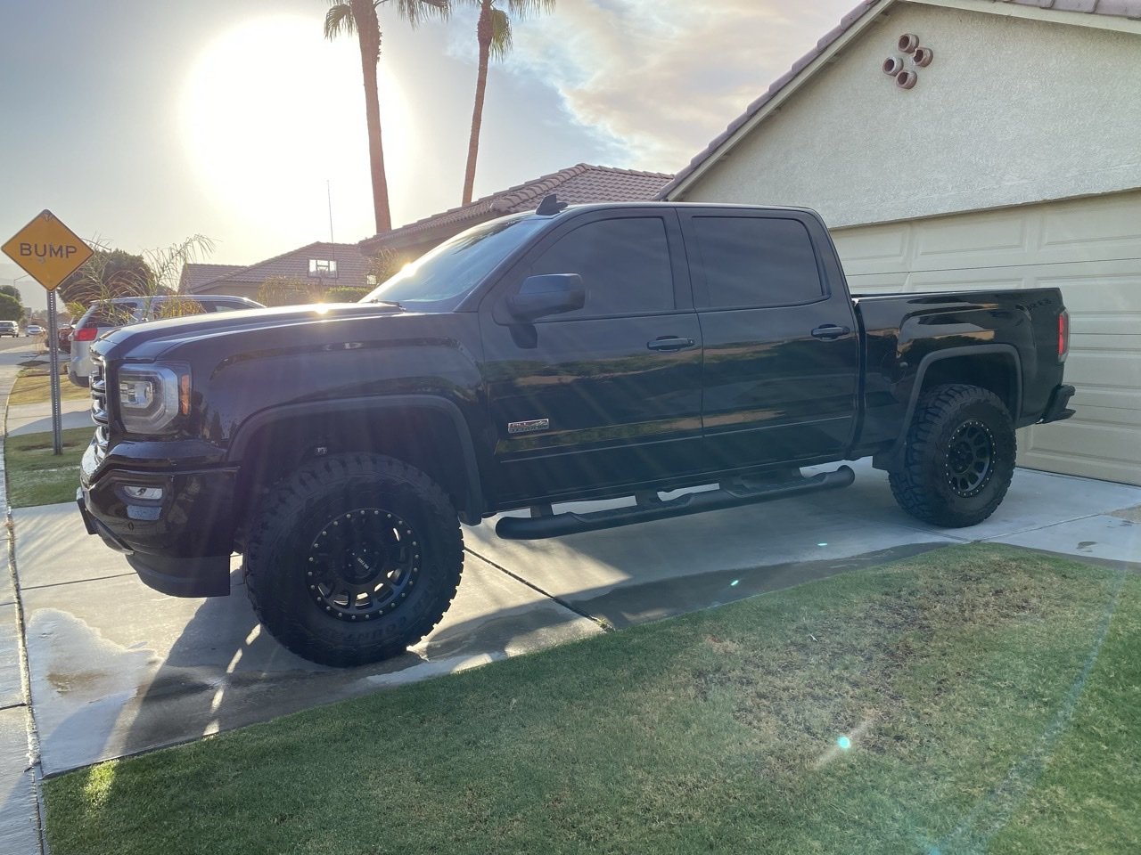

  2. My 2018 Sierra has a 2.5 inch level and I’m running 315/70/r17 (metric size of 35/12.5) with very and I mean very little rub on the felt liner on the back side of the wheel well.
  3. After months of posting and asking for suggestions my build has almost come to an end: here is my 2018 GMC Sierra All Terrain Specs: Fox 2.0 coilover adjusted half an inch, 2 inch spacer on top Toyo RT 315/70/r17 Method nv305 wheels

  5. Beautiful truck! Love the Centennial blue with the black Sludges. What’s your wheel and tire size?

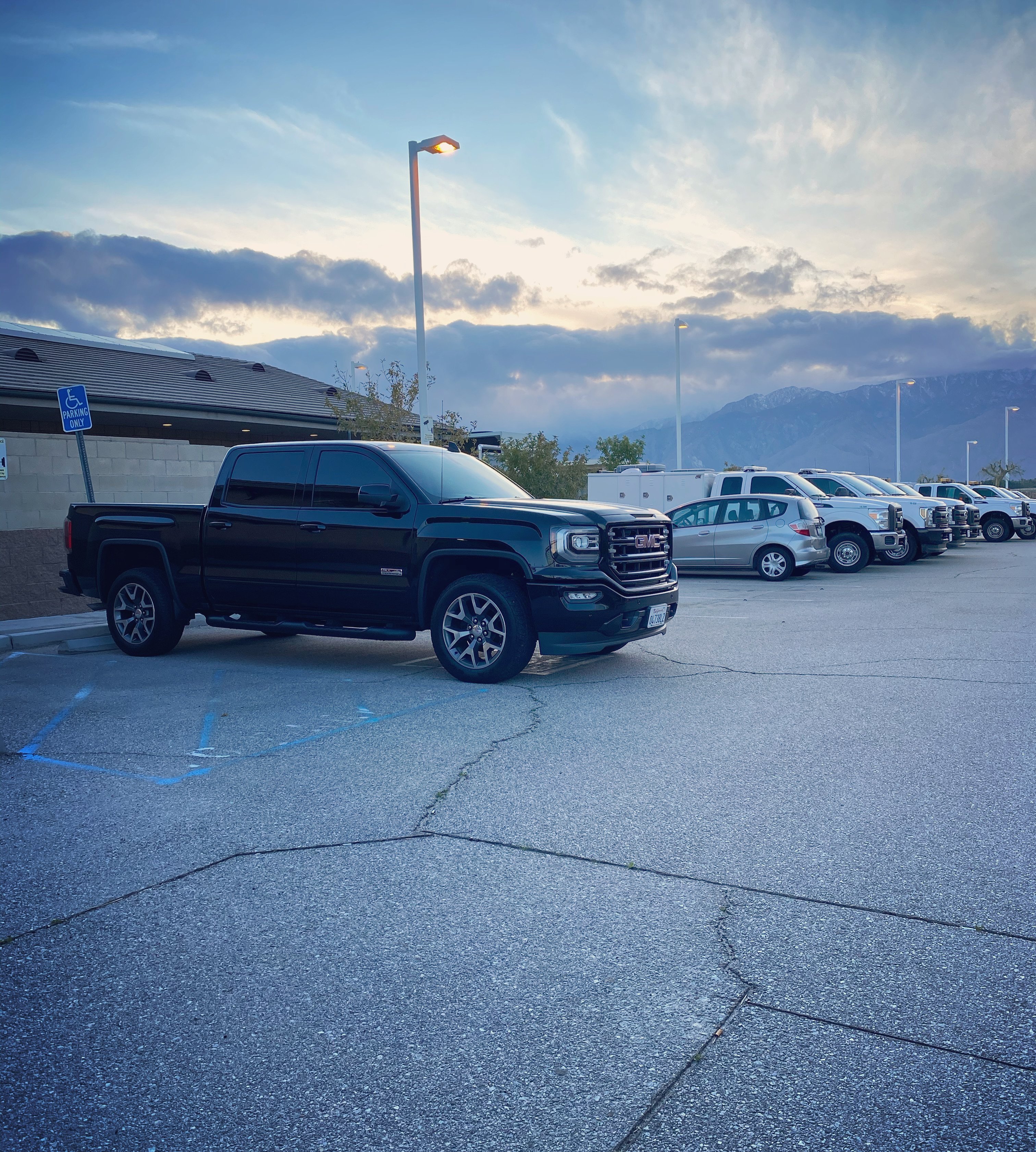

  10. Hey guys, so I purchased Fox 2.0 Coilovers for my 2018 GMC Sierra 1500. I wanted to get some recommendations. Now before I ask, I have to clarify my truck is a 2018 I know some may people comment because of 2014-2016 trucks but as far as I know there’s a slight difference between 2014-2016 and 2017-2018 1500’s. My whole goal is to get a perfectly level truck. No rake, no squat. Perfect level. I called Fox but they weren’t that helpful. The gentleman stated the Coilovers are pre set to give a 2” level out of the box. However in forums I’ve read the Coilovers come the same setting as a stock Rancho strut but are adjustable to gain you 2”. Now I’d like to know if that’s the case if they are stock size would it be best to crank it up to get the 2” level or would it be best to keep it at the stock setting and then add a small spacer on top of the Coilover. Not trying to go over 2.5”. I don’t want to replace my UCA’s anytime soon. Thanks guys! I can’t wait to add these bad boys!
