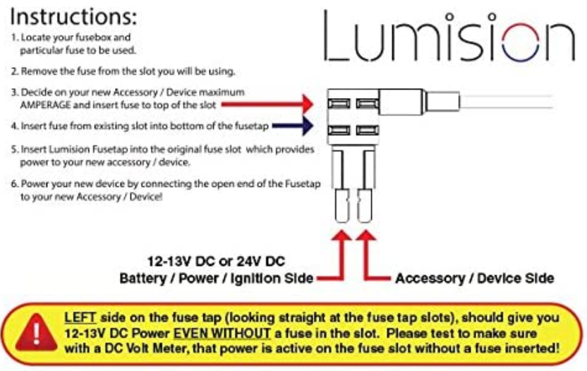

Turns out I was using the fuse tap incorrectly. For those that are trying to use the fuse taps from autozone from Eaton Bussmann, here are some instructions for how it works since their packaging doesn't say it (ignore Lumision): The pictures advertised only show one fuse in it so thats what I did. That was not correct. Once I actually probed on it, here is what I found: - The top right slot, closest to the wire, has continuity constantly with the wire. - The top left slot will only have continuity once you have a fuse inserted. - The top left and bottom left slots and the left blade have continuity constantly. - The bottom right slot and the right blade have continuity constantly.
Was able to verify that those in the left fuse block work as described (did not test if any of them go away after a while with the key off though) on my 2016 silverado....However, the camera is still not coming. So either my crimps are bad for the fuse taps or the little harness module is dead. I reached out to Rexing regarding it not working, waiting for them to respond. I will be probing the wires after the crimps to see if the crimps are good or not. If its good, then i'm guessing the harness was a dud out of the box or my camera doesnt like the harness for some reason. I did verify the camera works with the cigarette adapter, but I want to hide it away while not taking up my outlets in the truck, so hence the harness purchase. SO long story short: When using the left side fuse block between driver door and dash - fuse position 9 has constant power (has a 15A ATR style fuse (called Micro blade fuse)) - fuse position 31 has switched/ignition power (has a 10A ATR style fuse) Whether it can be used long term on a 2016 I cannot vouch for yet, but it works for @catpartsman in his 2015.
