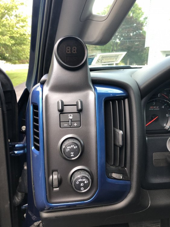

  5. It wasn't that bad to make. I bought a universal gauge pod and a new panel just in case I messed up. Molded it in with modeling clay to get my form then just fiberglassed over that. Bondoed, sanded smooth, primed and painted.
  6. Finished my boost gauge pod today, just need to run the wires thru the firewall

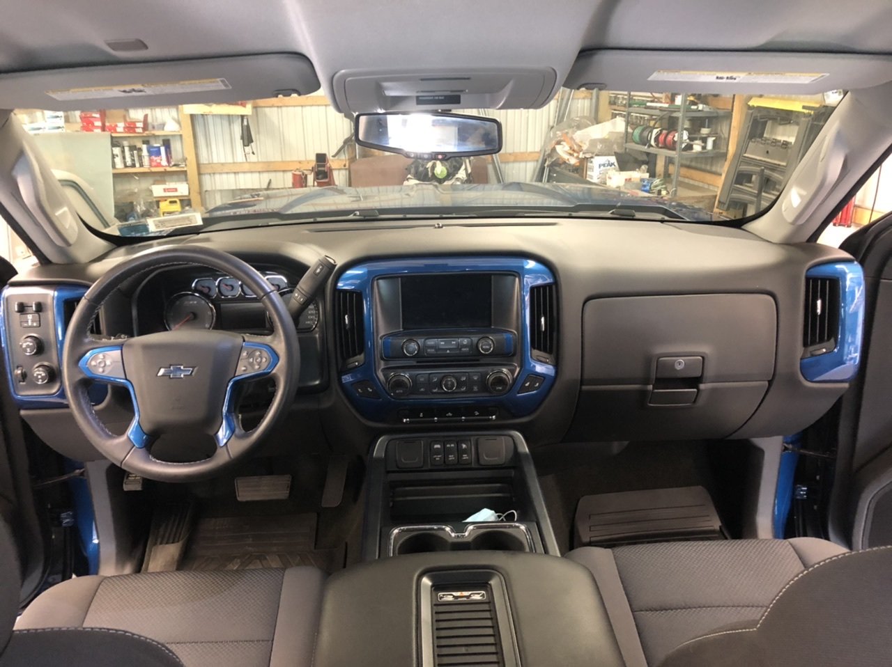

  7. Painted some interior pieces to match exterior
