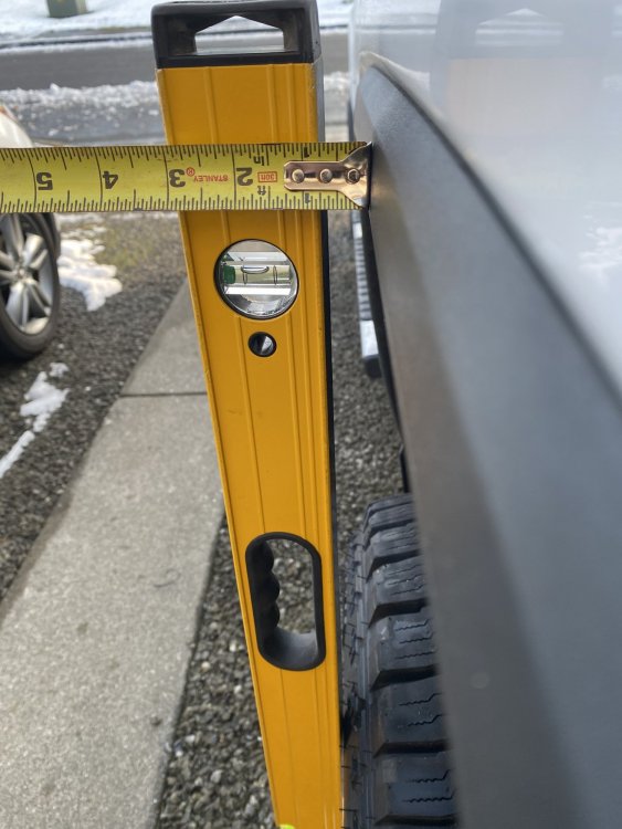

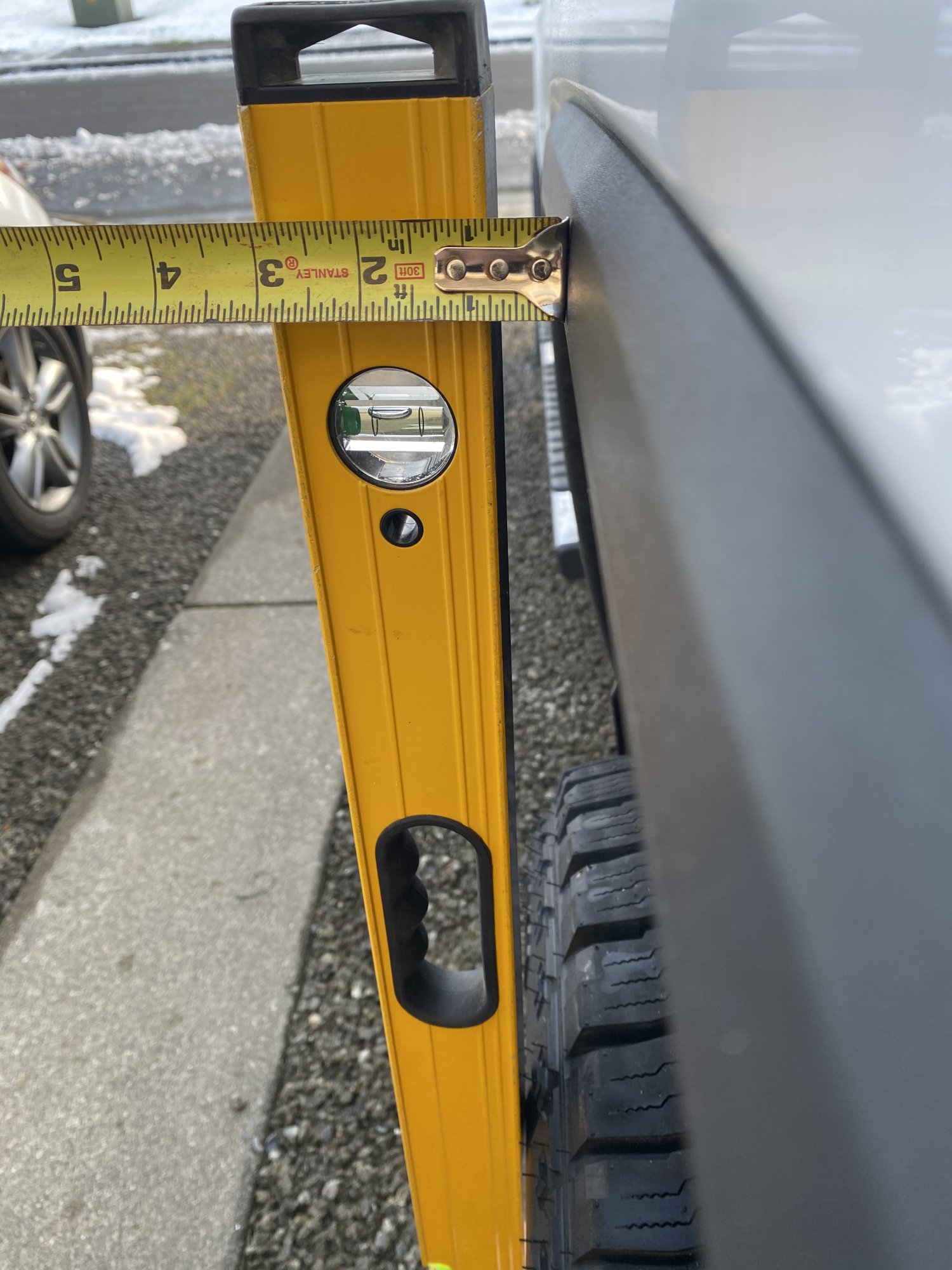

  5. Drivers side.

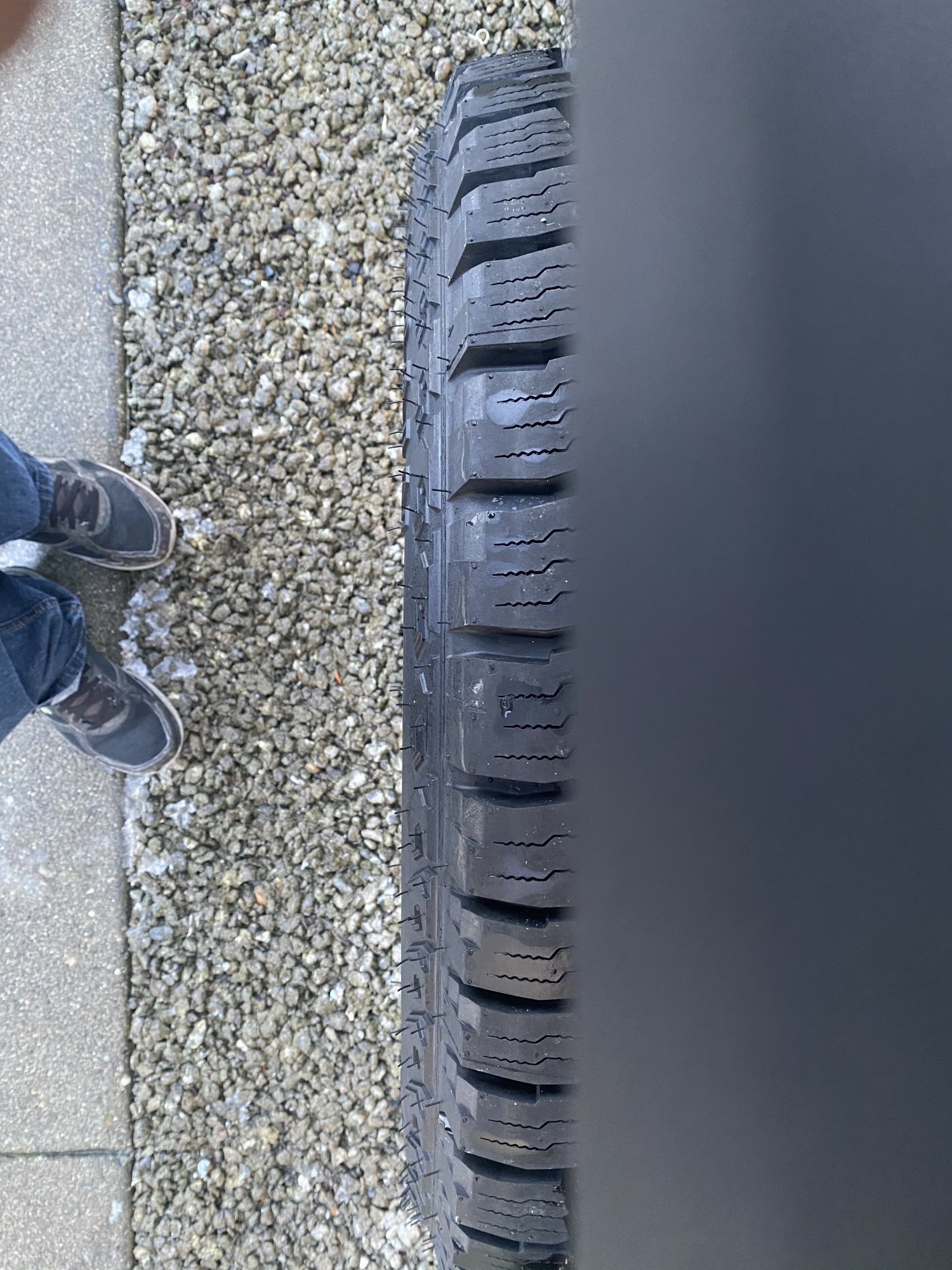

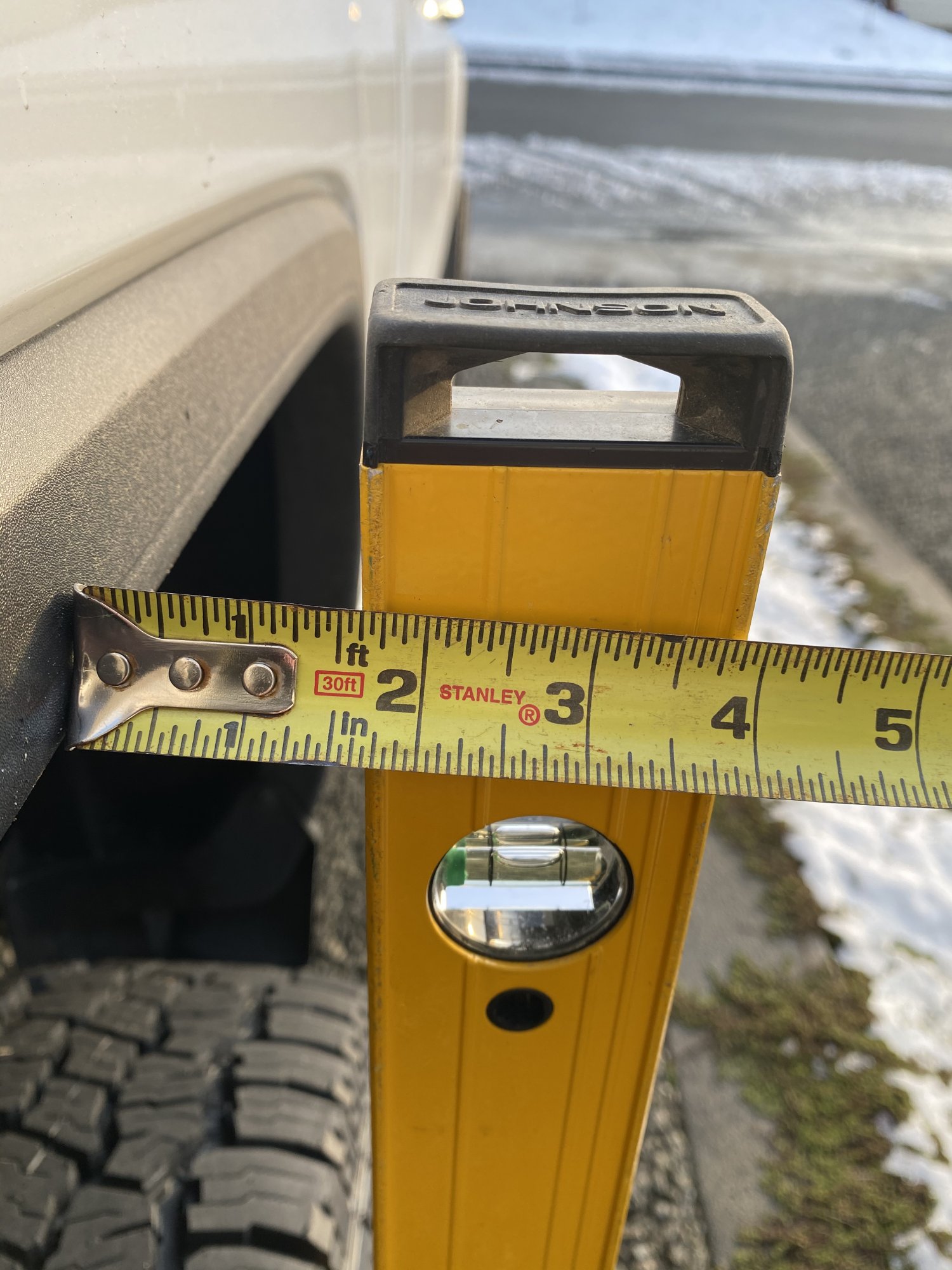

  6. A couple more pics shot looking down with camera held against side of truck above fender. passenger side
  7. Merry Christmas! So I just had new wheels and tires installed, they look awesome however I have discovered a discrepancy. The passenger side has about 3/4” more poke than the drivers. See pics of rear, the front is exactly the same. Before anyone says the bubble being out on drivers side, if I plumb the level. She is 1/4” to 3/8” off the wheel at the top and gives 3/8” more to the 3/4” the tape shows. I am wondering if any of you have had similar issues? Or know of this bing the norm? I never really noticed with the stock wheels but there would have been 3/4” difference. The drivers side is what I was hoping for less than 1” of poke, the passenger side at 1 1/2” is a bit much. Tires throw a lot of dirt, rock, etc.
