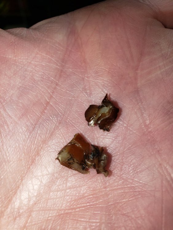

  1. Here it is in my hand, sort of a brown color. Where the plastic broke off it is white.
  2. It has been almost 90 days since my last post. Here is what I have done so far with the truck. I changed out the number one fouled plug. Added a AFM module delete that plugs into the OBD port. Changed the oil used Mobile Techron, also added a bottle of Techron fuel injector cleaner and bottle of Auto-Rx Plus. I have driven a little over four thousand miles. Check engine light is still on and it still drives the same as it always has. The one thing I need to mention is when I changed the oil I did find two or three small pieces of a hard plastic type material in the oil. I assume that is from the timing chain tensioner since those are made of that type of material.
