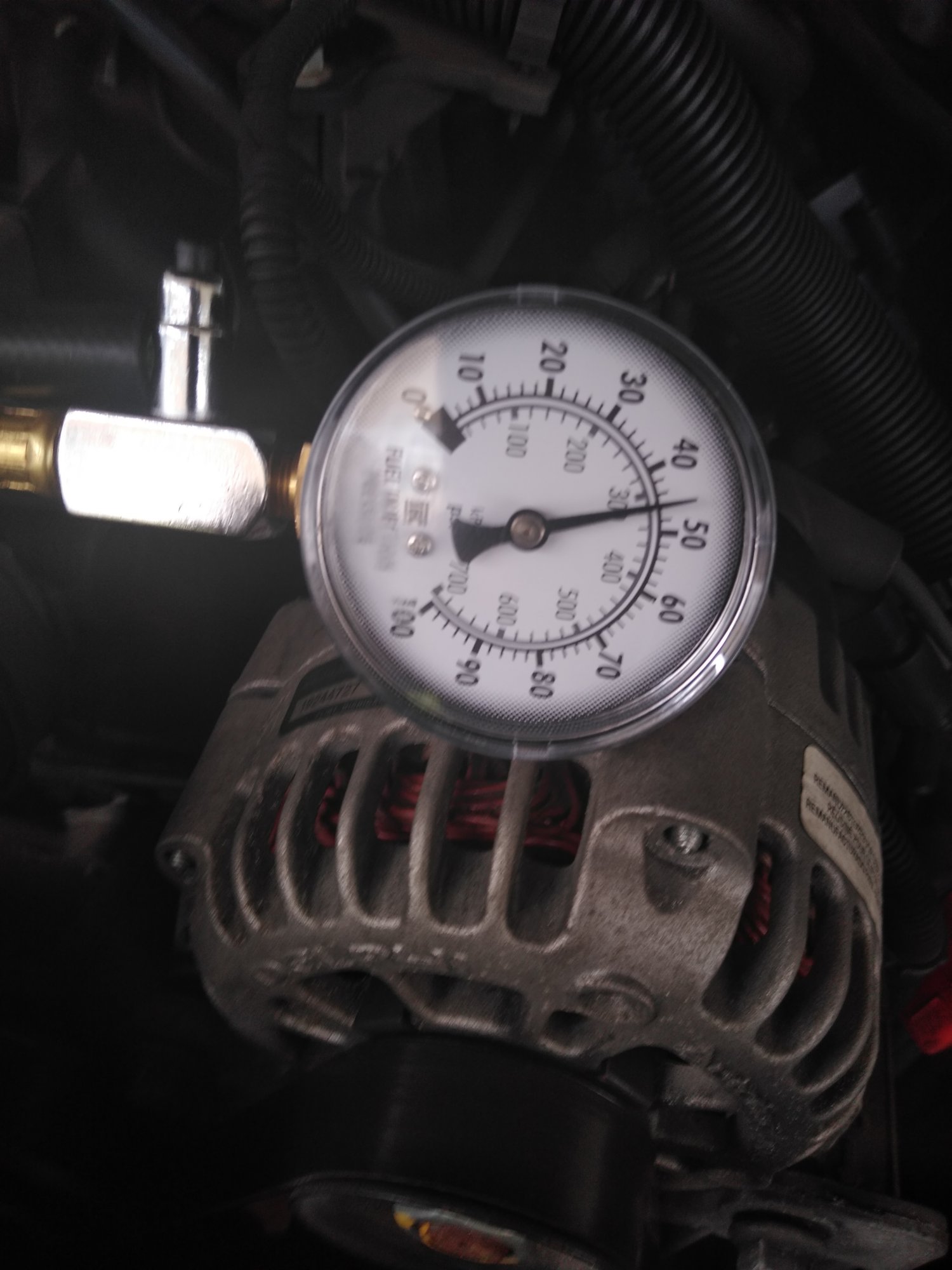

  11. No mine didn't do it all the time. It did it when it felt like doing it. That's what stumped me. I just hope it won't come back. If you haven't changed the plugs and wires lately I'd probably try that first. Plus it wouldn't hurt to at least check out the connections and make sure they're secure. I did the plugs and wires before I looked at the coils. Anyways have you any loss of power? Maybe you collapsed/bad catalytic converters? I'm testing mine tomorrow.
  12. I ran into a small issue as the Flowmaster Original 40 Series isn't available in a 3.00"center in/3.00"offset out like the Super 44 is. After comparing the sound of the two cans I pulled the trigger on the 40 Series anyways. I'm sure that since there will be over a foot of extra working space the offset on the inlet side won't create any issue. I found a nice little mom&pop exhaust shop down the road who will remove the factory can and replace it with the muffler I bought welded in place with my tip provided for $100. Not bad at all. Definitely looking forward to it. Tomorrow my infrared temp gun will be arriving so I can do a test on the cats with that to get a idea what's going on before I have it installed Monday. I realized the thread isn't exactly interesting *after* I already posted it. It'd be nice if there was a way for me to delete the thread but usually even on dumb threads like this, useful information is written that may help someone else on a similar quest. Flowmaster states in YouTube videos that the Super 44 is a louder muffler than the original 40 Series (not to be confused with the Super 40). But in their website they contradict this by providing a visual chart that puts the 40 Series above the 44 on the agressive factor. That's because the 40 Series has more interior resonance than the 44... and IMHO sounds meaner. I bet it's really gonna sound good when I put my speed engineering longtube headers on her oh yeah!
  13. So the 2003 Silverado has stock exhaust. I've had flowmaster in previous vehicles and like the sound. But I'm wondering what you guys think about the Original 40 Series compared to the Super 44. I can barely tell (actually can't tell at all) if my truck is running at idle without seeing the tach move. It's silent, rather sad TBH, this will change on Monday if I can pull the trigger on a muffler. I'm looking for very strong deep sound inside the cab even at idle. Not worried about neighbors as I live in the country. Not worried about drone either as my mullet abides. I'm keeping the cats in place. Any recommendations? Flowmaster says the 44's are louder but every video I see the old school 40s seem to rumble a lot more. Almost every cat back system Flowmaster makes has the Super 40 which is supposed to be quieter than the two I'm comparing.What's your opinion...what are you running?
  14. Yes, the P0300 and flashing CEL hasn't been back for 100 or so miles. I was thinking about having the back pressure tested before I do the exhaust system I was planning on this month. I'd hate to spend the money having it welded in only to have the cats be the culprit and have them do the work twice. I'm glad the CEL is gone, at least for now, though that's for sure. Any more ideas? I am noticing a spitting noise from one or two injectors on the passenger side.
  15. I'm getting 50 PSI this morning at idle and at 2k RPM it drops 4-5 pounds to 45 then quickly returns to 50-52 Lbs. At 3k RPM it does the same, same again at 3,500 RPM still hovers around 50 pounds. Back to idle it's at 50 PSI steady.
  16. I'll do as you instructed this morning and return here with the results. Thanks for the advice.
  17. Just got done testing for failing fuel pump. I'm getting between 48 and 50 lbs at the rail on my 4.8L, is this within normal parameters?
