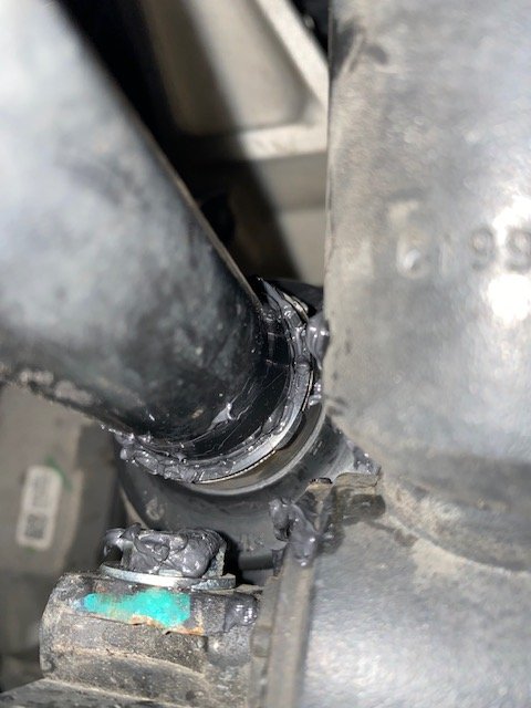

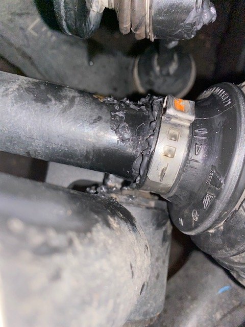

  10. I actually ended up changing the spacer out today to a 2” top Mount spacer. With the truck up on the lift and closer inspection it looks like at certain angles the pinch on the Clamp for the cv boot would rub the bottom of the strut mount with the 2.5” spaced down there. I know it’s only a half inch difference but the axles and ball joints look happier now.
