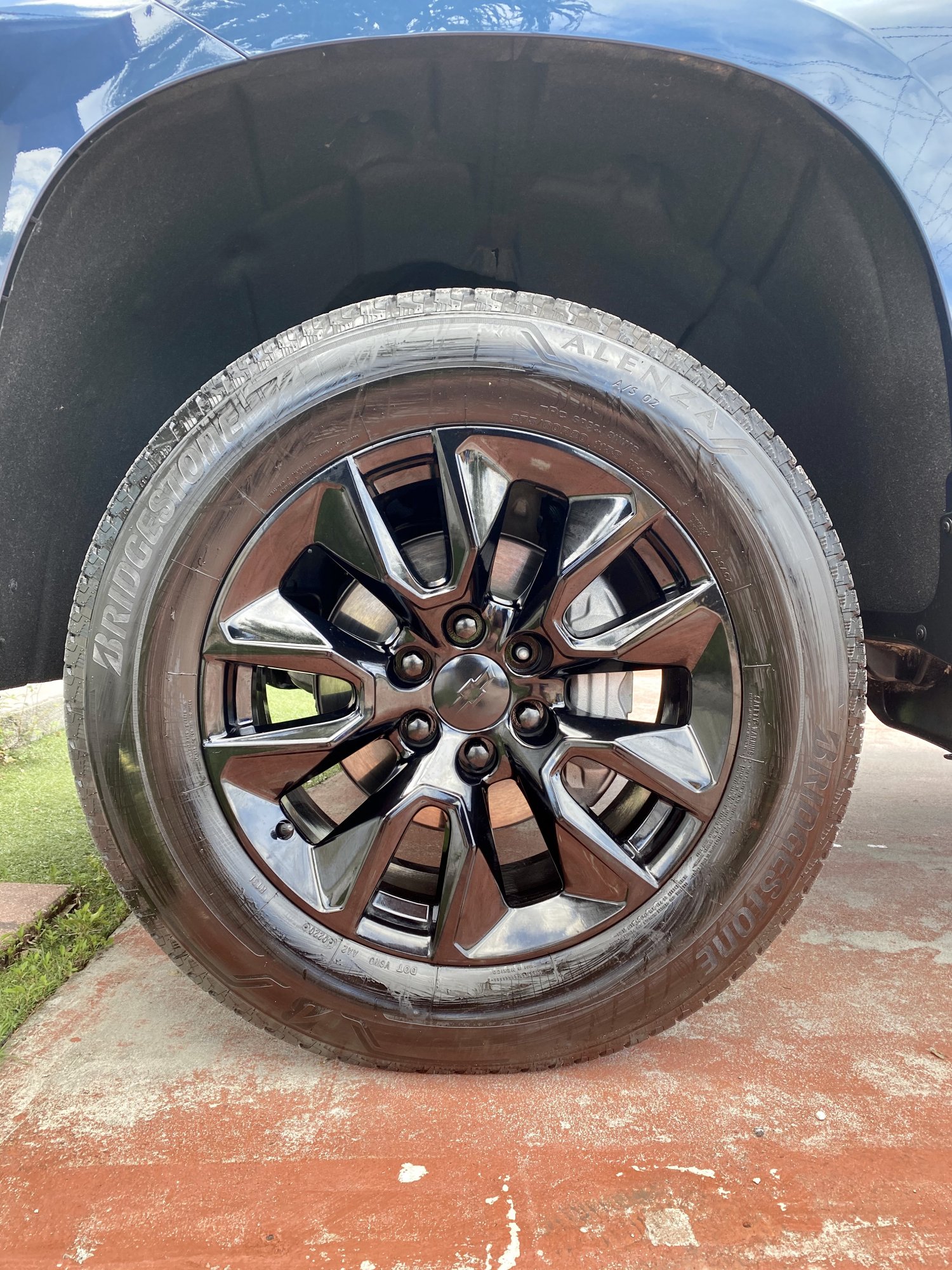

  3. Yea no shot it would fit. My original idea was lift and swap tires on stock 20” rim but that failed quickly. I could barely fit a pinky in between the UCA and tire. That’s the main reason I went with new wheel set up. Glad the pics helped. Had to go with a negative offset for it to sit at a good safe space. Will post pics of new set up to show better idea. Sent from my iPhone using Tapatalk

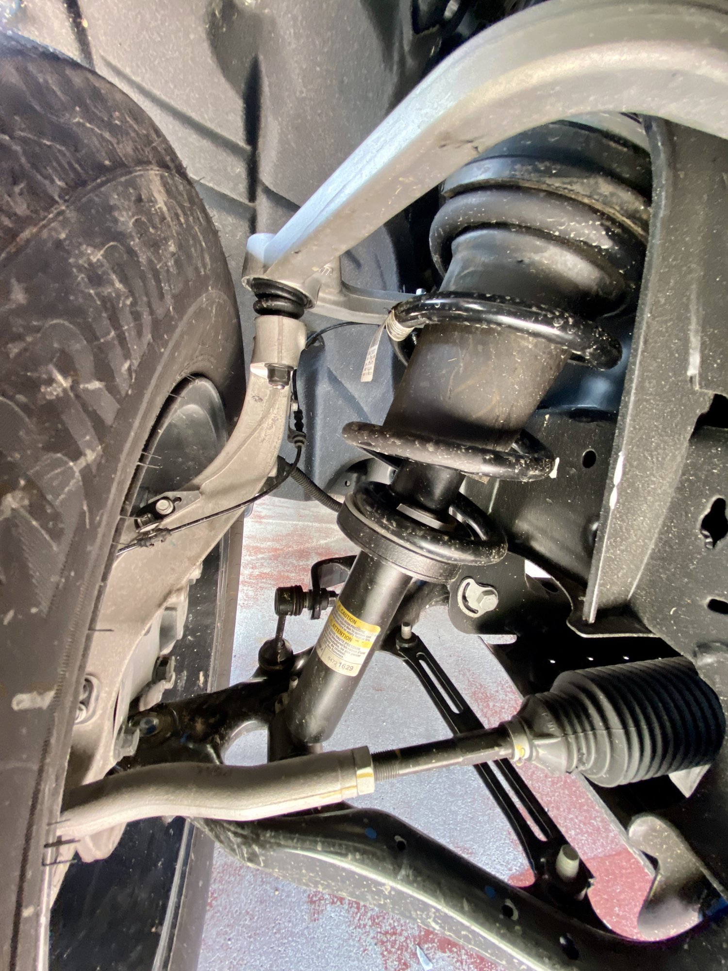

  4. I bought and installed the 3.5” kit from RC and the forged UCA’s that were included at least look and feel incredibly strong... pics posted are my oem wheels that sat pretty close but I’ve since swapped for a new wheel set up so that’s fixed. Sent from my iPhone using Tapatalk

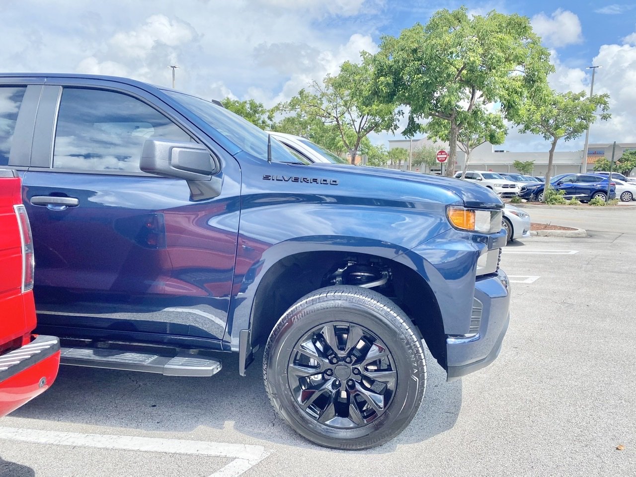

  5. Finally got set up today. This is my daily for work and family trips so I wanted to ride as close to stock as possible. Went with a 3.5” RC lift. Went with Hostile Vulcan Black and Milled 20x10 -19 offset and Nitto Ridge Grappler 275/60R20 (33x11) No spacer needed it cleared the caliper with room to spare. No rubbing at all. Rides like a beauty Sent from my iPhone using Tapatalk

  7. Thought I would add some actual truck pics lol
  8. I just got the RC 3.5” installed on Friday. Only been 2 days but so far so good. Ride quality is a very almost unnoticeable difference but I do find it more solid (which i like). Have my oem wheels set up and it literally is like a 3rd of an inch away from not fitting with the UCA’s that the kit brings. So definitely going to need a spacer to keep oem rims if your looking to add bigger tires. I’m driving around smooth city highways to work and back so no issue right now BUT I’m going with a new set up of wheels entirely so I’ll figure out the spacer situation soon.
