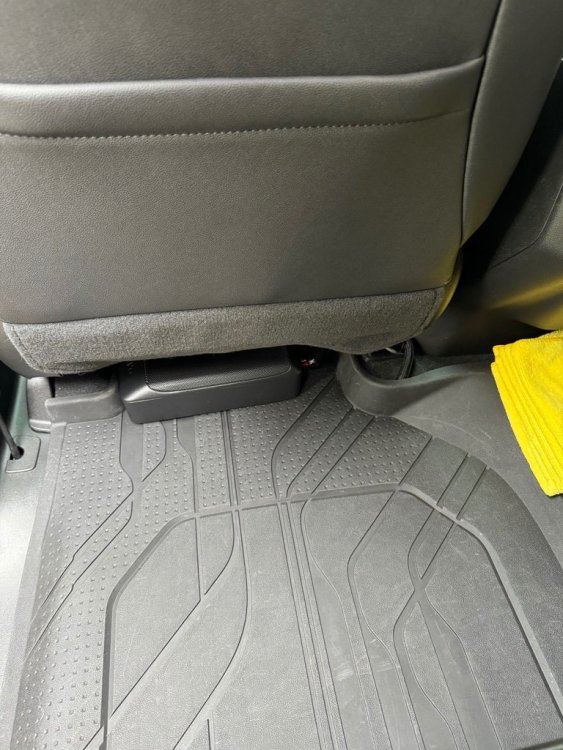

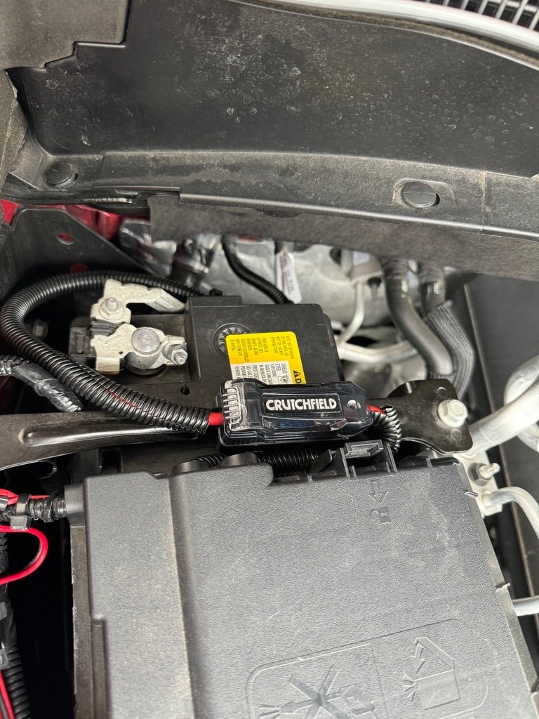

  3. Below is what I have done with my Silverado and I now have a sound system I truly enjoy listening to and it sounds awesome. 2023 Silverado High Country Bose factory system Dash Speakers: Pioneer TS-A709 Front Door Speakers: JBL Club 64CSQ (Did not use tweeters) Metra 82-3005 Speaker Mounting Brackets (free from Crutchfield) Rear Door Speakers: JBL Club 64SQ Scosche SAGMHR-634 Speaker Mounting Brackets (free from Crutchfield) Amplifier: JBL DSP4086 (8-channel DSP configurable amplifier) 40 watts RMS x 8 at 4 ohms 60 watts RMS x 8 at 2 ohms Sub-Woofer: JBL BassPro Nano (6" x 8" Powered Sub-woofer) 100 watts RMS Harness (For tapping into Bose factory amplifier without cutting wires): AIS - Audio Integration Solutions ([email protected]) Bose factory amplifier loads: AudioControl AC-LGD 60 Power Harness: Crutchfield CK8 (8-Ga power wiring kit with inline fusing) I installed the JBL amplifier in the Middle compartment of the GM rear under seat storage (GM option that was on my Silverado)......I could not find a good spot on the back wall of the cab without requiring some sort of fabricated bracket and I was also concerned about the excessive heat back there. The rear seat -back has a ton of foam and will trap a lot of heat. I installed the JBL Nano sub under the drivers seat......it does not fit all the way due to ductwork and seat harnesses, but it fits deep enough to not cause issues with passengers feet. Fine tuning the JBL amp was cool and fun doing it through an application on a laptop.......I dialed it in to my taste and it sounds fantastic. The JBL sub adds a great bass punch to the music......it won't rattle the rust off a vehicle but that's not what I was looking for........it's perfect amount of tight bass IMHO. A remote bass adjustment lets you dial in the amount of bass boost. The OEM sub was left attached and operational.......this was recommended by many (AIS also) to not cause issues with the Bose factory amplifier having issues if it's disconnected. Super happy with the results......sounds sweet. Pics below.....It starts out neat and by the timeI was done it's not as organized as I'd like, but it works well and is covered with the cargo cover, so it works for me.

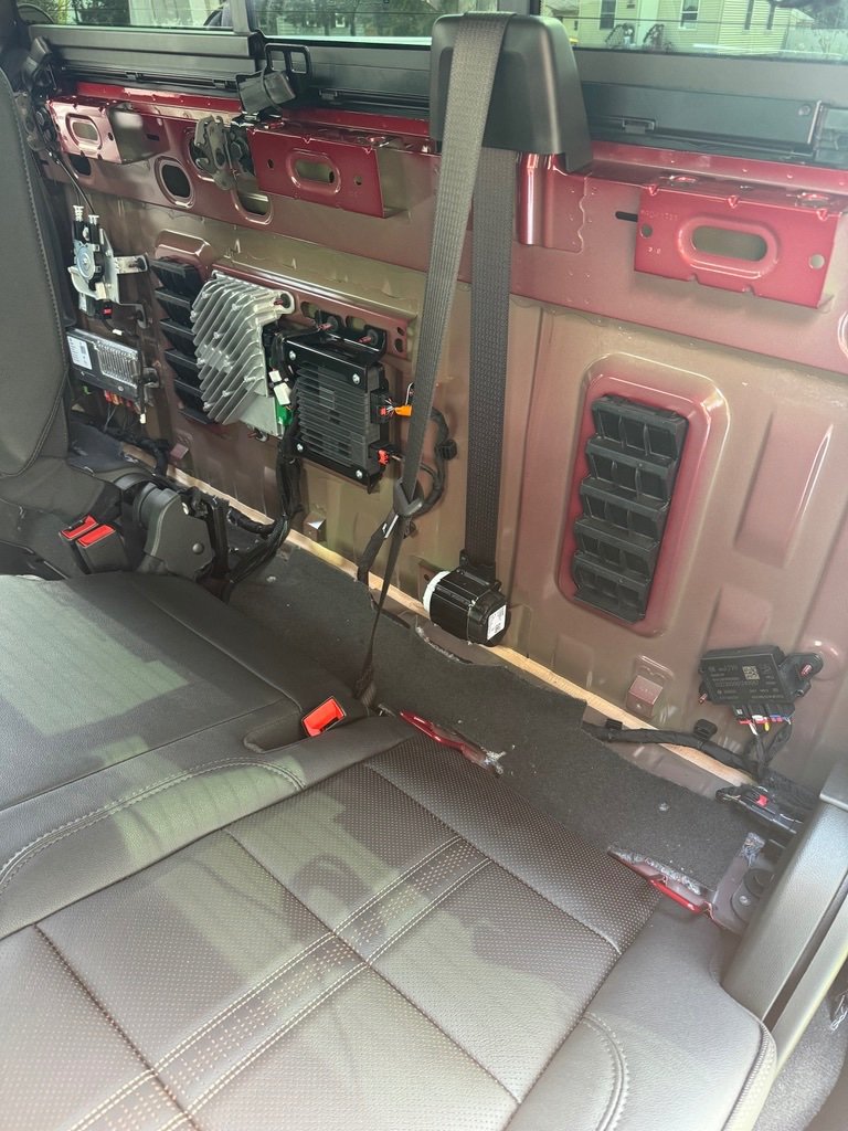

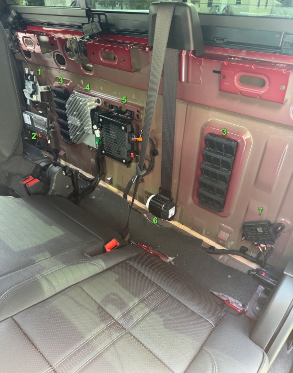

  12. Awesome job! I wasn't sure of #2 and #7........the rest I was pretty sure of and you confirmed. Mounting of #7 looks like a little kid did it.
  13. 2023 Silverado High Country rear panel behind seats........ Name that component, I know some of them but not all (some are very obvious) so someone else will need to verify who is correct! 1 2 3 4 5 6 7
