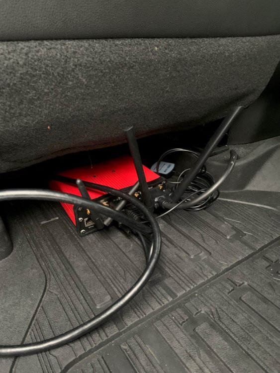

  6. So I took the truck to the dealer on Friday and had the box installed. It is connected to the OBDII port and sitting under the drivers seat and a black cord with a red button is sitting in my cup holders. I was told to press the button if it acts up when i start it. I parked the truck outside at home with overnight temperature at 5F ( -15C) I started it Saturday morning and it went to redline for 4 seconds and settled to idle. I did press the button as told. Sunday and Monday mornings, the truck started and fluttered but quickly recovered. I called the tech and provided the times so he could look it up on the live stream data logger. I was told to keep logging and they would contact me when they have the information. I was also told that 5 other customers have reported the same issue to this dealer so this could be bigger than first thought. I don't mind being the guinea pig or lab rat if this will help others.
  7. Received a call from the service manager last week who told me GM Technical Assistance Centre was sending a Field Representative here to look into the issue with my truck. He then called me back a few hours later and said that they want to install a live link black box that will stream ECM diagnostic information over the cellular network. They have shipped the box here and in the meantime, i took my truck to the dealer to have the wiring connection installed so they can connect the box quickly once it arrives at the dealers service center this week.
