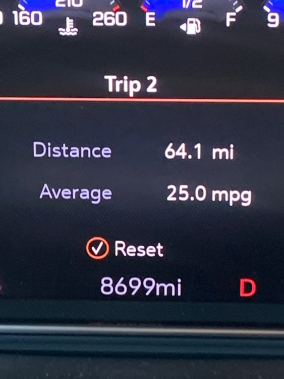

Did another mileage check returning home from camp. Last time got 28.4MPG with a tailwind at 55MPH. This weekend had a very slight head/crosswind and got 25MPG at 60MPH I have the CAI and Cat Back exhaust running 3.23 gears and 91 octane and 50PSI in my Duratrac tires.
