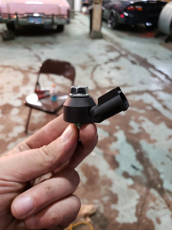

  1. Thanks for the help everyone. I found the sensors on my own a bit after posting... truck had so much rust it was not fun at all. Had to pull the starter to access the passenger side sensor, sort of a PITA. With these sensors? http://imgur.com/gallery/GaSEkJ1
  2. Thats the problem, all the knock sensors Ive seen that go under the intake are the little drum/cylinder metal ones with the nipple type connector sticking straight up out of them, these are totally different... only ever worked on the old style and can't find ANY information on this online.
  3. With this style of sensor? http://imgur.com/gallery/GaSEkJ1
