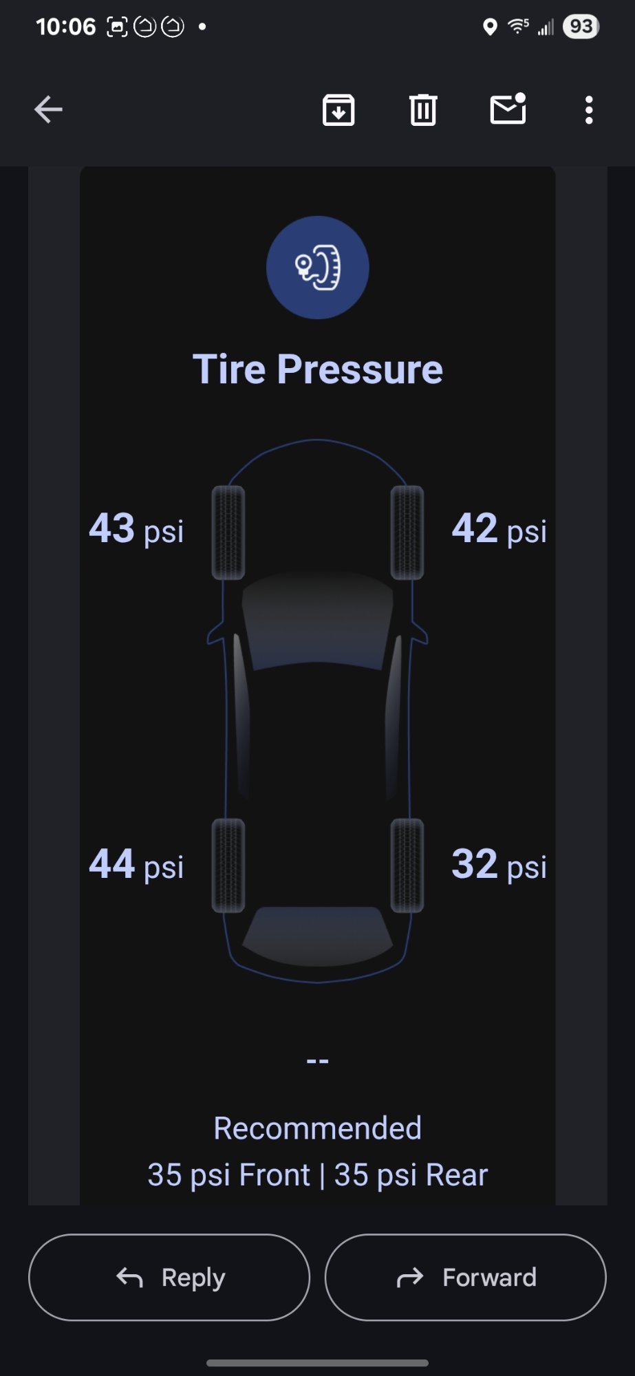

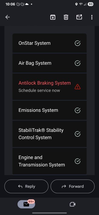

  1. My emails have said 'ABS Diagnostic Alert'for quite some time. Started a bit after a tpms sensor stopped reporting (don't care) and that light came on. Ironically, the emails report all 4 tire pressures but ones missing on the truck menu. No ABS light so I'm not super concerned but figured it's worth asking if I should do something. Thanks.

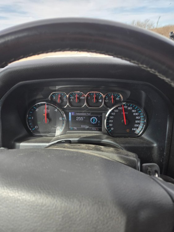

  2. Just got back to some internet. 60-65 on I80 westbound. Limit is 70. I try to stay around 65. In town it's been 145ish with the PPE. I saw 235 deg (again in 4th) towing across TN a couple days ago. Just the truck driving in Smoky Mountain NP yesterday saw 205 climbing to newfoundland gap. Ive been taking photos to talk through with the shop when I get home.
  3. 6L80 transmission. Rebuilt about 5000 miles ago and new billet TC. PPE thermal bypass installed. Day 1 of spring break trip. Towing ~5000 lb trailer into the wind. I was watching temps closely for the first hour of the drive and no big deal. Happened to flip back to trans temp screen and see 255 deg. Was driving in 4th gear. Not shifting / hunting. Slowed to 57 ish mph where the truck would stay in 5th and temps dropped down to ~220 really quick. For the remainder of the drive, 4th consistently generates heat in excess of cooling capacity. Why would that be? Called the shop and was advised to be careful / mindful and finish the road trip then bring it back for them to review. Why would it do this? Photo for reference. Was consistently at 65mph.

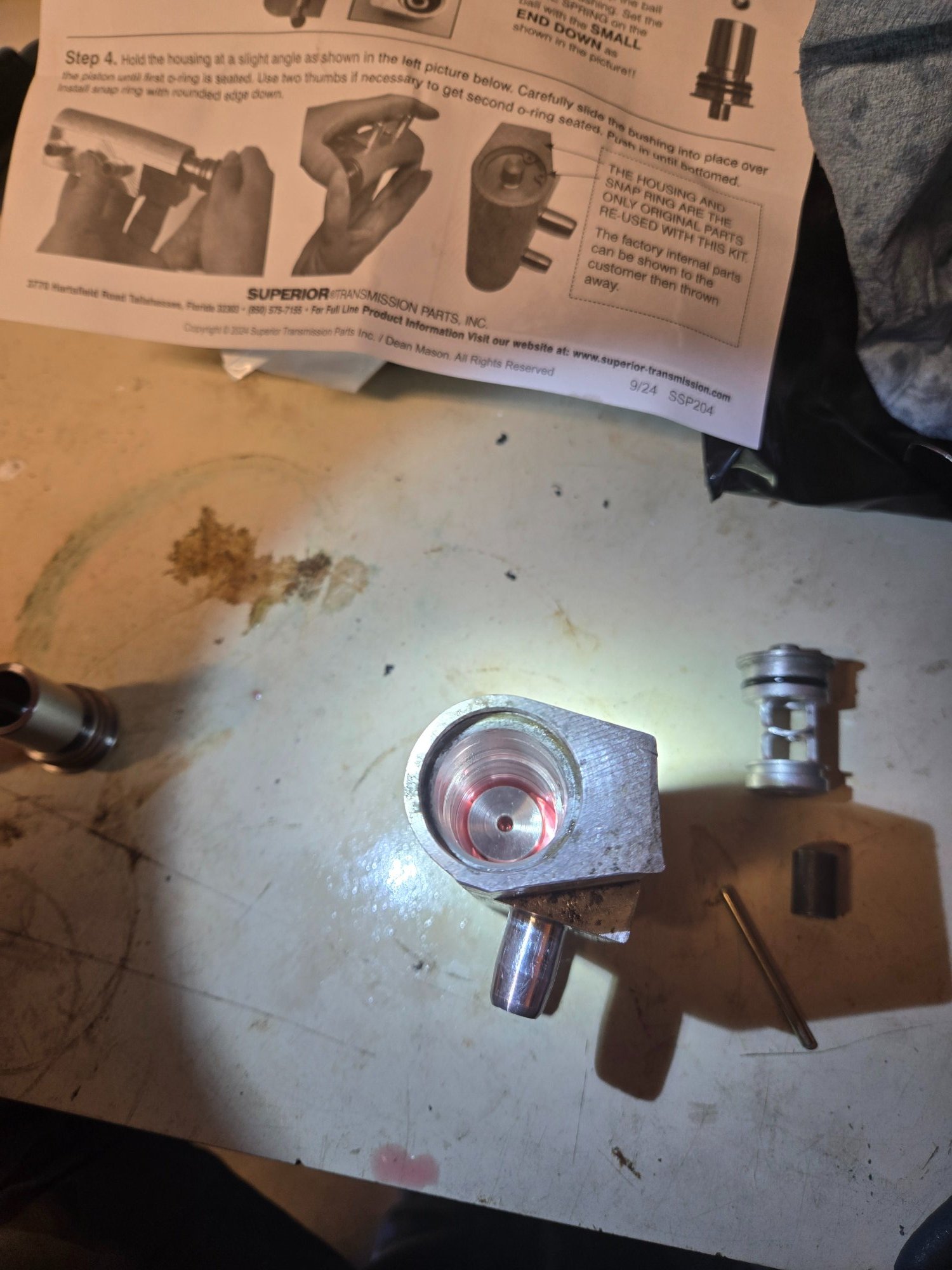

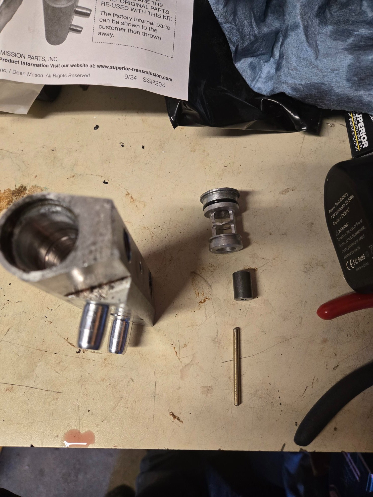

  5. So the pill is then sealing the internal passage. It would stand to reason then that what I've got is a permanent block since there's no passage.
  6. Yeah. Asking because the kit won't work with this housing. I'll probably order a full aftermarket housing or the updated GM one.
  7. So I'm correct that with no passage between, it's essentially always allowing coolant to flow through the lines right?
  8. I purchased the Shift Technology thermal bypass modification kit and went to install it today but the existing bypass housing and internals don't match anything I can find. When I dissassembled it, there was a pin in the center and a cylindrical piece that sits on top of the pin and resides up in the end cap permanently. There is no passage between the two sides (plug both top holes and blow in it and air goes nowhere). Is this already some sort of aftermarket bypass which would be permanently open? - If so, why bother with the pin and cylendrical bit? The transmission runs quite a bit warmer than I'd expect if it were fully bypassed. I got this because I've already had the trans rebuilt once and a billet converter installed and I don't want to do it again. What would you do?

  10. Following up just in case someone comes along. This behavior slowly worsened over time to the point where I dropped the truck off at a shop. First they drove it and couldn't replicate. I said it's usually only after extended trips. They drove it again, replicated, and have diagnosed as issues with the torque converter slipping which creates excessive heat and requiring a rebuild. Stated the high temp causes the trans to go into some sort of a panic state. Called another shop to corroborate the findings and get a competitive price and they seemed to think it's early for the issue to present but sounds about right. I'm in for a billit torque converter and trans rebuild at 47,000 miles.
