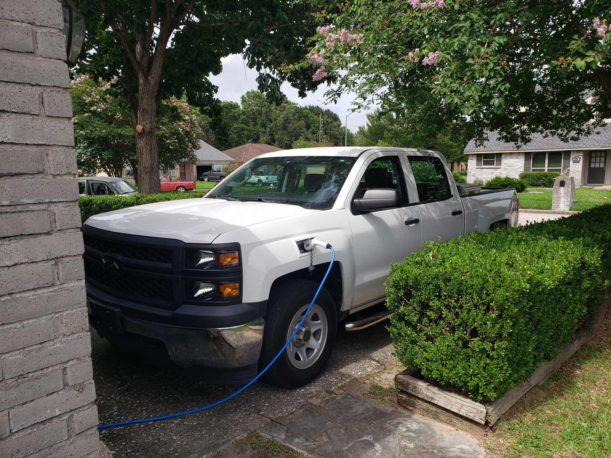

  9. Hello all, I've been having some issues with my 2014 Silverado randomly stalling on me for the last couple months. Seems to happen more frequently after heating up. At first, it would usually run for 2-3 hours before stalling, but now it seems to be getting more frequent, maybe every 30 minutes to an hour. It will stall while idling or while under load. I've checked 12v battery several times at different places, everyone tells me the battery is good. I've checked cable connections, battery ground, etc and found no issues. I've gone over the fuses and didn't find any that were broken. I hooked a VCX Nano up to the truck and these were the codes it pulled: U0101 Lost Communication with TCM, U0121 Lost Communication with Electronic Brake Control Module, P0621 Generator L-Terminal Circuit. I attached the DTC log from the VCX Nano if that's any help. Here's the catch: the truck was converted to an aftermarket Plug-in Hybrid by VIA Motors making diagnosis even trickier for me. The truck stalls while running on battery power and on ICE generator. I'm not sure how relevant these codes are to what I'm dealing with. For instance, the U0101 code seems to be irrelevant because the truck doesn't have a TCM or a transmission. I'm leaning toward an electrical short or bad ground somewhere or possibly ECM failure? Does anyone else have any ideas what could be causing my issues? DTC Display_3GCUKPEH6EG534156_03 05 2021 14 40 14.html
