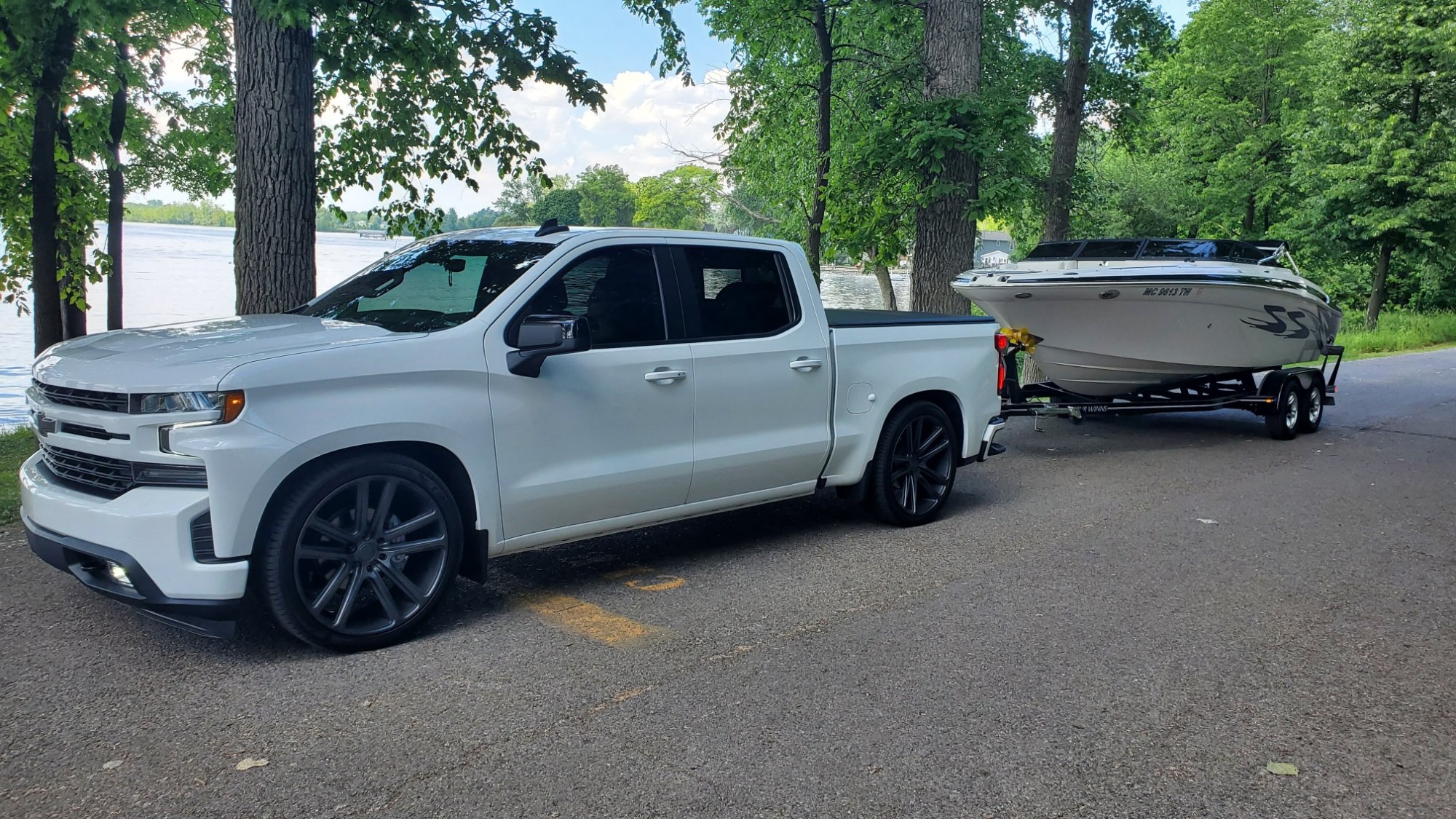

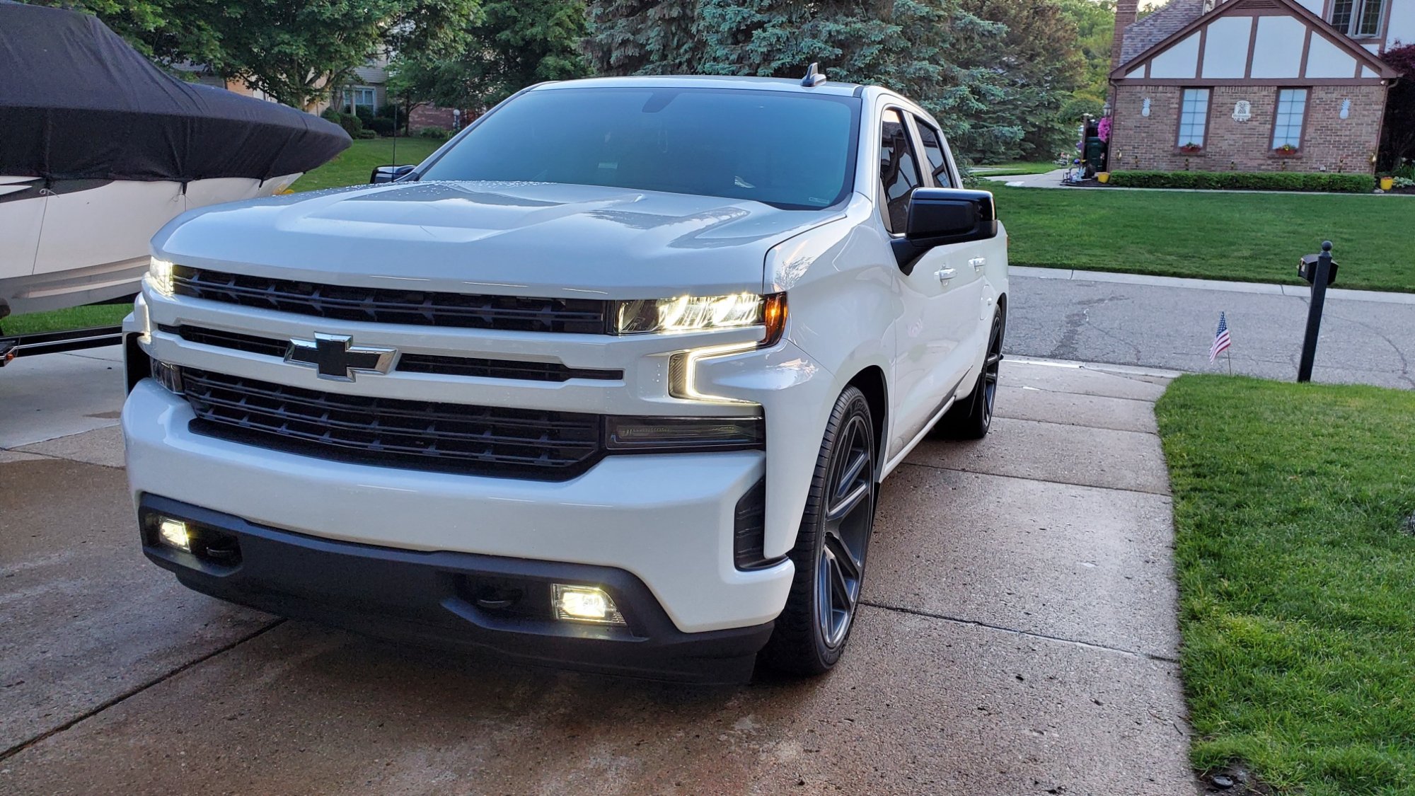

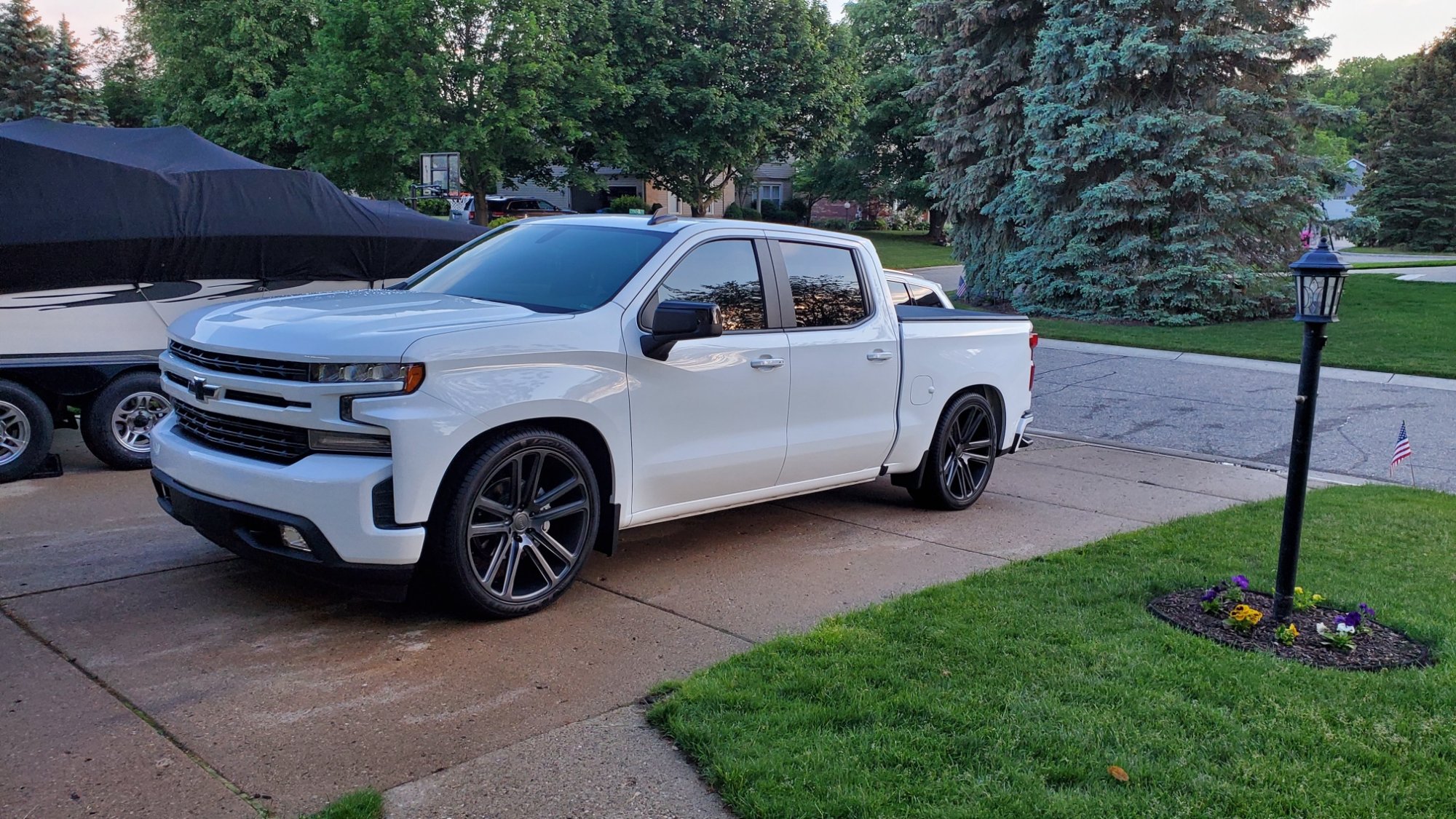

  11. 2021 RST with Belltech set at 3/4.5, IHC helpers in the rear. I'm installing a Twisted Metalworkz weld in under bed notch on Friday so it can finally sit at 4/6. Helpers will be added back on so I can tow my boat. Has anyone else had an issue on a 2021 truck with a bad pinion angle? I installed the Belltech 1041sp kit on my truck and the pinion angle was -10 degrees when it was done. It vibrated so bad I could barely get it to my buddies shop. We modified the rear perches to get the pinion angle close, but still have a vibration under hard acceleration. Once it's sitting at 4/6, I'll check the pinion angle and modify the perches for final to get the pinion angle 0. I called Belltech and since they haven't test fit on a 2021, they can't confirm fitment. Guess I'll be the guinea pig...it doesn't work outta the box lol. Sent from my SM-N970U using Tapatalk
