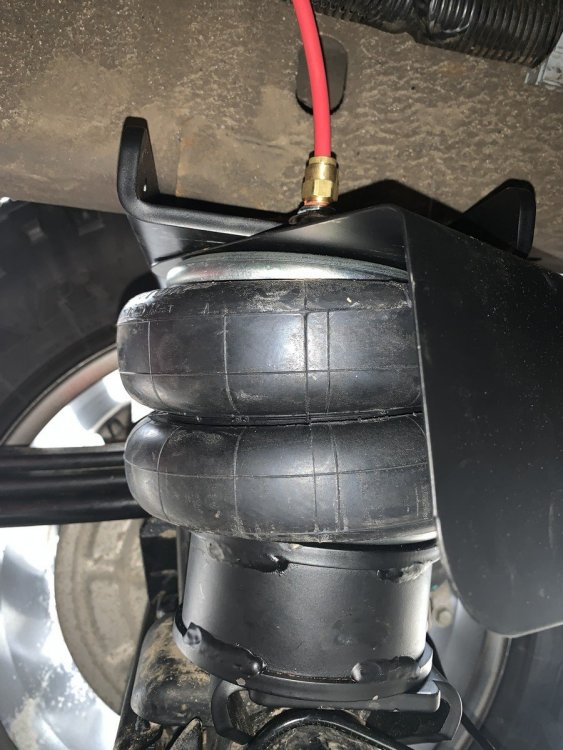

    2020 GMC Sierra 1500 AT4

  6. Hi everyone, new to the forum here and haven't seem to be able to find an answer after searching. Purchased a 2020 1500 AT4 last summer(love the truck), and recently added the Firestone Ride-Rite kit to the rear(kit #2609). I also ordered the 2" spacer kit as recommended (kit #2366). I'm having a bit of a problem with the install and was wondering if anyone else has added rear air bags to their AT4, and did you end up using the spacer or were you fine without it? Problem is the air bags are slightly misaligned, and appear "under-inflated" with the spacer in there even when I have 10-20psi in them(there is about 500lbs in/on the box via a canopy and a Decked box system installed in the bed; I'd rather not have to try and remove these unless I absolutely need to, to diagnose the problem). I know in the instructions it says to have 5.5-6.5" of space between the upper and lower mounts. So my next plan is to jack up the back of the truck enough via the hitch receiver to recreate the correct factory fender gap front to back(should be roughly 1.5" from the factory with no load if I'm no mistaken?), and then measure the distance between the new mounts. Thoughts and/or someone who has added rear airbags to their AT4? I'd assume the Trail Boss would be very similar? Cheers
