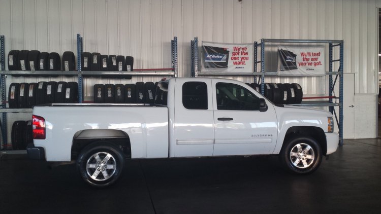

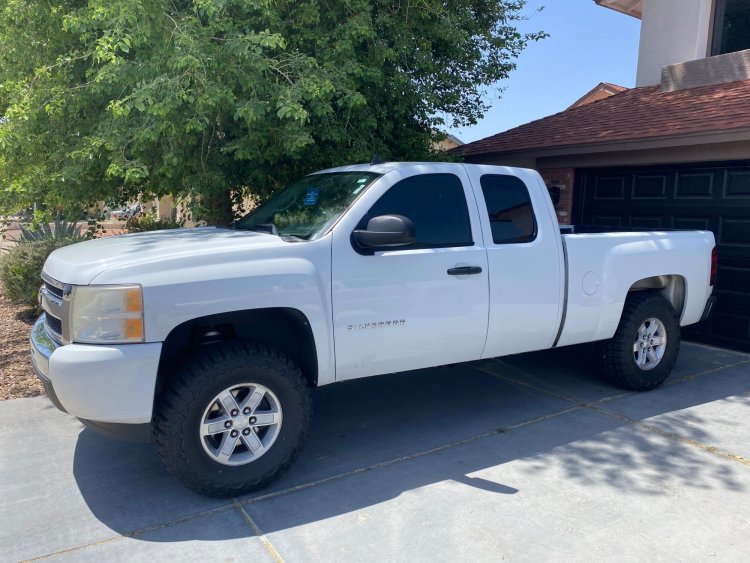

  6. Searched a few months back for some tips or advice and found literally nothing on this board that would answer my questions. So here I am today to report my findings. 2011 Silverado 1500 with stock GMC 17x7.5 wheels worked quite well with my new 35x12.50/17 tires with very minimal rubbing. Albeit I got lucky with my struts and spacer I ordered (somehow got 4” of lift in the front when I ordered “non lifted” struts https://www.ebay.com/itm/391292157619?mkcid=16&mkevt=1&mkrid=711-127632-2357-0&ssspo=M9gllHuoScS&sssrc=2349624&ssuid=&widget_ver=artemis&media=COPY and this 1.5” spacer https://www.ebay.com/itm/301857637099?mkcid=16&mkevt=1&mkrid=711-127632-2357-0&ssspo=KBewltw-T9u&sssrc=2349624&ssuid=&widget_ver=artemis&media=COPY first pic below is before strut swap, second pic was after, but before tire swaps…I’ve gone through several tire iterations that included 295/70-17 and then finally the last pic with the 35’s she’s a little squirrelly from 50-75 in the front so I have to figure out why, but these thunderer trac grip MT tires seem quieter than their 295/75-17 little brother. And I love the look of those bigger tires. Just wanted to share in case anyone was looking in to doing something similar!
