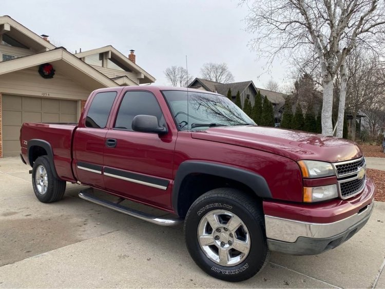

  10. the stock size i think was 265/70R17 I need to buy new tires and was just wondering if i can just get the 275/65R18 tires, or if this is bad and maybe the owner messed up something by putting on the bigger wheels? i don't know if it has a lift or anything, can't really tell. i attached a picture if it's helpful at all.
