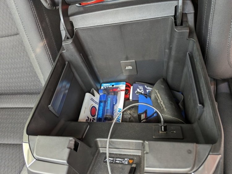

No, RAP does not shut the console light off. It stays on even after the ignition is off and the driver's door is opened. Eventually it goes out - I believe on the battery protection time-out, the same way as if you left other lights on (like if you left headlights or interior lights on by accident). I'm wondering if maybe this is a glitch from one of the recent software updates. Like I said, it's really easy to see from outside the truck when it's dark (the light shines through the console opening where the wireless charging pad is and illuminates the shifter / cupholder area), and I have a hard time believing that I never noticed this until a few weeks ago. -

Here are photos of the console from the outside and with the lid open, showing where the light is. As a followup, I stopped at the dealership this morning and asked the service advisor about this. He didn't know, but went to talk to one of the techs; he supposedly talked to one of the truck techs. The advisor told me that he started to ask the tech about it, and as soon as he mentioned the light in the storage compartment, the tech cut him off and completed his sentence, assuming that I was asking about the light staying on all the time. The tech claims that's the way they all are, and that the light just stays on all the time until the timeout after the truck is shut off. Seems ridiculous that they would engineer the thing without a switch for the light, but that's the answer I got from the dealership, for what it's worth. -

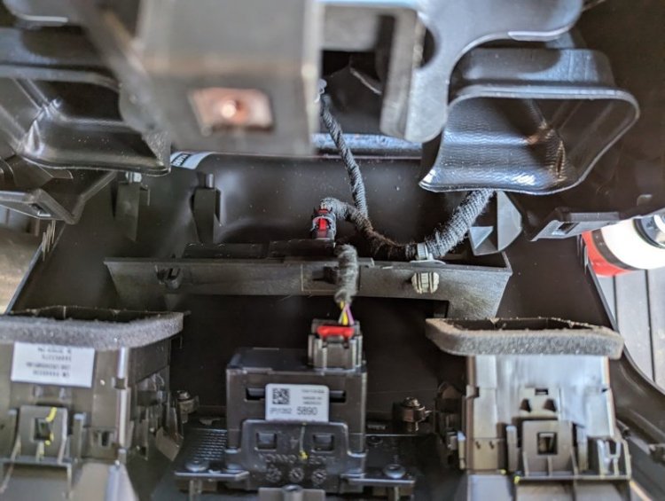

Unfortunately I don't have any photos of the console/lid from the outside right now, and won't be back to my truck until the end of the week as I'm working out of town. I attached two photos of the wiring on the inside of the console that I took when I had it apart over the weekend. One photo has the light circled in red. You may not be able to see clearly from the photos, but the wiring harness that comes back there terminates at only the locations that I mentioned in my previous post, then runs down to the floor / bottom of the console. There's no wiring that goes anywhere to the lid or hinges. I'll post pictures of the console at the end of the week when I get back. In the meantime, I appreciate you taking the time to try and help! -

I took the back of my console apart to where I can see the entire lid hinge mechanism and wiring for the light, rear USB ports, etc. I don't see any kind of switch or place where the lid hinge mechanism would contact a switch, and no wiring except the terminations to the light, rear USB ports, and keyless entry antenna. There is no wiring going into the console lid, either. If there's a switch, it would have to be at the front of the console where the lid latch is, and would have to be actuated by the latch points of the lid. I see no sign of anything in the holes in the console where the lid latches. Any other thoughts? I guess I might have to call the dealership. I'm starting to wonder if this light is working as designed and/or has been on the entire time I've owned the truck, and maybe I just never noticed it until recently. -

Thanks, Bikerjon. That answers my question as to whether there's a switch. I'll probably take it apart myself to see what the issue is, and if it requires any parts, I'll likely just schedule it for a warranty repair so I don't have to pay for them. -
