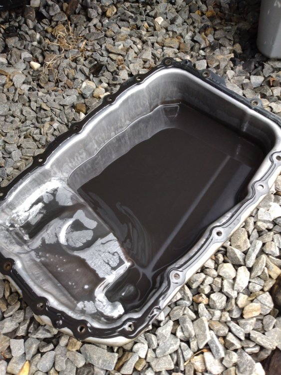

  11. I was reading in another post of yours that the 4.3 V6 has a different torque converter? Do you think by the looks of the pictures of the pan that in fact my torque converter with the 4.3 V6 is in fact failing? and if so what torque converter would you recommend replacing it with, or just replacing the whole transmission ? thanks

  15. So I got everything back together and installed the new surecool bypass. After getting my transmission fluid up to the proper level it seemed to be shifting great. I put it in manual mode and when I shifted between M5 and M6 you could tell it changed gears. The temperature however kept climbing up into the 240s and then when in high gear seemed like it changed gears again and rpms dropped lower. Almost like the torque converter was not switching between modes the whole time and finally did? I also noticed that when I put it in gear or in reverse the lights dim a little and bogs the truck down some and vibrates some. What is really crazy though, is when I was going up a hill, it shifted into high gear instead of downshifting. Also when I was letting the truck idle in the driveway, I seen a message that popped up that said engine oil level low, add oil... checked the oil and it was fine...Almost seems like I have some kind of computer/electrical issue here. I was reading that the torque converter clutch solenoid valve can cause symptoms similar to this. Do you guys think it would be worth my time trying that, since there was no metal in the pan? Or can the torque converter still be bad even if there is no metal shavings on the magnet? What are your thoughts on this? Thanks for all the help!
