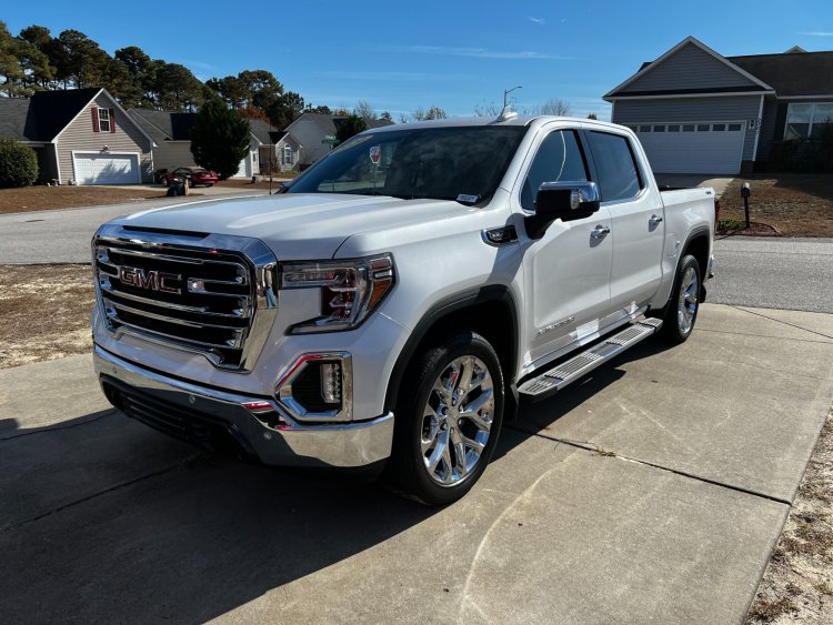

  3. Hello to the group. I'm new here and was hoping I could get some idea as to what happened on my 20 Sierra SLT. I was on the interstate and passed going around 80 mph. Right afterwards I was back to 75 and suddenly the CE light started flashing and the dash had flashing message "Service Parking Brake". This went on for about 30 seconds and disappeared. I could feel some subtle jerking as I pulled off at the next exit. Felt like the trans (10 speed) was searching for a gear. As I began to put on the brakes there was more profound jerking like the parking brake was pulsing. Everything on this truck is electronic including the parking brake. I have an OBD tester and it pulled codes P0300 (Random, multiple cylinder misfire), U0401 (Invalid Data Received From ECM/PCM "A"), U0131 (Lost Communication With Power Steering Control Module), U0102 (Lost Communication with Transfer Case Control Module) and U0140 (Lost Communication With Body Control Module). I shut the vehicle off and checked under the hood but everything still looks pretty new under there. Checked for loose wires and didn't detect any. I went directly to the dealer and they said they would need to have their engine specialist diagnose it but couldn't get me in until 3/23. The truck ran much better on the way to the dealer and now runs like nothing ever happened. Full power and smooth. WTH!! Any ideas folks? I'm not sure anyone has experienced this exact issue but would appreciate any ideas. Thank you Update: the issue above happened on 3/8/2023. The truck was running normal until 4/3/2023 when the CE light started flashing again and this time the code was P0308 (cylinder 8 misfire) On shortly thereafter the light went out and ran normal again. I took it to the dealer who performed diagnostic and said the issue was fouled plugs. They replaced the plugs and all seemed fine until yesterday the CE came on again with a P0300 and runs like crap. Runs worse than ever. This seems to be a widespread occurrence in these vehicles. Has anyone had this resolved?
