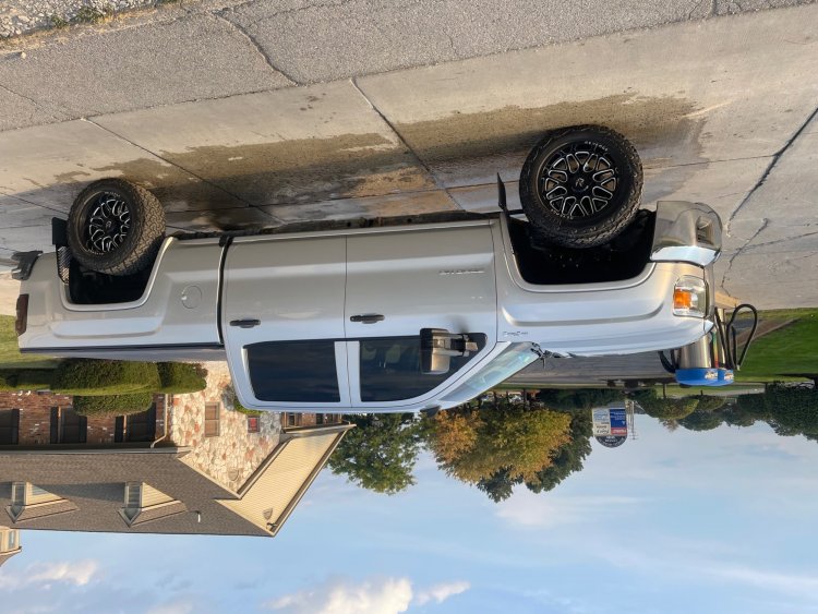

  1. Had it on for a week now. The potholes are what are real bad. Since it’s turned up a little much those shocks don’t have room to stretch down on potholes or turning into places. Yea I don’t expect it to ride amazing it is a hd truck. I ordered the shock extensions gonna put those in and turn keys down hopefully that should help. It truly feels right now like the front shocks are just solid steel. Will look for some better pics of the mudflaps very happy with them. It won’t upload photos says to large will get some on here in a bit
  2. So I installed a kryptonite stage 3 leveling kit on my sierra HD. Cranked up the keys so it’s just about level, it had quite a bit of rake to it before. Came out to a total of ~3.5 inches lift in the front and 1 inch in the back from the new bilstein shocks included. It looks amazing but my issue is it rides rough. I don’t want to lower the front and lose that nice stance it has. Can I install the kryptonite shock extenders as well with this kit to get my ride quality back? Or any other suggestions?
