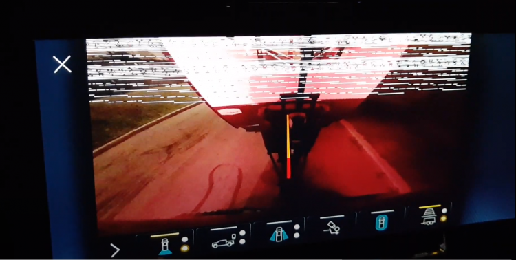

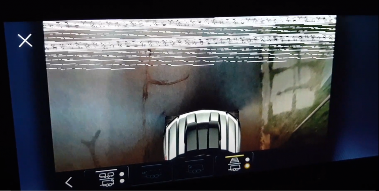

  5. Hello, does anybody here have the camera issue too (white lines at the top, see my first post at the beginning of the thread) when the trailer is connected? I hope my two issues are related, and fixing the trailer brake controller will also fix the camera which is otherwise unusable when is dark outside. Thanks!

  11. Hi Shield1984, Thank you for your comments! Yes please, I would like to have more details on bulletin PIT5948A. I will also open a case with GM this week, I have to get more info on the procedure. Any hints on this topic would also be very appreciated. I absolutely agree with you on the Lemon Law! Although we don't have the Lemon Law in Canada, there is an equivalent that can ultimately force the manufacturer to buy back the truck. I absolutely love this truck, but I bought it for the towing capabilities, so if it cannot accomplish its main purpose, it is useless for me! Thank you!
