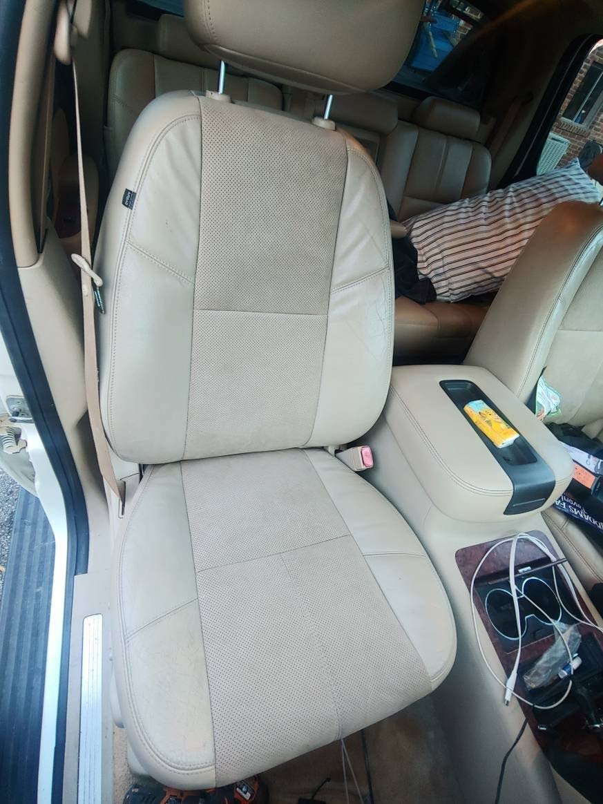

  1. So I am swapping in a set of air conditioned seats from a 2010 Suburban (needed some wiring diagrams) in to my 08 LTZ. Determined that GM in their obsessive cheapness decided to make two different wire harnesses for heated vs air conditioned seats with the AC seat harness having 6 less 3 ft 18 gauge wires. Oh the savings! Anyway, a quick trip to the junkyard solved that issue. Now that I have all the wires I have an issue with the cool button not working. All the heat buttons work correctly and show up on my scanner (Foxwell NT680) as communicating with the memory module which controls the commands to the climate control seat module, but the cool button does not. I am wondering if this is programming issue between the mem seat module and the truck. The seats, door switches, and modules all came out of the Suburban so they all worked together before, but of course my LTZ did not have cooled seats from the factory. Wondering if I have a bad module or if it needs to be programmed by a Tech 2 or other GM programmer. Most interested to hear from people with either firsthand knowledge or ideally GM techs who could take a look at their trucks and let me know the best route to move forward. I am considering swapping in a different mem seat module to see if that is the issue with communication. Picture for attention - I had the centers recovered in Alcantara from Relicate.

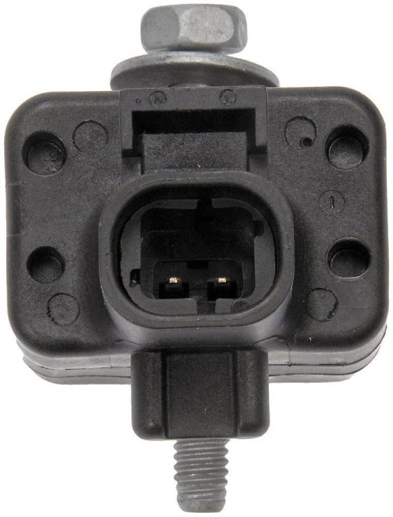

  2. So I have the common airbag sensor fault, swapped left and right and confirmed bad sensor as the fault followed the sensor. I have the 25896408 sensors. So the strange part is that my sensors do not have the keyed slots on the inside of the sensor like all the ones I see available on the internet, mine have nothing in the female socket. The problem of course is my plugs will not go in to the keyed sensors (I obtained several at the junkyard to try). Two of my junkyard sensors are similar, same pn on the label, but different plug configuration. Unfortunately I do not have a 25896408 with the correct plug configuration and have not seen any online with the correct one. Local Advance was similar to all the ones I see online as well. Anyone else run in to this? Is there a solution other than replacing the plugs?
