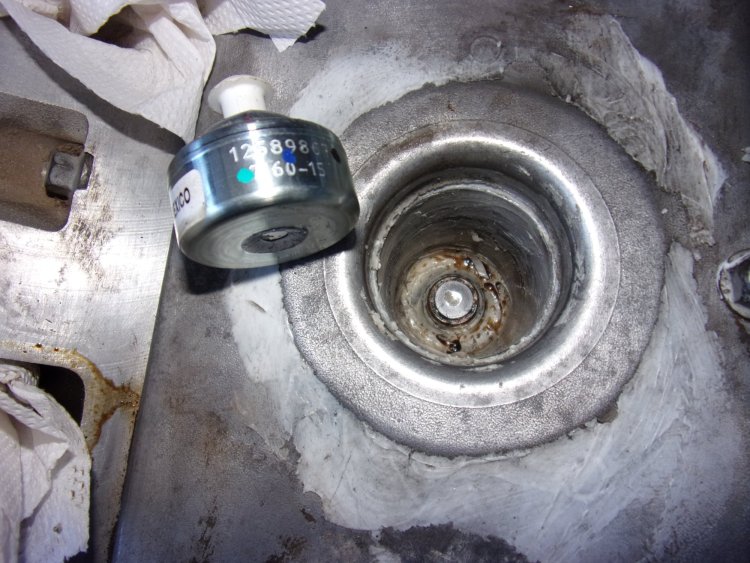

  1. I purchased some knock sensors from the dealership. These each cost ~$175. I went to remove the old KSs and they just spun around, so I twisted them hoping to pinch the seal, and instead broke them. I needed to carefully drill, and then extract using an extractor tool. They weren't in there too tight, but the assembly spun, so it is what it is. You can see the picture where the KSs snapped. This happened to both the sensors, but I did remove them both without any more issue. I was able to tighten the new sensors to the appropriate 15 lb/ft torque. I've had no other issue since I've changed the knock sensors. You can see in the picture that the older sensors look authentic, but I think purchasing knock sensors should be done via the dealership. Lesson learned after getting burned. Oh, and I was able to copy one of the engine codes when I had the intake off. Seems like it is a 6.0 afterall. Thank you for the help @newdude

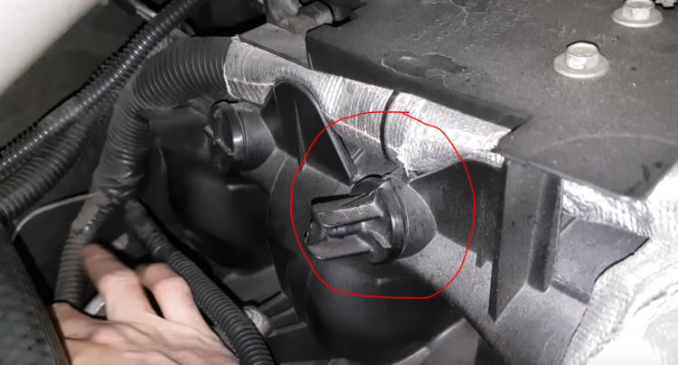

  3. I think whoever owned this truck before probably got a lean code and decided to plastic-weld this piece on forever. Thanks for the responses guys.
  4. I'm looking over the intake manifold and noticed that a piece of it is melted. I'm neither its function or what it is. This is the picture of the piece. It's not my picture; like I wrote, the one on my intake is melted in. Someone looks like they may have plastic welded it? I'm not sure. Maybe this is related to the knock sensor problem? Will I need to order a new intake manifold? Here's another picture.

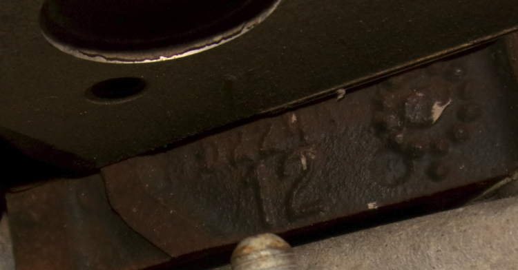

  7. I can barely see the first 4 digits on the back when laying under the engine. The casting number in the front is underneath a bracket. Very frustrating. I'll have to pull the engine out to identify it. I think the first 4 numbers are 1255.
