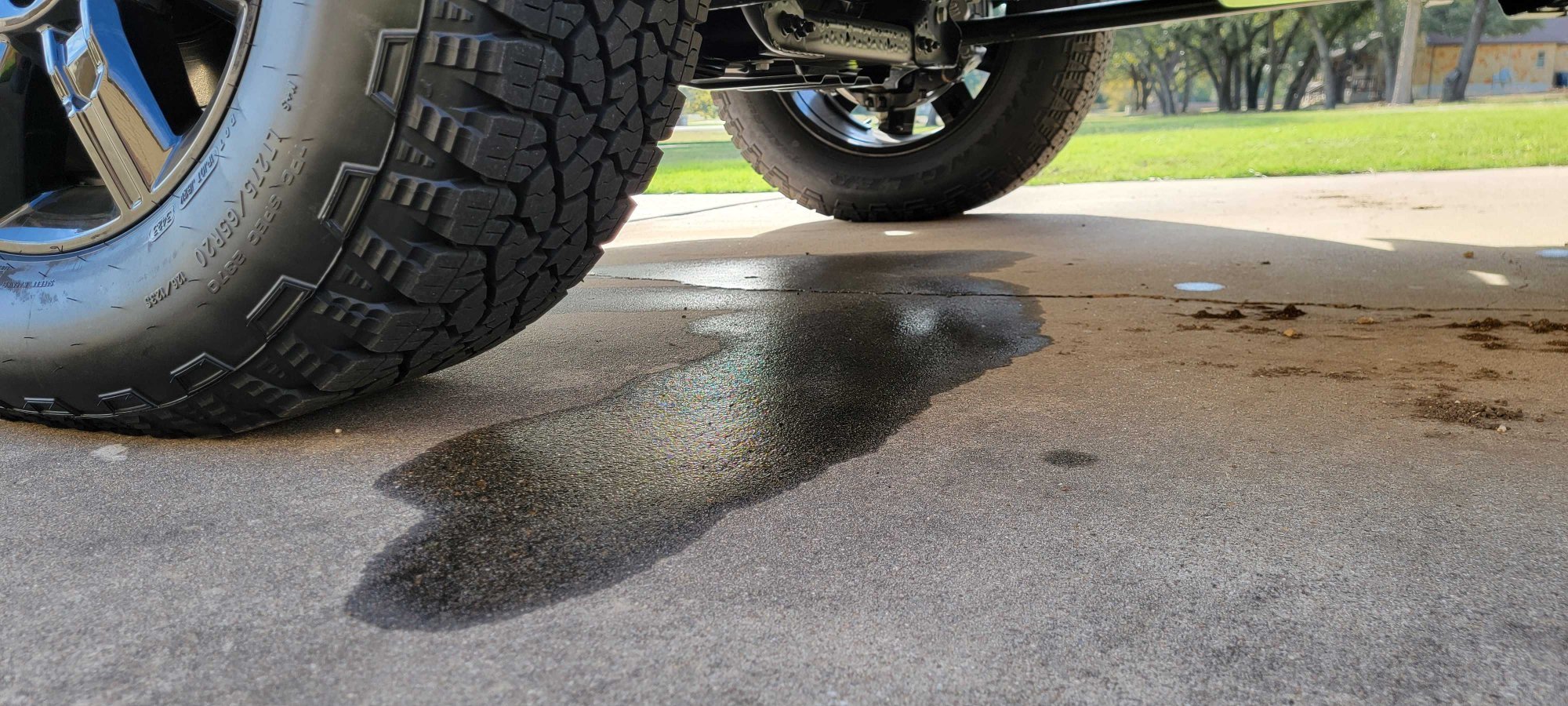

7

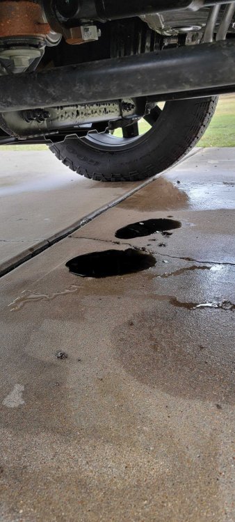

  3. The latest in this ongoing saga... I got a call last Wednesday that the truck was ready for me to pickup. Drove it home (now for a total of 108 miles on the truck), got out and looked underneath to find two puddles of oil forming. Had dealer come tow it back. They called me yesterday to say that it's the oil lines going to / coming from the turbo. Unbelievable. No ETA on this attempted fix. @GMCustomerService
