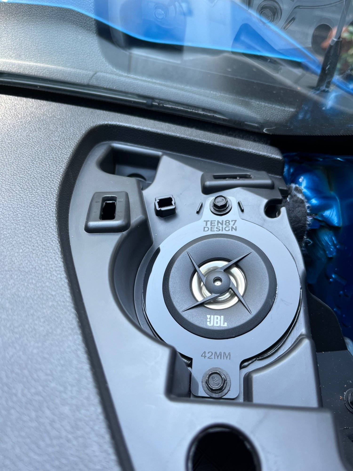

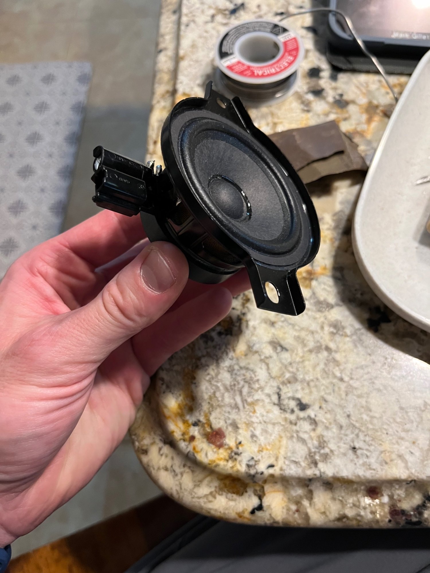

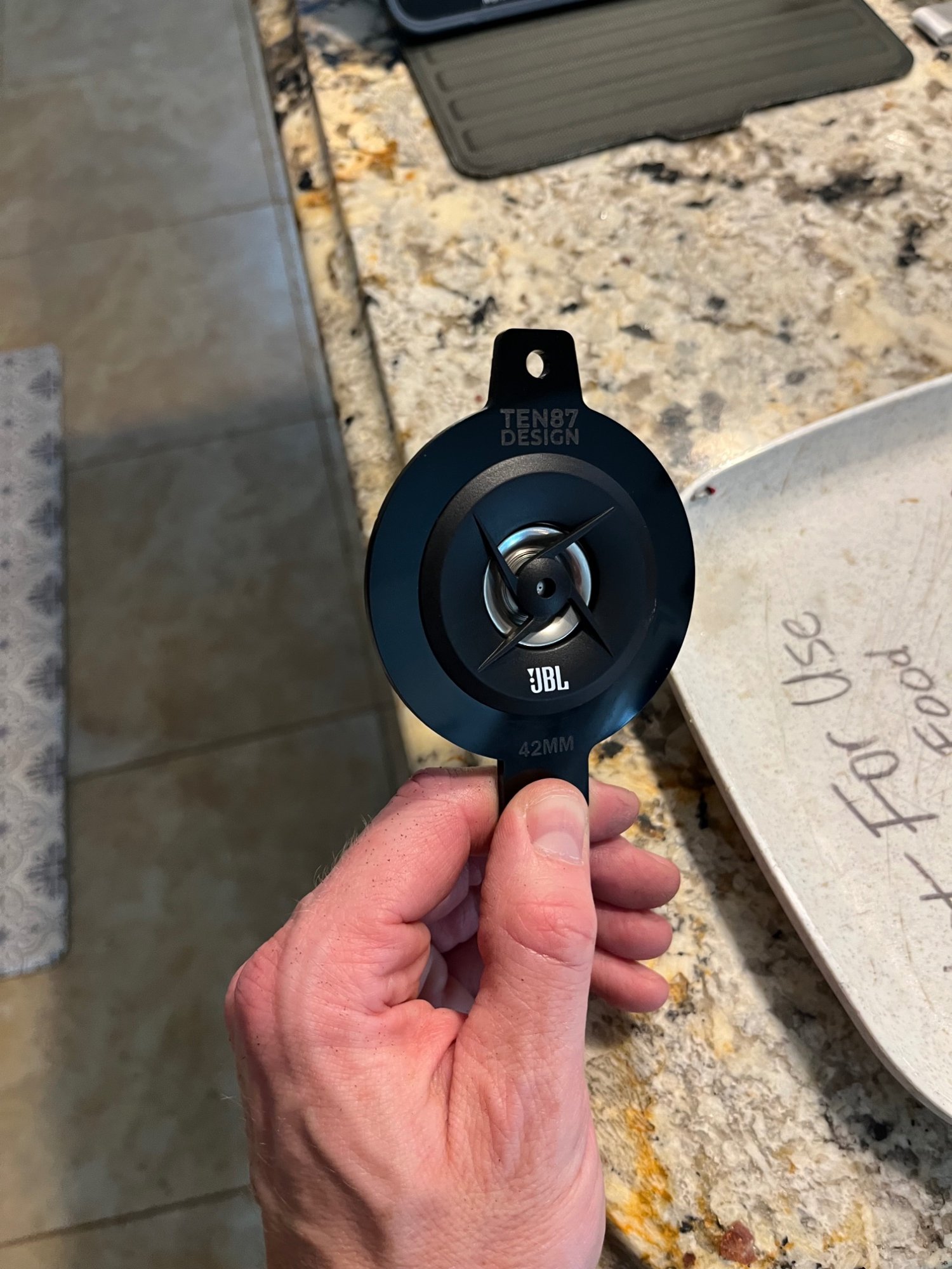

  1. It may be hard to see, but I did use the filter that came with the JBLs. I cut off the OEM connector which has the OEM filter molded into it. I used a dremel to remove the OEM filter, glued the JBL on in the same space, and then soldered it and the tweeter into the connector. Then I glued my masterpiece onto the bottom of the JBL tweeter housing/cup that came with it. I didn’t look for a write up so can’t help you there.
  2. The OEM tweeter has a filter so when I replaced my tweeters, I removed the OEM filter and wired in the one that came with the new tweeters. Yes, there is a plug. Doing it this way was not plug and play. I spent about an hour on each tweeter getting them to the point they were plug and play.
