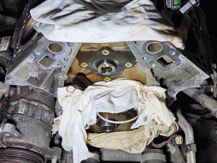

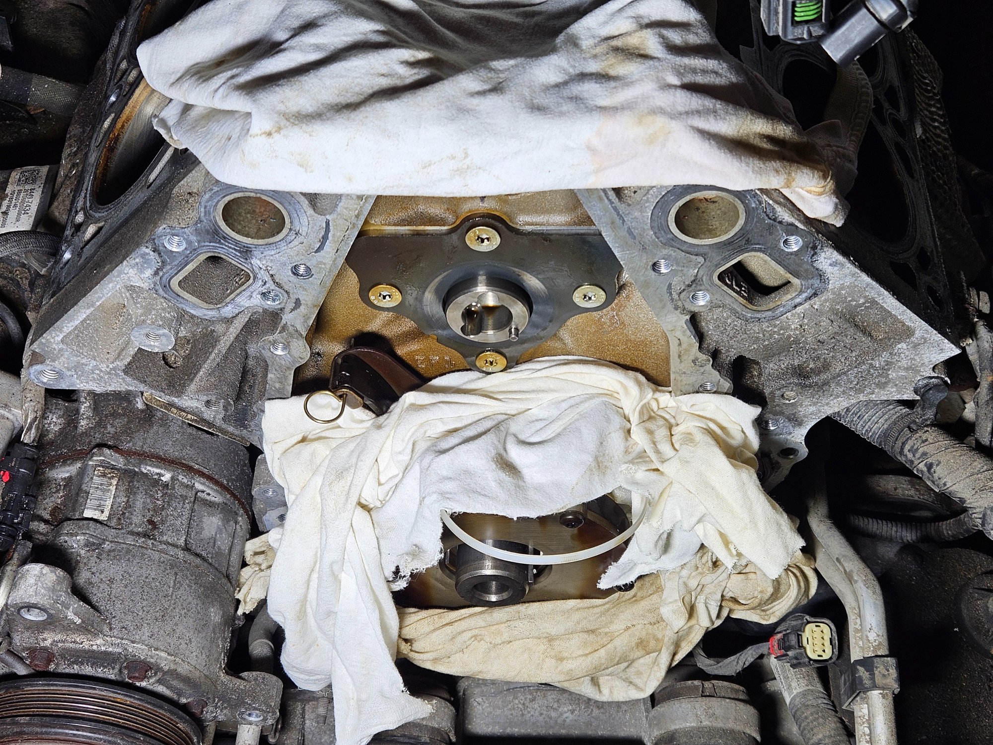

  4. Schnikes. It worked. Thanks for the confidence. I probably owe you a beer or two fingers of Blantons. I did end up unbolting the oil pump and sliding it as far forward as I could. The oil pumps on the L84s have alignment dowels, so I'm not too concerned about getting it back in position. I just have to be careful with the rubber seal in the oil pan for the pickup tube. I was able to get enough slack that I actually just used my fingers to push the chain off the backside. I then had to fight trying to get the gear/phaser past the chain, but still a million times easier than dropping the axle or pulling the engine to drop the oil pan. Hopefully it goes back together. Now I just wait for my camshaft.

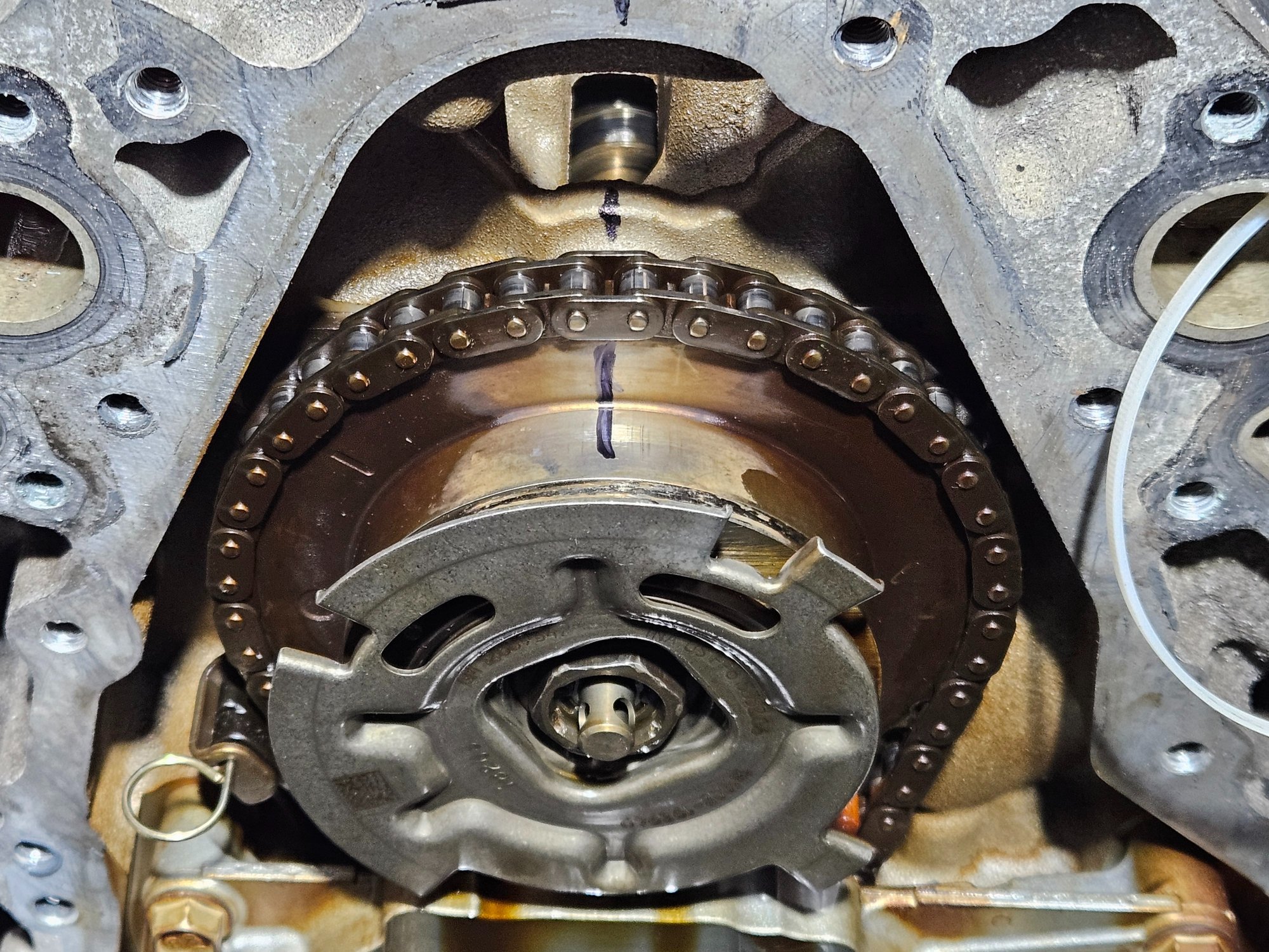

  5. I like your suggestion of marking the flex plate at locker at TDC. That's a good check after reassembly (assuming I can find the sweet spot). I have a piece of fishing line tied around the top of the chain to try to keep it from dropping, and a zip tie off to the side to keep it from falling out of reach if the fishing line breaks. Did you unlock the flex plate to be able to rotate the cam gear when you were walking the chain off? If so, were you able to get the cam sprocket back in in the right spot on the first go? That seems like the easiest way to find the sweet spot, but it also seems like it would be more difficult to get things lined up right, but with the mark on the flex plate and lock, you'd at least know that you have to pull it off and adjust over a tooth or so.
  6. Do you have a picture showing where the sweet spot is? I was trying right here so the phaser plate doesn't hit the oil pump, but I wasn't having much luck. I've got one gear tooth hitting on top of the driver's side chain guide. I'm going to try turning the engine one-half of a gear tooth further and see if that helps. Yes, I have the flex plate locked.
