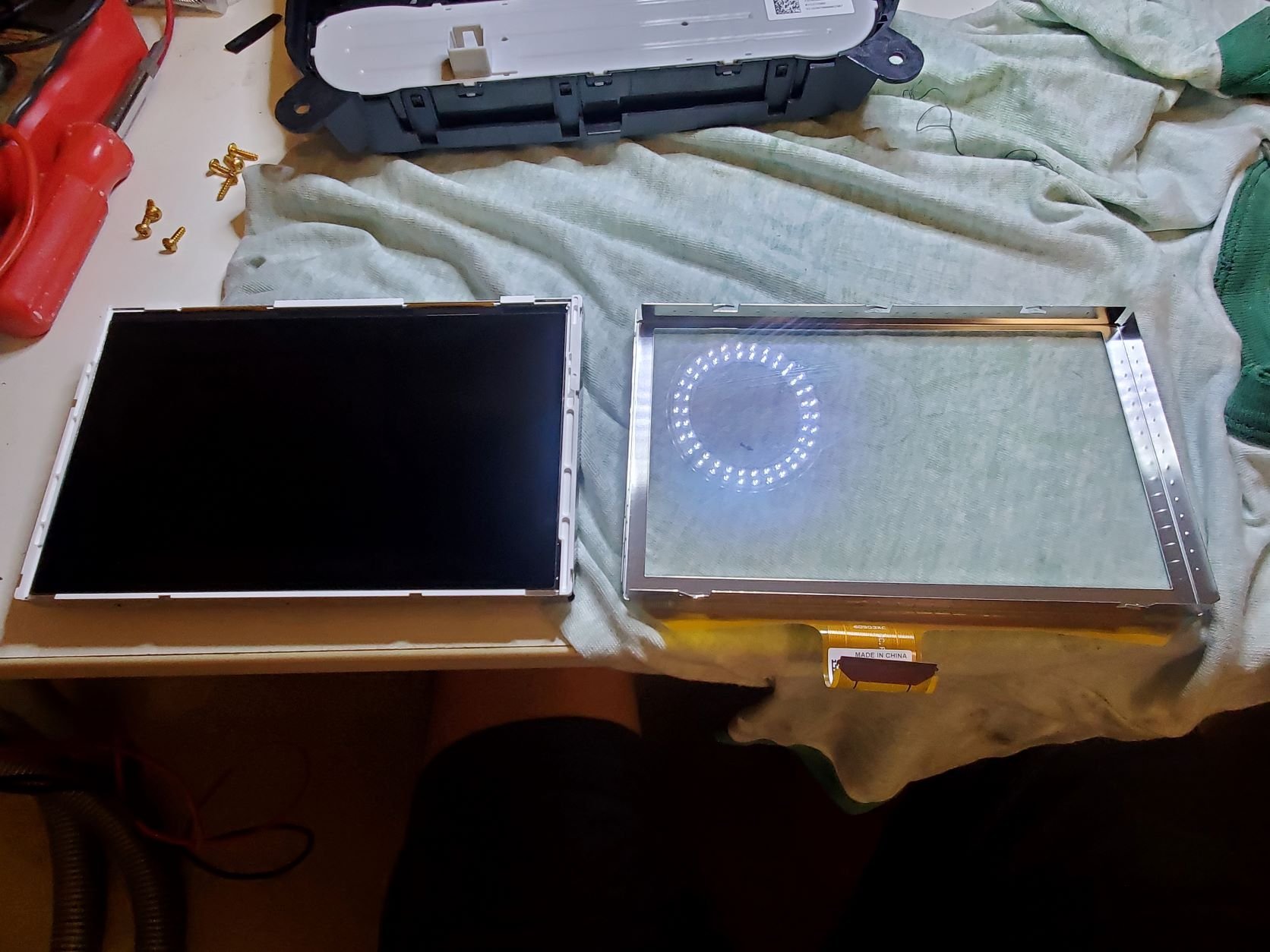

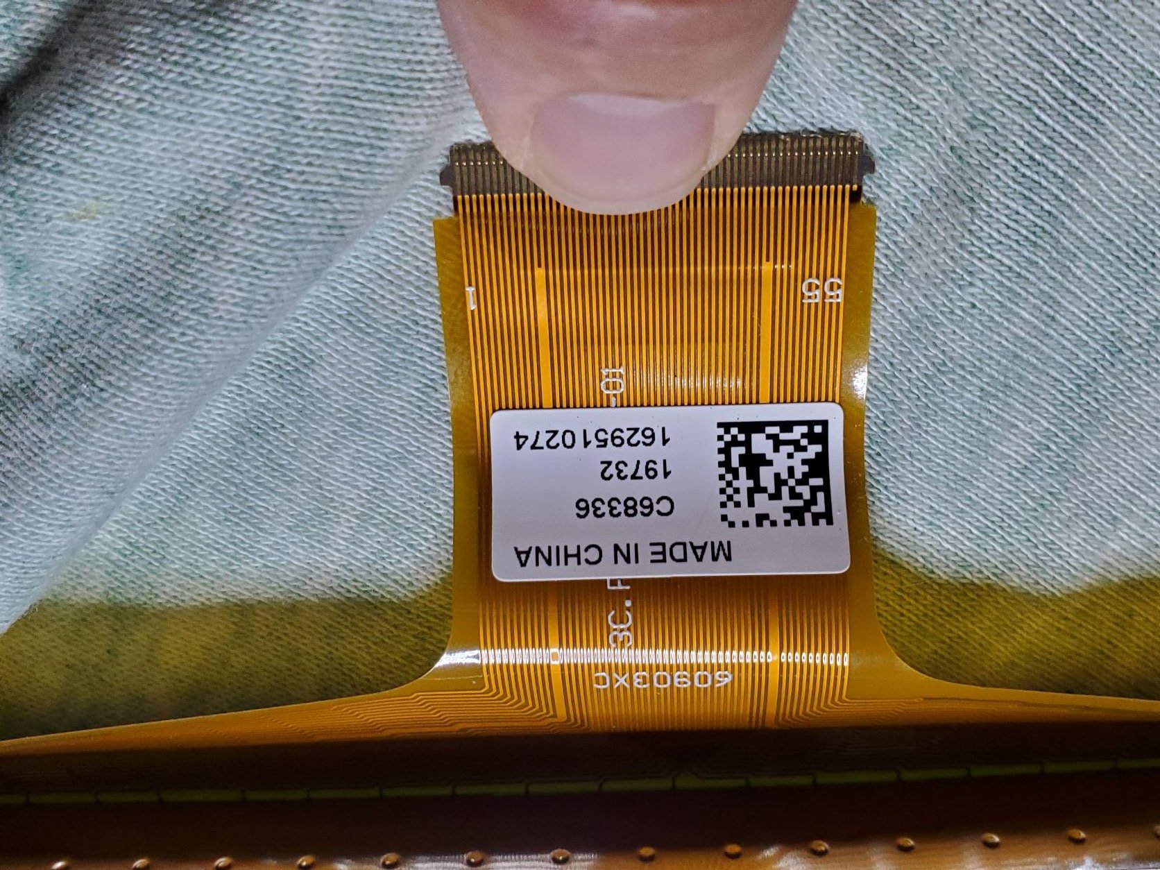

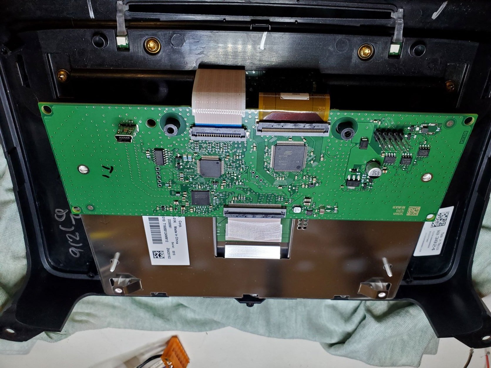

  2. Same problem with my 2017 Silverado LT with 8" screen. Random beeps, radio stations would randomly scroll, screen would lock up and not function etc. I disconnected the digitizer ribbon cable and the random beeping problem went away. Radio functionality is available thru the knobs but a bit cumbersome to use. (thanks to Wyatt1963 for the idea) I found a digitizer on ebay for $68. The price has since dropped. Replacement was relatively simple. Removing the old digitizer was a bit time consuming; I used a razor blade to separate it from the frame. I have about 20 hours on so on the new digitizer with not one problem. I just checked ebay. $48. https://www.ebay.com/itm/314091027125 (quick note: the sticky foam was on the wrong side. I had to carefully remove it then install on the correct side. the seller is aware of the issue) Here are a few pictures showing the original digitizer part numbers, the black lcd screen with digitizer and frame separated from each other and the whole assembly when first removed.
