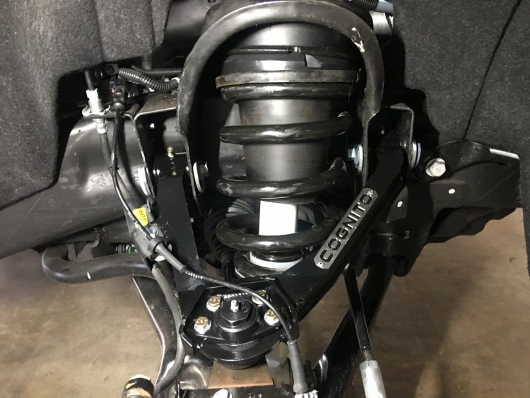

  2. What wheels and tires do you have now? I was looking at those upper control arms and found out that you have to run wheels with a certain back spacing to work with those control arms. I ended up going with cognito control arms

  4. Installed my motofab 2.5" kit and cognito UCAs today. Love the look, now just gotta find wheels and tires.
