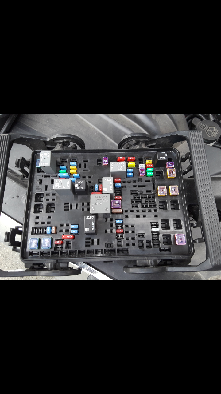

  3. Two fuse block tops compared. Relays circled. One is for a second fuel pump and the others are for aux. Fuses pertaining to aux are there but not identified. You can tell from comparing though.

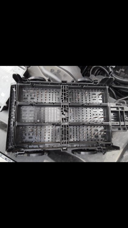

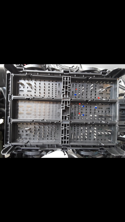

  4. Pictures of new and old Underhood fuse block. On the new block, red indicates trigger wire, or wire that will go from junction connector to red marks. Blue marks are the output power to whatever you want to be powered. Blue is big *Wire and red gets small *Wire. Do your due diligence and ensure they are correct! I do not remember 100% if these were the ones I used but I do believe I did. But again, test to ensure.

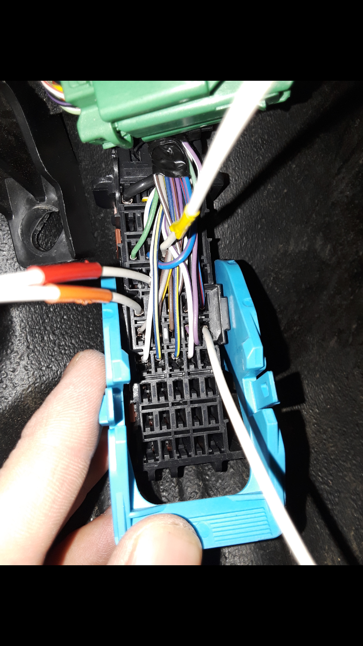

  6. Inside driver junction connector by brake pedal. Bottom right connector. Be careful because there are multiple yellow/white and white/blue. I don't remember exactly if there are other multiples but test continuity from the wire to the wire behind the AUX switch. Then test continuity from front of junction box to rear of junction box.
