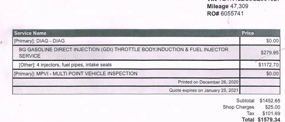

  1. Hi All, At 46,032 miles the check engine light came on. Took to my usual service center. They did a fuel injector flush service and this remedied the problem for a few days. Light comes back on, same error. I ran a tank of premium fuel through the engine - light goes off. At 47,300 miles the check engine light is back on. Checked the code = P050D X2. Took to the local GMC dealer - "Performed fuel injector balance test. All bank 1 injectors low". Repair estimate attached. Is this common for 4 injectors to go bad simultaneously on one bank? Or can there be another problem? The truck has a 5.3 engine. Per the service manager this is not covered under any warranties. The truck runs fine- quick start and no discernable hesitations or unusual engine noises. Any direction on a remedy would be greatly appreciated. Regards, John
