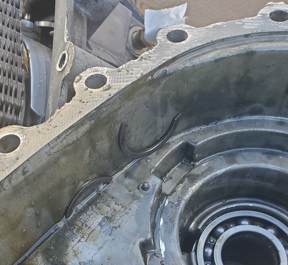

  1. Sorry, don't check this forum much but I did find the cause. The snap ring in the transfer case broke. Let the gear move back and forth. Snap ring was $6 but quite a bit of time to remove and reseal. I guess this is a common problem 2nd to the pump rub, and I heard some later years they hardened the snap ring. Here are some pictures.
