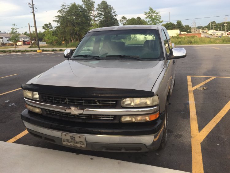

  3. You guys may get a laugh at this one.... I called a mechanic I normally use for a quote on the replacement. $5800 for a Jasper. High, probably close to VERY high, but okay. But then he mentions that Jasper also sells a "Triple Play" kit that is the engine, transmission, and rear diff. For $12,000. On a 22 year old truck. Yeah, no thanks. It's looking more and more like this will be a DIY job for me. I'm looking at rebuilt engines and have found a few options. I'm liking the offerings from ATK (through Jegs), Gearhead and S and J Engines.

  6. I think there are a couple of issues at play here - is it worth it to fix it. Interesting question on two levels. I've stated my mathematical equation (used the same one when spending $900 to fix the AC on my Honda Civic, and it's still going 3 years later). However, the second factor is - do you need to fix it or will it hurt anything? It sounds like, IF yours has this issue, it may not even be worth worrying about. You can a) drive it and not worry about it, b) drive it and when it does let go, plan to replace the engine, or c) fix it now with either new heads or an engine. I'm somewhere between b and c. You might be at a. If the truck is in good shape otherwise, I think mathematically it makes sense to fix vs replace. I'm thinking I might pull the oil sensor and see if there is any sludge in that area or - if I can access it - the oil pickup. If so, that's an automatic engine replacement. If there isn't, it might be worth a gamble to replace the heads. And even if the engine then blows, I can probably either re-use the heads or sell them. Or have the bottom end rebuilt and use them again. Questions, questions. Lots to think about. If I pay for the work to be done, I'm replacing the whole engine. I think the labor for replacing heads is about the same as the labor to replace the whole engine. If I just do it myself, then I might chance just the heads. Upside is I can get the heads that I want (706 heads). Just have to be careful not to push the engine too hard for a while after that.
  7. Funny bit - I snooped around Ebay for engines and even the ones with >150K miles are going for over $1000. I know Ebay isn't the best place to get an engine, but I was shocked at that.
  8. My family had four cars with the 2.8L and 3.1L engines. 1986 Camaro 1990 Lumina Euro 1996 Grand Am 2002 Malibu Three had this issue, and the one that I never found it on (the Lumina) probably had it too. My understanding is that GM never fixed it, even though Fel-Pro (I think) actually developed an improved gasket that would solve the problem. The Camaro blew up as a result (we caught the issue too late), the Grand Am (my parents' car) was traded on a Honda, and the Malibu was traded....on a Honda.
