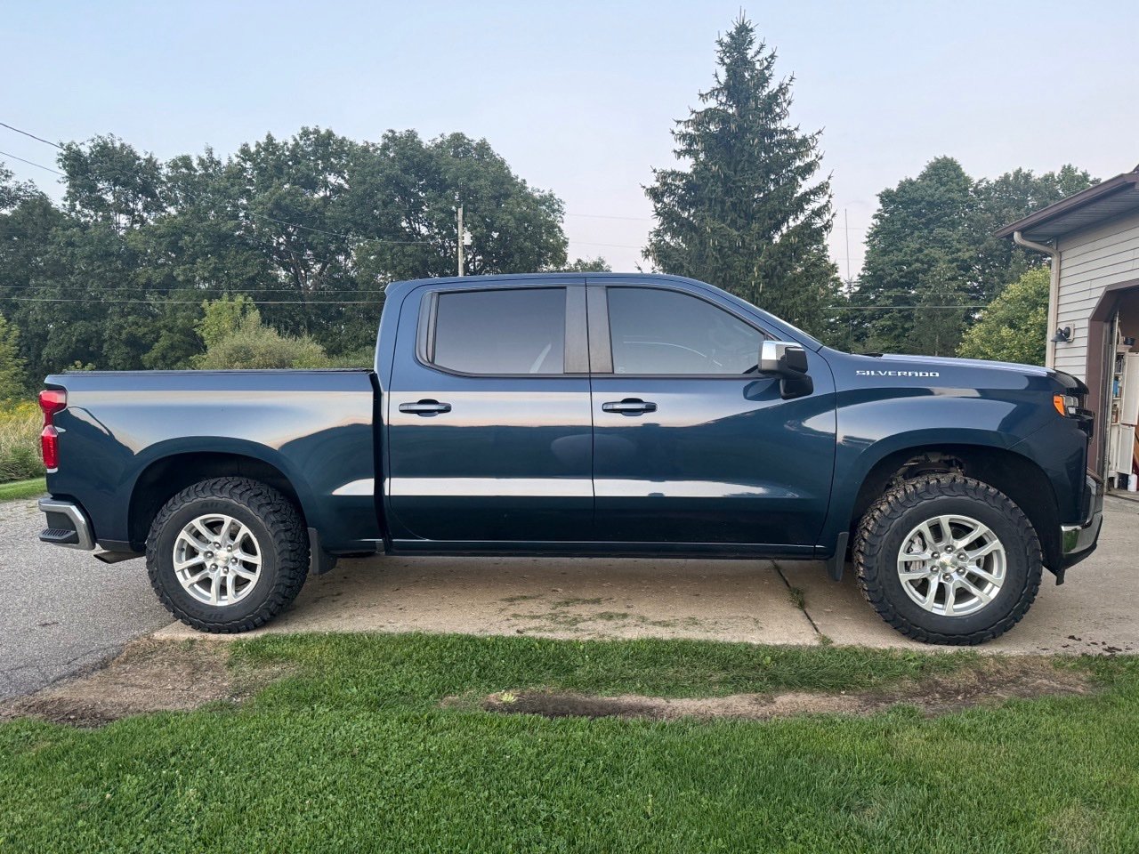

  1. 1 inch motofab level for the mean time but Plan on getting OME mt64 front shocks if they ever come out or possibly will order the ebiach pro 2.0 on Black Friday. I had fox 2.0s on my 2016 but I want to try something different. 275 70 r18 BfG KO3 on stock 18” wheels I had a hard time finding photos of this combo on stock wheels so I figured I’d share.
