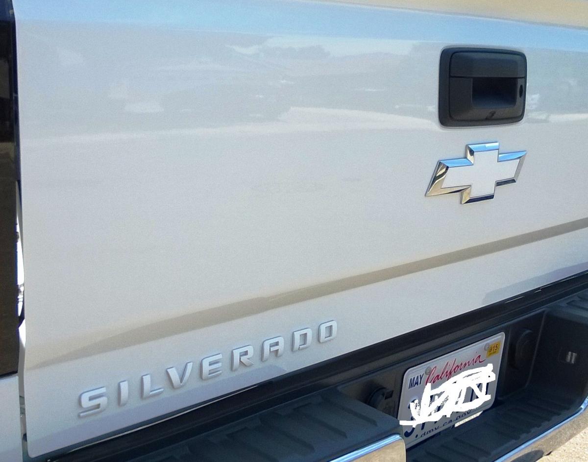

  2. I will call it Vanilla Ice 2014 Silverado LT Custom Sport 4x4 LTZ chrome skid plate High Country chrome fog light bezels Color matched grill and trim Cleared headlights Switchback LED turn signals: http://instagram.com/p/qImnBoIPLG/ White emblems 2.5 inch front lift 275/60R20 Coopers All that's left is the chrome Chevy emblem on the grille, then I'm calling it quits until some more LED tailights come out.

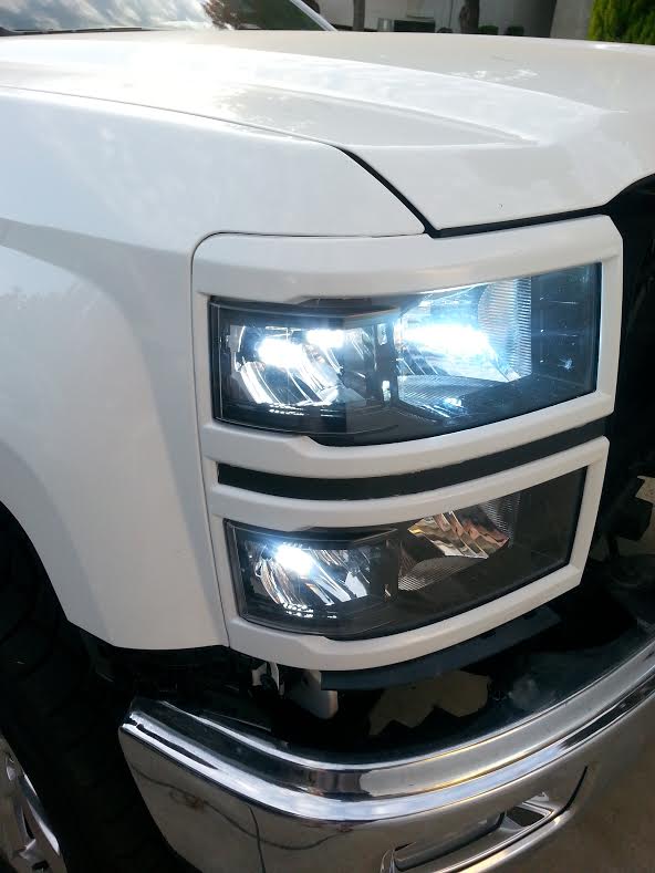

  4. Cleared the headlights, painted the trim, 6000k (need to swap for 5000k) HID low beams, and switchback LEDs. Loving it.

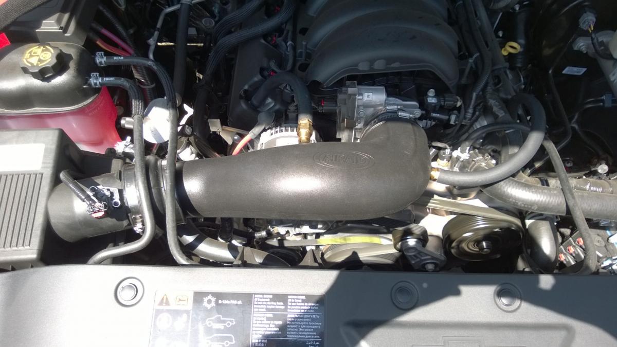

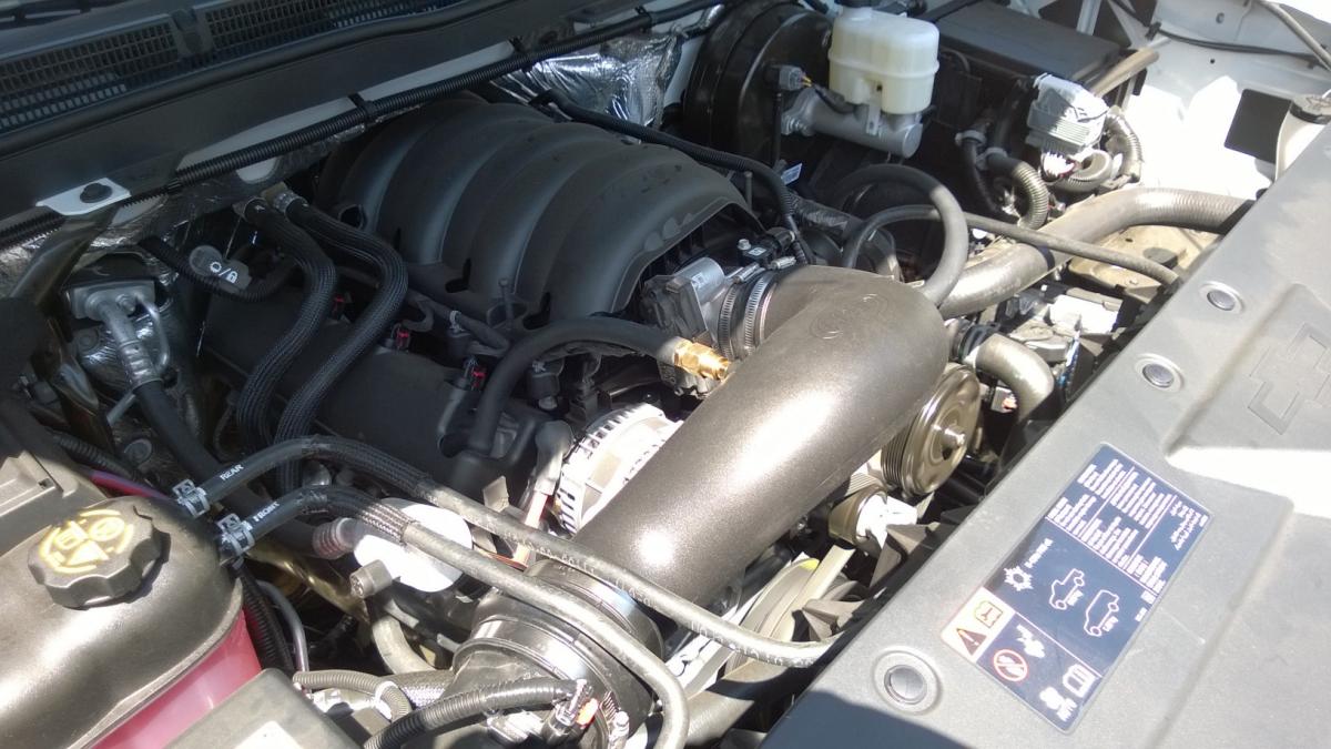

  5. Installed the AIRAID intake tube. Part#200-996 for the 5.3L. Comes with a CARB sticker. Best price I could find was here: http://www.ecrater.com/p/5137942/chevrolet-suburban-48l53l60l-2007-08-airaid-modular List of extras I needed to purchase to make it work on my 2014 Silverado: 5' of 5/8" Heater Hose 1/2"NPT Male x 5/8" Hose barb Fitting QTY:2 1/4"NPT Male x 1/2"NPT Male QTY:1 1/2"NPT Female x 1/2"NPT Female Coupling QTY:1 Had to drill and tap a 1/2"NPT Hole into the tube in order to accommodate the drivers side breather hose from the valve cover. Easy to do if you have the tap. Sealed the fitting with some silicone for peace of mind. Definitely an increase in sound, but only with heavy acceleration. Very enjoyable. Thanks to those who did this before me. Really motivated me to purchase. Pics:
