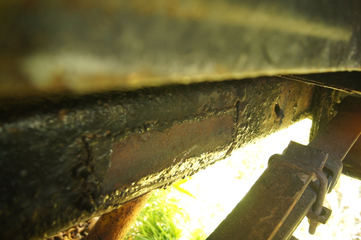

a serious little weld. With high miles is some unusual finds.. the a/c hose dripped in the same spot so long, it worked away a perfectly waterfall driven shape. now at 391k miles.. my photos from a cellphone are ridiculous, so I added a photo with my hand and the template of the weld below. As you can see, it is not exactly huge. My hands are large, I digress. I was inspired to fix this, when 7 years ago, I noticed my inspector was always checking up front, right where weld is..every year. No problems with it back then. I asked him if that was a trouble spot and he said.. that spot is the only bizarre frame breakage in these models he had ever seen. I have concluded myself it must be a/c related for an unlucky truck. If one of the evaporators leaks it will use the drain hole to outside for r134a.. into this frame area. Mine was lucky for 27 years... it is just time and water. Welded up nicely..passed my hammer test. A new fuel tank crossmember in coming days. that is a no weld job..full bolt conversion...and some weld details to complete. by september a new exhaust muffler back to factory, and super quiet. On the manual trans truck, I like to hear the engine to know when to shift.. so I may wander off from factory one more time.

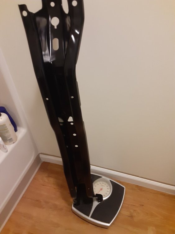

I got that beam in the mail, and remembered I had a journal here. love truck to this day. I found a way to keep it to 1k miles or less per year... just a special vehicle to me now no more rock salt etc.
hi. still trucking. thought I'd check in after 3.5 years. still primary vehicle. now at 390,683 miles. state inspected. Has not needed much. My welds are extras. I made the frame much stronger, and just got in the mail a brand new fuel tank crossmember. 88 bucks delivered. Bargain! I wanted to specifically share this as I had a questions few years ago about the original. "it seems like the fuel tank crossmember is not meant for the weight of this truck" sure enough, the new one weighs 18.8 pounds and has 13mm rivet holes. I had an original that was not as heavy duty as the new one...it even has 10mm rivet holes. I had guessed it a long time ago. I have been under many of these trucks over the years.. and simply noticed my crossmember specifically was very wimpy. I even found short bed step sides with thicker crossmember than what this one shipped with. Factory mystery. Was not my imagination, after all... so.. am converting the last bits with rivets left, over to 13mm bolts... adding new member. this is approaching finale , after 8 years...and may even semi retire it.. running beautiful. Everything works...rust repairs all done.
I see maine in there. it is never the top ten of much. it is also a place that breaks 5 yr old anything. A most amazing trend has emerged with the 88-98. I have never seen anything like it. I moved here in 1987. I am finding welding on framing is getting to be much more relaxed. steel issues are looked at twice rather than scrapping over a dented rocker panel. So many places got spoiled apparently back in the day. people hang onto their stuff longer than I have never seen...especially the 4x4

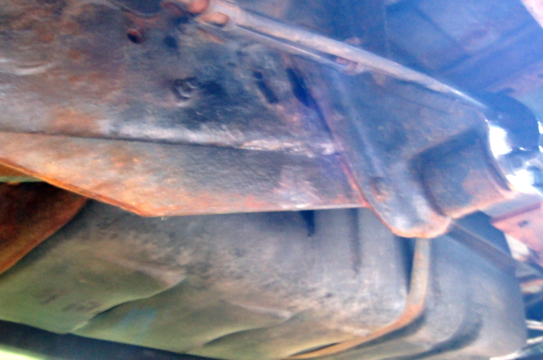

one more weld I heard a squeak, unusual place. This truck is abrick.. a squeak is something moving. So I started smashing and poking at the rear left tail near hanger.. the only area that has had just one plate, and nothing more. sure enough, I took out a whole section near the hanger. added new plate. this may have been the longest weld yet.. I noticed 5 hours went by. almost 2 more pounds of wire, 18 inches of plate. Also added welds to the ugly hangers bottom .. its like adding two more rivets. I have two new hangers, and am in no hurry. I am keeping full tow ability. I take my time. fixed the old tailgate hinges, now I just slam it like an old barn door. I can also use it as a tail end reference. squared up heading into another winter. odometer fast approaching 380k 5th full year in the coming january gained 38k miles since feb 2015. drivetrain has needed nothing. Running very strong.
my scariest weld yet to the left of gas tank. Judging how local it stayed, it appears one of the lines in years past must have broke and got fixed right away. This area left to even a vent tube would have a frame shattered into a pile of rubble by now. the yellow is where i welded the plate from the outside,it is the height of frame, and 3 inches wide. the bottom is angle iron I put in a couple of years ago. Not a scary weld to me, but for those that don't know what maine does. this injury stayed local, I was fortunate. I poked a golf ball sized hole last winter, while inspecting (I tend to do that twice a year - the truck is that old to me) I waited until july to cut out the shape I wanted for the plate. Again nothing to notice going down road or hauling.. this frame is some kinda wonderful. I am at nearly 6 pounds of mig wire, weight of steel unknown. Flat stock, angle, cross sills, box beam etc. It is sure to be near 100 pounds rebuilding the back end. The hellwigs keep this old heavy weight (and getting fatter) level and raked nicely. this will stay like this through next years May inspection, then I attack again for summer. you see, the weld date I use is gone past.. it is already getting too cool at night. this risks a break when the whole chore can't stay with the whole frame. I learned this weirdness local years ago. From here on out, welding can be lightweight stuff, like panels, or removable items. The frame is very serious to me...casually so. I make it look easy.

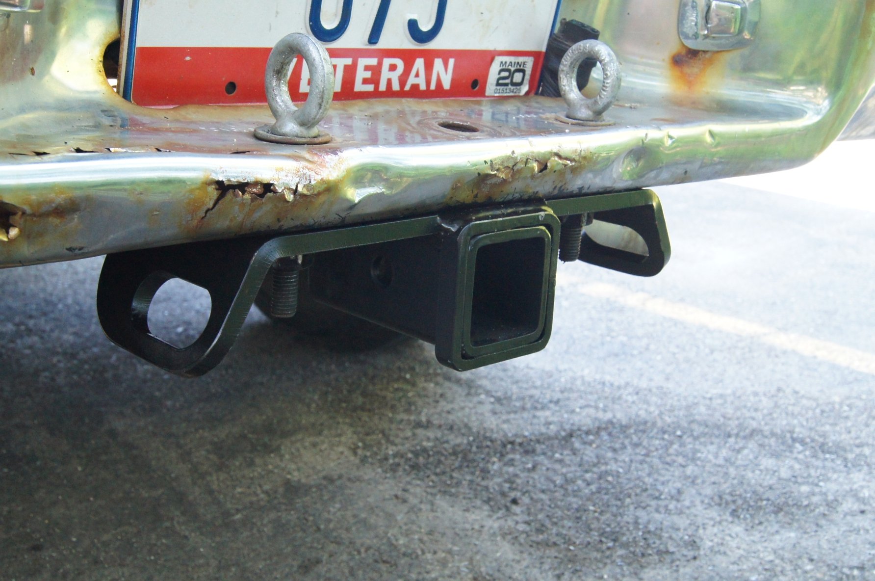

Wanting to drop hitch, as tails are welded to a very old receiver mishap. That gave this truck an easy life. the inspiration to utilize bumper as half of the 7500 came after tuigging at dad's peterbilt on ice. This is one hardened old half ton. found this on ebay. its purpose is exactly what I want. Good for half ton limits.. and my version of dispersal is the other half of the load. Bolted it up today with whatever hardware to map welding. Will have four grade 8s going through the factory ball deck. welding this seam as well. It was cheap enough to not suffer a loss if bumper needs a swap some day will share when it is done. the decision was the 900 pound helpers and big ubolts. It was dragging the boats license plate.. ball hitch too tall after levelling truck. using old tire crossmember laminated as 2 of the end points. Between you and I ... it is more than a half ton capable, but am going by model number and towing laws for the category. just well done.. .that is all.

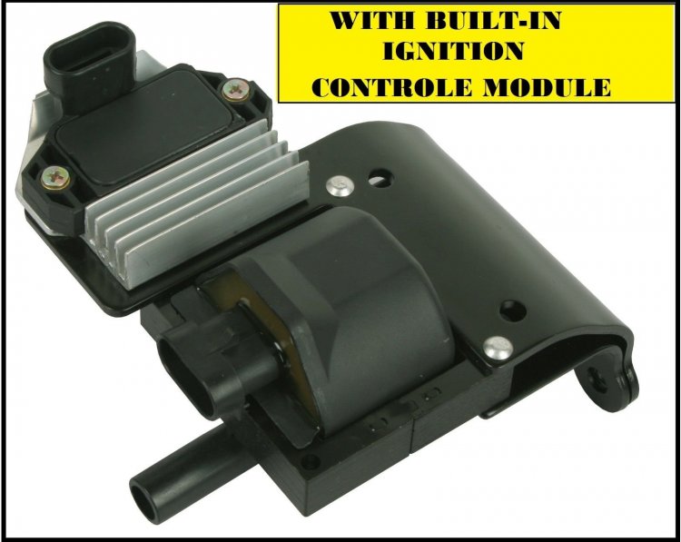

coil and module with the the past 3 years, my first ignition trouble was cheap wires in the maine fog. this got a swap to 8.8mm zero bleed accel custom equal length a year later I found the platinum original plugs at .080 and still running strong and clean. I then swapped to iridiums recommended for this truck. a broken ground for who knows how long lead me to anew starter eventually. My bro-n-law swapped out the plugs to LS 5.3 I finally found the ground, and made it hefty and sheathed. Yet the 25th ice and frigid combo bouncing back and forth, I got a goofy start this morning.. my maintenance manager for the building casually mentioned the coil after a goofy start. It does start now at all times.. that is a good direction. No more no start condition. I then figured it out... the module or igniter has been through hell and back, and still coming to life. my subaru broke coils just to replace a cap or rotor or plugs.. anyhting to do with ignition, coil used to fail. the setup above is claimed to be for commercial, industrial.. could be ad hoax.. but gm stuff normally doesn't play around like that. edit: I summarized how tough that little module is on the side of the coil..not to mention a tough coil. Being it had a brain before it.. I give the module credit. This is still working full power mind you.. the february sun is bringing it right back out. coil and heatsink and module is painted covering rust (it is indeed old) alternator met a violent end a year or two ago. map sensor pegged timing to 38 degrees just off throttle.. this is a hard snap for ignition it then survived a new map sensor, new gentle curve.. 2 degrees more retarded at idle. smooth sailing plug wires were so bad, 5 and 7 zapped to each other.. I added brand new accel zero bleed, equal length. 3 different sets of plugs broken engine ground. the disty for sure uses that one.. not sure where module uses its ground. Might be same spot I have never had a machine survive this weather pattern we are in. Ever. Here i am hacking away at a 21 yr old runtime..hardly bothers it. I am impressed. I am glad to have learned all 23 of my vehicles before this one, to realize how damn good it is. I went an ordered all new coil/module/heatsink altogether as one. The setup was old enough where a previous owner painted everything black, including heatsink. From there.. I may swap crank position sensor just for the sake of doing so. No engine ground at all for more than a year.. I am guessing other items may catch up. I am truly impressed with how much wet and frozen cycles into the coldest spot in the lower 48..many times.

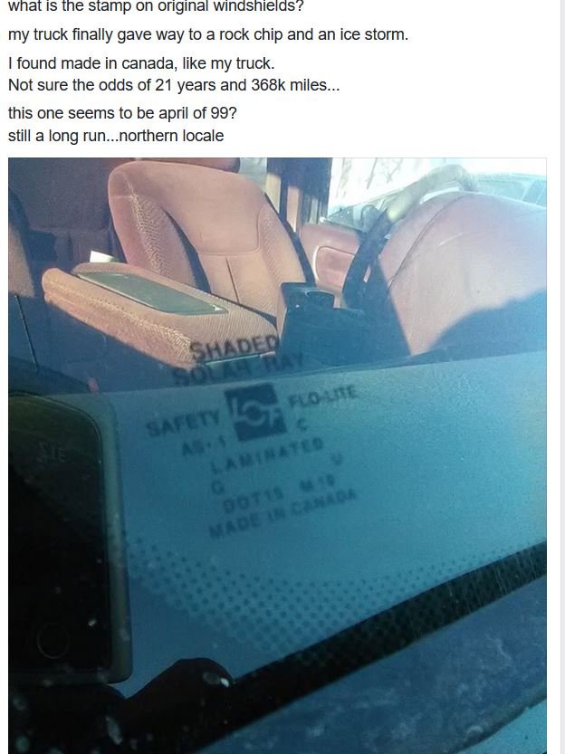

I always doubt windshield swaps, unless factory.. I found something interesting. Even the old glass is outdated.(I am sure of it) I got brand new fuyao brand. my safelite review.. ice, arctic, rain 40s, F frozen again, now 12F and 12 inches of snow. in one week we have had a worlds weather...one spot, called maine. I judge thickness of new glass at the wipers outside and my finger inside behind them. this seems beefier than what was already damn good. no wavy side views, no egg like magnifying. the last clues something is better.. induction noise with lid popped up on air cleaner, and my flowmaster. it changed sound to less decibels. ..and to think my neighbor used to sleep on our nascar run to the V.A. hospital appts already. I get into my dads 2016, and look at the corner of glass for the brand same as mine. FUYAO. lo and behold, safelite isn't flunking like a corvette forum full of bitches might declare. this review is for real results. I know they can't mess with truck glass anyway, they got work to do, and windshields are always a part of structure strength. anyway.. I'd do it again for sure. I am guessing some kind of computer guidance and chemistry would be the changes. It is right on as of now.. and will only settle to even better. Being a steel nut, I am glad to have new glass, my welding got these old two rails straight as can be. New glass allows it to dial in even more.
windshield installed. -12F in lagrange maine for my cold start.. I checked safelite website, they allowed a delay to 2 pm. bangor maine was going to be 13F by then. the repair guy scrubbed 2 small rust spots under the 18 year old glass, gave it 2 coats of primer.. and complimented the condition. We got to talking, he is also looking for a gmt400.. less gadgets, and the first years of real injection. I was proud to bring this one in to their shop. not trusting the time allowance for glass to seat, now at 8F this evening already.. I let it sit and idle hot defrost to allow more seat time. ice and rain storm tomorrow...again. I also got free full trim, the glass edge and the side pieces at the door. $185. all that stuff was 18 years old. This means 250-300k miles. impressive. You don't know how bad the old glass is , until you look through some brand new sometimes. analogy to evolution.. anyway. the new ground followup.. cold starts back to the reason I love this truck, it is on its way. Now just pretending it will get through another ice storm with no problems... I am sure it will. The safelite guys seemed confident, and told me of the warranty.

new windshield $185 not bad. it started off at $233.. could not quite understand what the other end of the fuzzy line was saying. Down to $185. I also learned in maine, safelite changed 122 windshields for my model of truck in just one year. the newest one is 20 years old. I find that amazing. The glass was so old in my truck, welding, years, chips, the general grinding fuzz of sand..24 below to 145F cabin in the 90F sun... I wanted new before the rock chip gave way to a 31F ice storm and hot defrost anyway. it went on for a long day..31F and rain... extremely heavy. no complaints. The last windshield i broke was in 1994, a 74 chevelle.... an ice storm and defrost taking over. strange? hardly a coincidence. I found the glass is an original oem piece..but dated april of 1999. still a long run for my locale.
