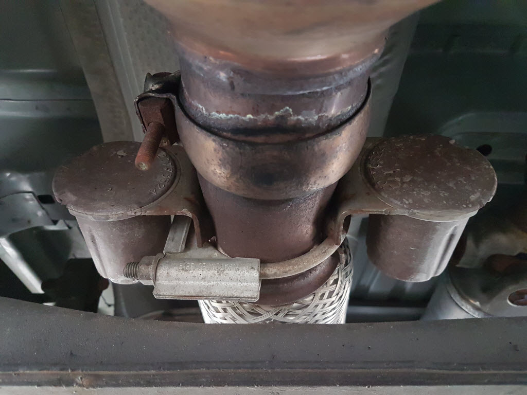

The booming definitely wasn't tire related for me - that was fixed on a separate trip. Welding the dampers on the exhaust 100% solved the booming that I heard when the rear wheels went over bumps [including snow] at low speeds. It sounded like somebody was flicking a large subwoofer. Somewhere in this thread, I included pictures and measurements on where they were placed. The buffeting issue was fixed by road-force balancing my stock 20" tires to be 10lbs or better as per GM specifications. They resolved it *after* the fixed the booming issue and it took them 6 tire replacements to make it happen! -- Marc -

I didn't get the Borla, but my 'booming' over bumps was eliminated by clamping weights/dampers on the exhaust. I included pictures further back in this thread if anyone is interested in quantity and placement. The buffeting was a result of tires. It took 6 Continental replacements to get them quiet [under 10lbs] and I had them re-road force balanced when I putting them back on for the summer. The Continentals have a tendency to flat spot which temporarily re-introduces buffeting. I'm going to put up with them a little while longer and replace them with some Michelins for summer duty. My BFG KO2s are awesome and don't introduce any buffeting. That's probably why I left them on until August! If it wasn't for the fuel economy penalty [they are 14lbs heavier per tire!], I'd leave them on year round. The vibrating was fixed by replace the rear end. I've been enjoying my Yukon ever since and only experienced a failed wheel bearing since. While the root cause of the issue may never be fixed or identified on these models, I'm OK knowing that I can control the inputs [shitty or out of balance tires]. -

SierraMyst, My travels don't take me that far east in VA, so I parked my Yukon on a curb and crawled under this afternoon. I was mistaken - there are only 4 dampers. From front to back, they are: a pair of dampers close to the crossmember, before the braided section a single damper right after the braided section before the muffler/resonator a single damper approximately 11" before the other muffler/resonator Here are some more pics, in the same order as above. Hope it helps. -- Marc -

Correct. For me... Booming (yes, over snow, gravel and other bumps) was fixed with exhaust dampers. Buffeting was fixed by getting tires RF balanced to 12lbs or better. Vibrating was fixed by replacing the rear axle. I've put ~20,000 enjoyable kilometers on since all 3 were fixed. The buffeting started to creep back in fall and disappeared when I put my winter shoes on. I'm going to have the stock Continentals RF balanced (again) in the spring before I put them back on. If they're out of line, I'll get a set of Michelins or might just leave the Ko2's on all year as they've been great even though they're 15lbs heavier per tire than the Continentals. -

5 dampers mounted with 4 u-bolts. -- Marc -

If you look at the second picture that I linked to above (of my dampers), it looks like they put 2 dampers on one u-bolt. This was the only such one that I could see. The rest are 1:1. -

I posted pictures back in August. You can find them here. I'm happy to see this solution work for others! -
