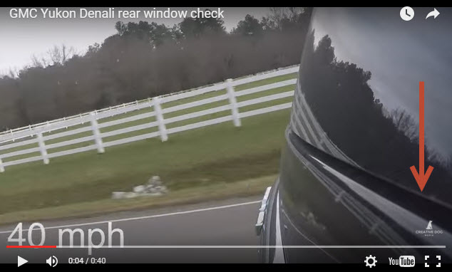

@Yahtzee: Thank you for taking the time to record, edit and publish this! @everyone: I might be seeing something that isn't there, but does anyone see small movement of the glass? Watch the edge. -

I wouldn't consider it a safety issue either, at least in my case. It's just annoying as hell. I don't enjoy driving my Yukon because of the buffeting. I wish I could park a buffeting version and a quiet version side by side and compare them. This must be a solvable problem! Does anyone know how to measure vibration/movement of the hatch while the car is moving at 40mph and 70mph? Chaser car with a good camera? ;) GoPro suction cup? -
