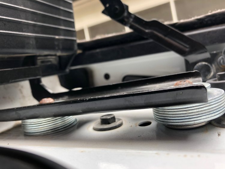

I used Polk DB522, but you can use really any speakers up to 5.25” (max size). The step clears and closes fine without the speaker grills, but I liked the look and protection with the grills. I have since painted the washers black and it looks fine, only noticeable if you’re looking for it. Photo attached of step closed, with grills on and washers/spacers in place -

The step easily closes without the speaker grills, but I wanted the grills on so i stacked some fender washers in under the step and grabbed some longer screws from Lowe's. -

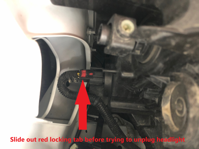

Mine is a 2019. The lighted emblem (GM Part # 84741557) works for both 2019 & 2020 year models. Personally confirmed. Yes, basically the harness has a dual ended pigtail... Unplug headlight, plug in one end of the pigtail into the headlight plug, then plug the end you removed from the headlight into the other end of the pigtail. Super simple. Here are a couple of photos of it at night (not mine)

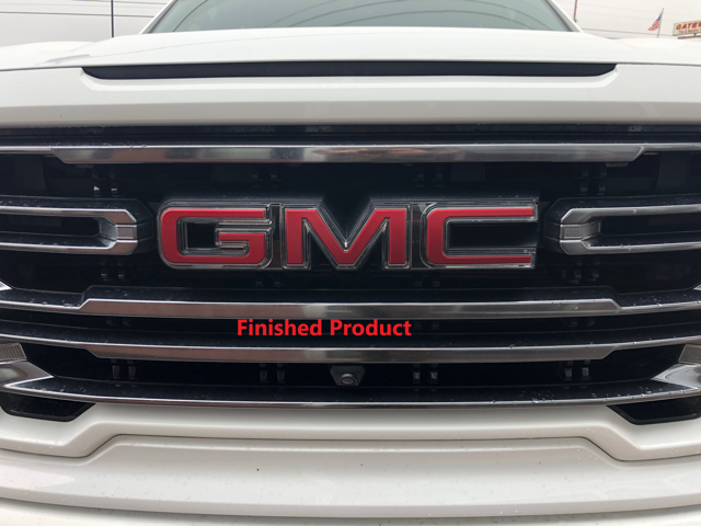

Just did the install. Took about 15-20 minutes. A few tips: 1. I would recommend routing the wire BEFORE installing the emblem. Would make plugging the pigtail into the emblem much easier! 2. Also, no need to remove the grill or headlights, everything is easily accessible by just removing the black cover between the grill and radiator (10 or so black "push-clips"). 3. Be sure to route the wire over and then in front of the grill shutters, not between the grill shutter fins/blades). See photos of how i routed the wire and one photo of finished product. It is not very bright at all in the daytime, Assuming it will be much brighter at night.
