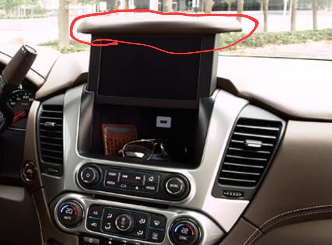

  5. Here is the pic of what I am looking for
  6. Hello, I am trying to order a replacement trim piece for my wife's 19 suburban. It is the small trim piece that sits on top of the display. Picture below of what i need except in black. I cant seem to find a schematic showing that part. Does any know what the part number is Thank you
